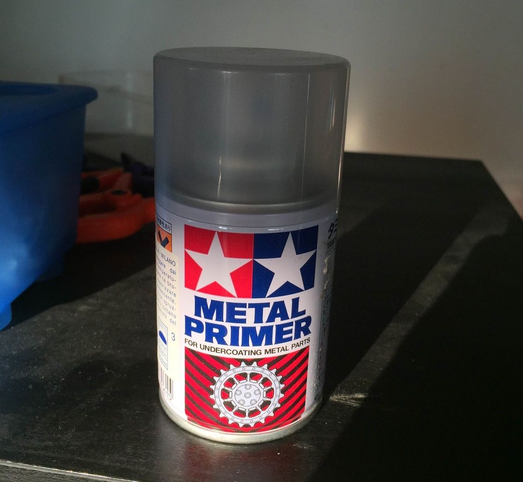

Sasho, please tell me what you are using to thin the Mr. Metal Primer? I was told to use white spirits and did so...and ended up with a cup full of what looked a lot like, well, snot.

It seems that I use the Tamiya version and not Mr Color version....excuse me for the confusion! I use the rattle can version, so there is no need to thin it, but the thing smells heavily like a enamel, so I suppose enamel based thinners would do the job. Have you tried Mr. Paint thinner or Mr. Leveling Thinner? The last one is my personal favorite, I dilute nearly everything with it - metalizers, enamels, acrylics etc. The only paint that doesn't work with it so far are Valejo's acrylics! On another hand I always use primers in Rattle cans as they(primers) are hard to clean from the airbrush and the cans are covering large areas better than the airbrush with its tiny nozzle:)

OK....Out of a rattle can, no thinning necessary! LOL!!
I am having a hard time getting info on Mr. Metal Primer....weird that it should be so tough to find. But I will persevere.

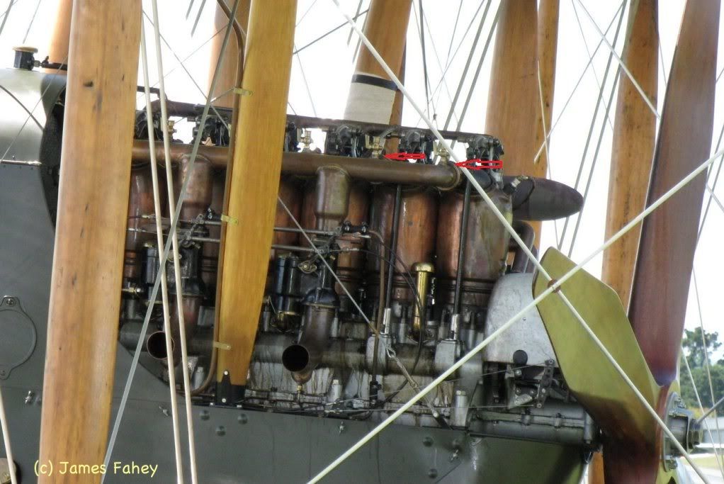

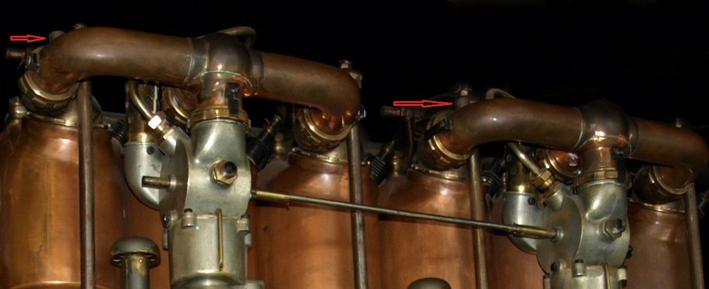

I think I come to a conclusion regarding the priming cups - when you pay special attention on the 160HP version manifold and the picture of the 120hp engine from wikipedia, it is visible that the places for the priming cups are there, but the priming cups themselves are removed, so I will be using them :) Here are the pictures with some pointers:
Many thanks to James Fahey

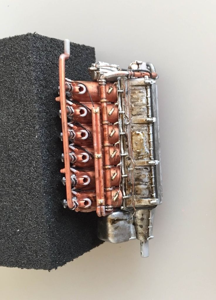

I revoke my words from yesterday regarding those priming cups - from the archive photos on WnW website, it is clearly visible, that at least 6341 at the time of capture by the Germans, doesn't had them (erm..did I used the English tense right in the previous sentence? Probbaly not, but how shoul it be formulated?). On another hand, every picture of different engine I see, shows some minor differencies with the rest. Probably some 120hp engines had them, some doesn't. For me the important thing is that my particular Fe.2b was without them.
Yesterday I was working on staining the engine and maybe I got a little too far, but as can be seen by pictures, those engines were leaking heavilly so it is not that far from the original and it works for me! I changed the pushing rods with 0,5mm brass rods, that were chemically blackened. The original plastic was 0,7mm and too thick I think. I also added the spark wires and I'm moving to the manifold now.
Any comemnts, quations, reccomendations or constructive criticism are most welcome!

Lovely beardmore, Sasho! I think your weathering is just right.
As for the priming cups, I scratch build them for my Late 160hp version inspired by a footage someone linked in this or another forum of TVAL FE2b being started. There was a service person filling the cups. But if I were you, I would stick to the photos of your example.
