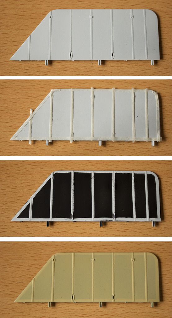

« Reply #53 on: October 01, 2015, 10:29:33 PM »
Hi!
While I'm preparing the fuselage for painting I've tried a new method to paint the clear linen surfaces.
On my FE2b I've prayed a base coat of linen paint, then I've masked all the ribs and sprayed a slighlty darkned base color to give the illusion of transparencies.
It worked well, but it was impossible to judge the the contrast between the 2 shades before removing the masking, so often I had to correct the effect overspraying some base color to tone down the contrast.
This time I've done this:
1) I sprayed a white base
2) I've masked the ribs and structure details
3) I've sprayed black paint
4) Finally I've sprayed the linen color, in light passes, to achieve the correct contrast
I'm satisfied and I think that I'll use this technique and all the wings surfaces
Andrew

Offline AndrewS
  • Posts: 241
Re: 1/32 WnW Felixstowe f2a late
« Reply #58 on: October 02, 2015, 05:48:06 PM »
That is a very effective technique you used for the shading Andrew, it looks really good.
Thanks!
Just to be clear: I've not invented the technique, I've simply copied a technique I've seen used on armor models, where the model is first painted in black and white
and then light coats of color are airbrushed over until you reach the desired effect.
I thought that could be used for the canvas effect and I've tried  ;)
Andrew

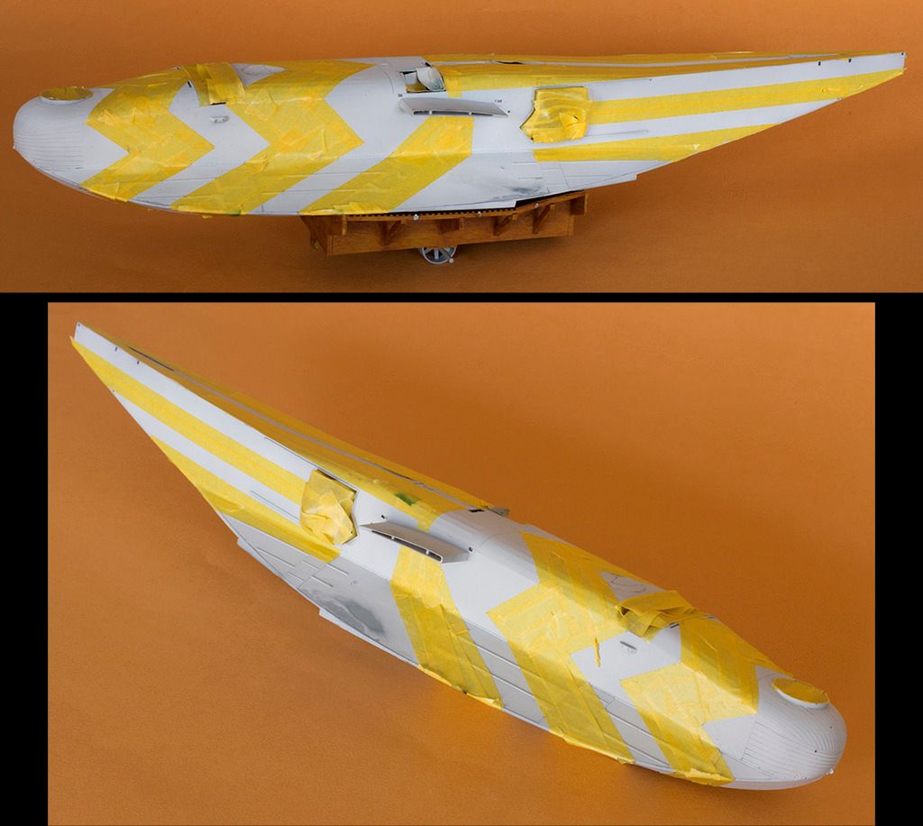

« Reply #59 on: October 12, 2015, 06:46:14 PM »
Hi!
I've painted the white base (tamiya white with some balck and brown to tone it down).
The I've masked for sprazing the red. Quite tricky...with only 1 picture of the real aircraft and 1 profile it was not easy  ::)
I'm looking forward to see the scheme complete  :D
Andrew
