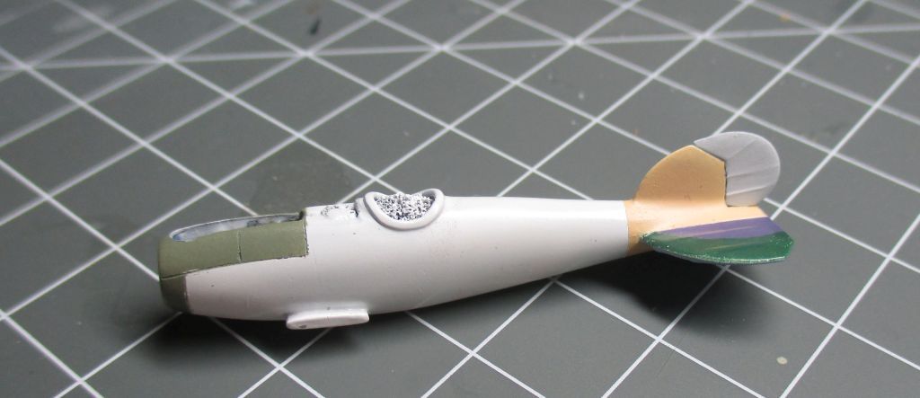

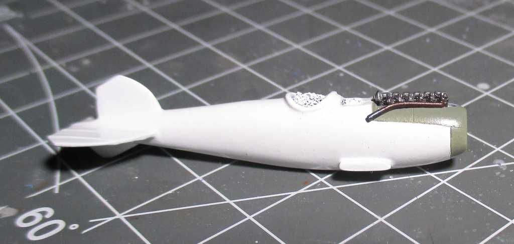

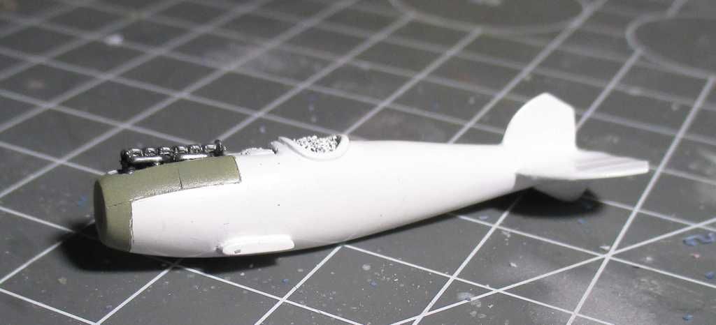

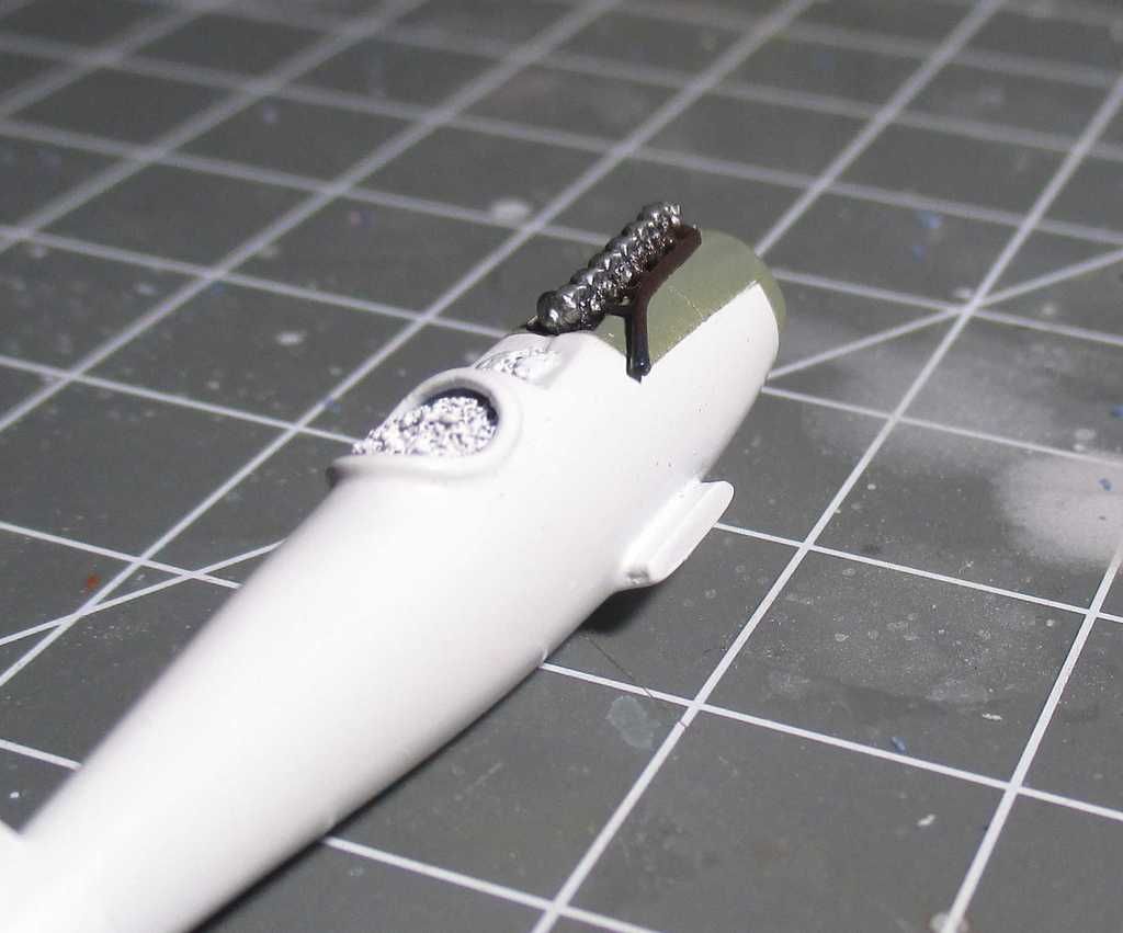

Some progress on the fuselage, it is almost ready for painting, I already applied the greyish green using the DB paints. The zinc white has very good covering, which is why the fuselage was really difficult to photograph - the white is too shiny.  :) Another consequence is that the greyish green appears rather dark on the photos.

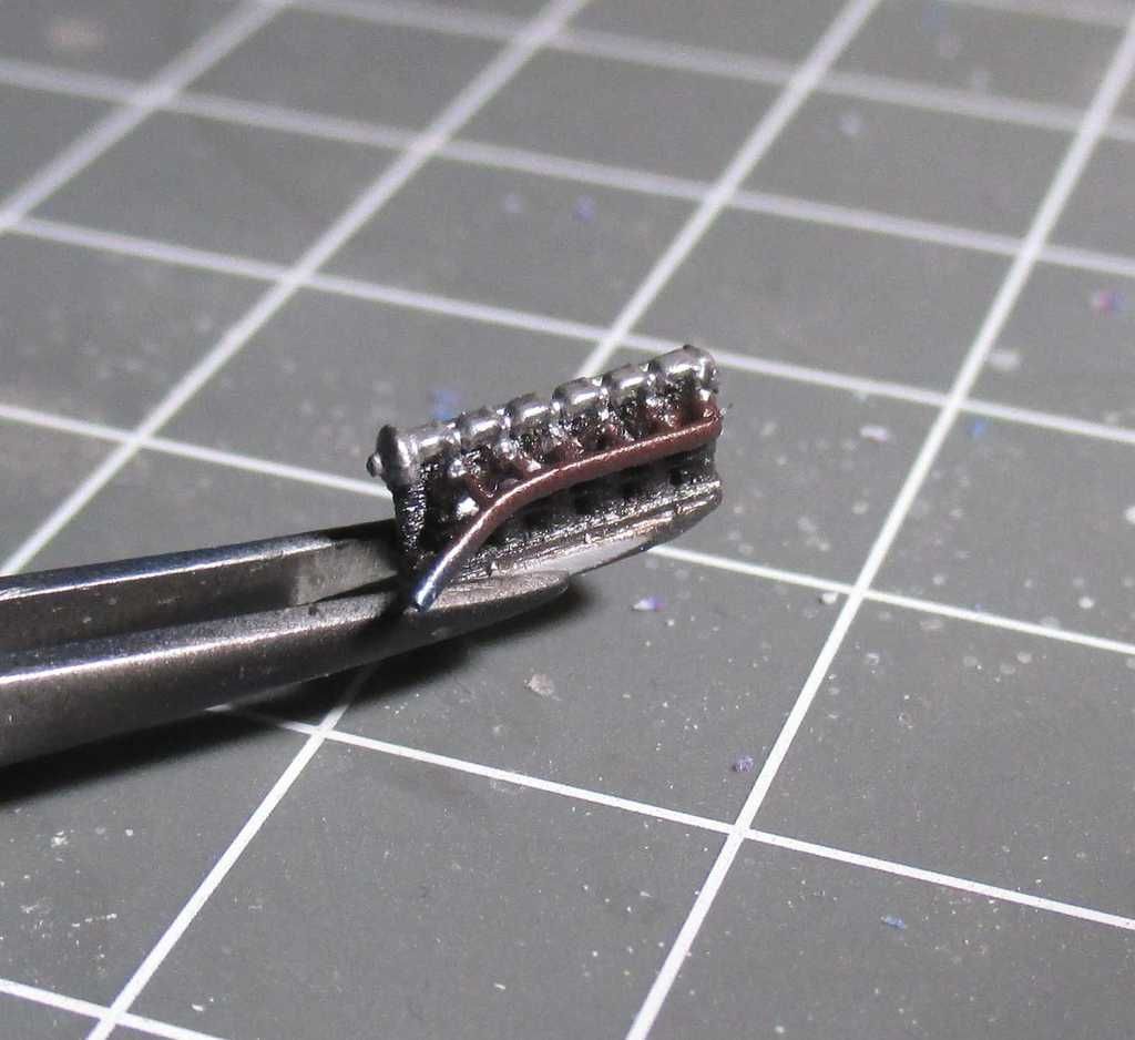

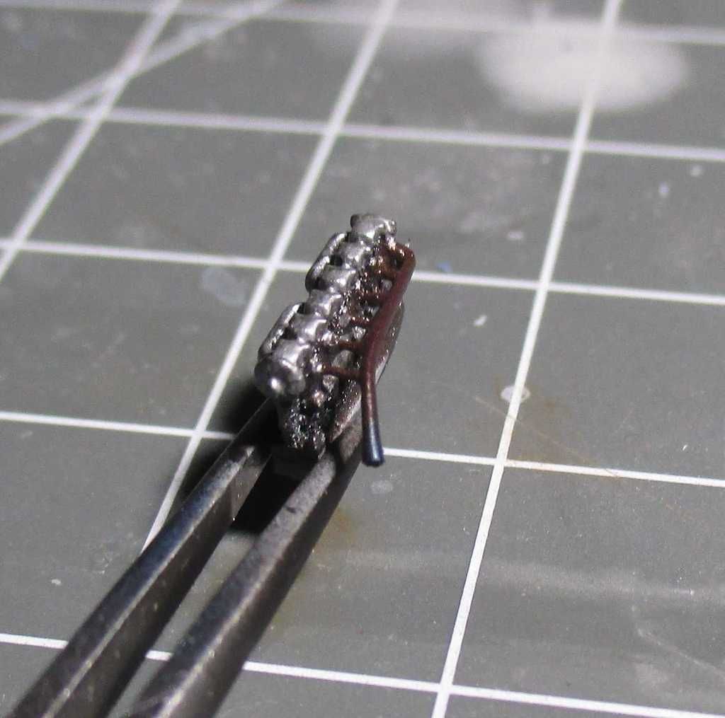

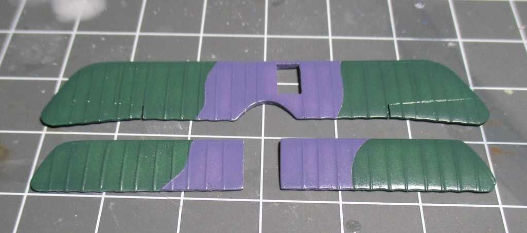

As mentioned before, I used Bo's 3D printed Mercedes D.III engines, they are really excellent! I just added the exhaust painting it with Caput Mortuum and a coat of Prussian blue to simulate the burnt metal at the end of the exhaust.

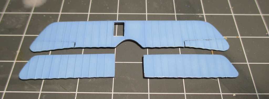

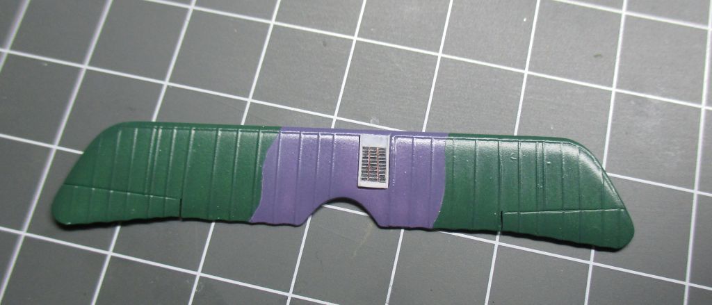

For the wings I used DB paints as well, I want to take advantage of the translucent effects of Kraplak, that is why I took a bit more care than might be necessary. I tried to apply preshading on both side of the wings, on the upper side it will definitely disappear under the coat of red, but the contrast of varying base colours should remain visible.
Currently I am dealing with the radiator, so far I have not found yet a proper method to make it look the part.

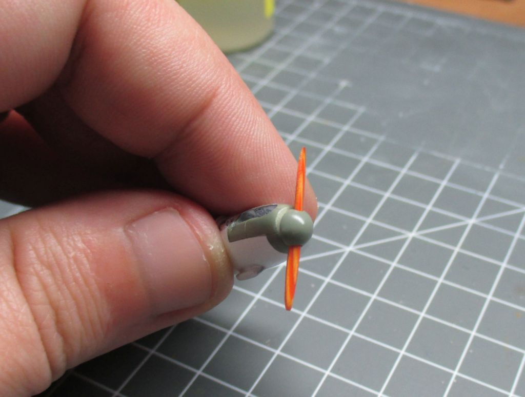

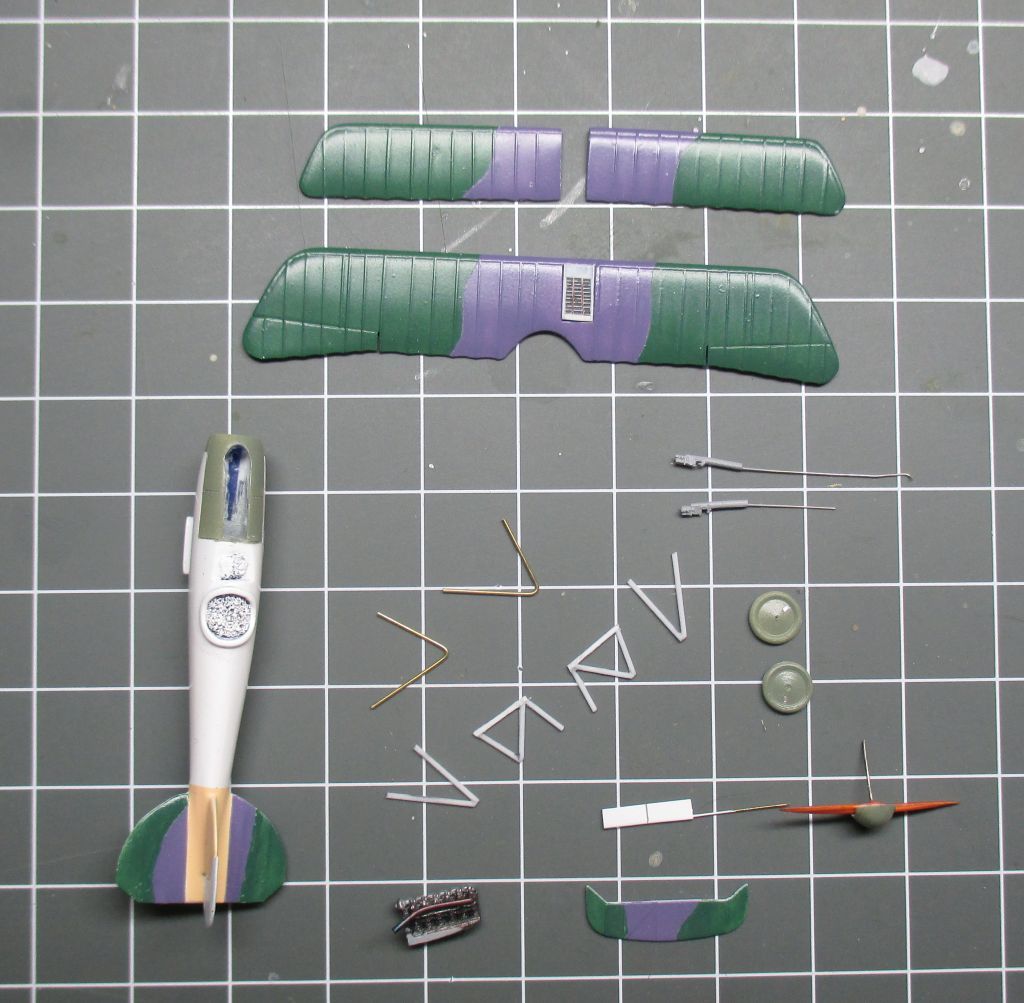

I used the vacation this week and made a little progress on my Albie.
I am not very happy with the radiator and will give it another try, we will see what the result will look like. One question to Albatros experts - what colour was the radiator? Was it the typical Albatros greyish-green?
I prepainted the camouflage on the tail to use the translucency of DB Kraplak, should make a nice effect. Stil not sure though whether I will not change my mind and build Bäumer's D.V from Jasta 5 anyway...

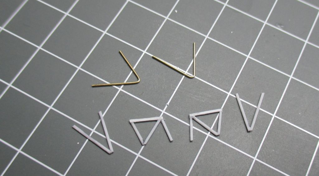

The wing and fuselage struts are made from evergreen profiles, undercarriage struts are from brass rod.
I simply like the propeller :)
This is the overview of the main parts, stil a lot of work ahead, though.

           My apologies for being late to this one. Simply beautiful. Your propeller . . . I wish I could replicate it at twice the size in 1/72nd. Did you use a "sandwich" method of different colored plastics and then carve it out?

to WarrenD: Yes, correct, I used the sandwich method. Finally I have found red plastic sheets, Hellboy helped me find a method to sand the 1mm sheet to 0.1 mm thickness. It was a very positive surprise to me how good it looks with light ochre oil paint wood effect applied on it.
