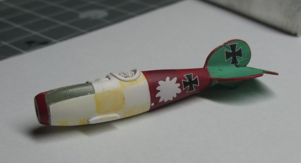

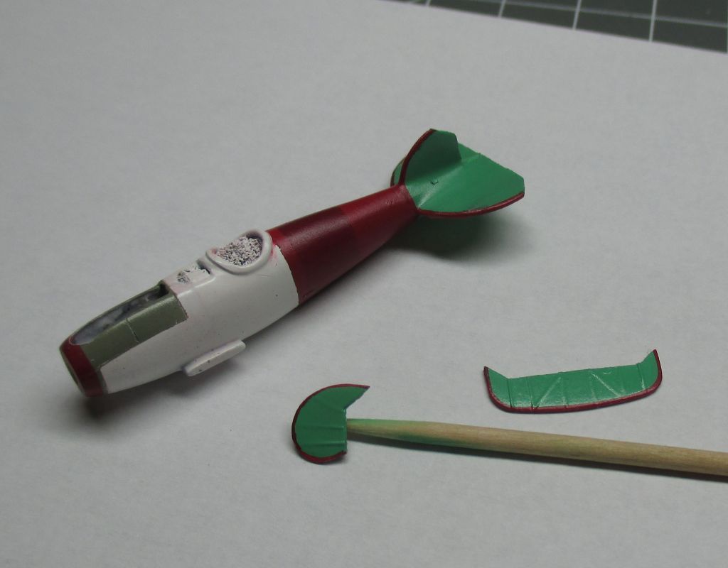

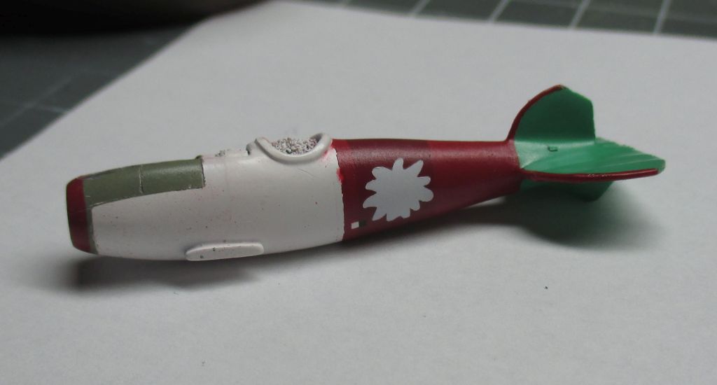

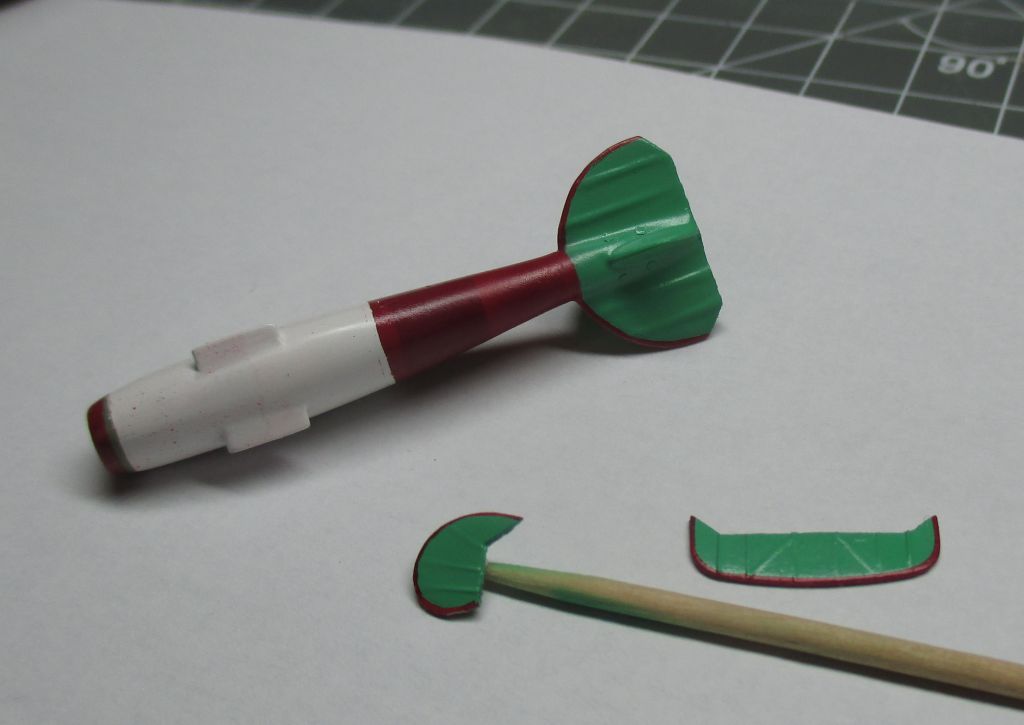

Masking the tail was really difficult, eventually I used a combination of 0,4 mm masking stripes cut from Kabuki and the elastic Tamiya masking tape (great stuff, btw.) and Winsor and Newton masking fluid. The outlines should be a tick thinner, I assume, on the other hand I have to say I like the look of it. Rudder did not work out very well and will have to be repainted.
And here the base for the Edelweiss, the rest will have to be hand painted.
Lower wings almost finished and ready for weathering, I just added the inspection pannels.
Ondra

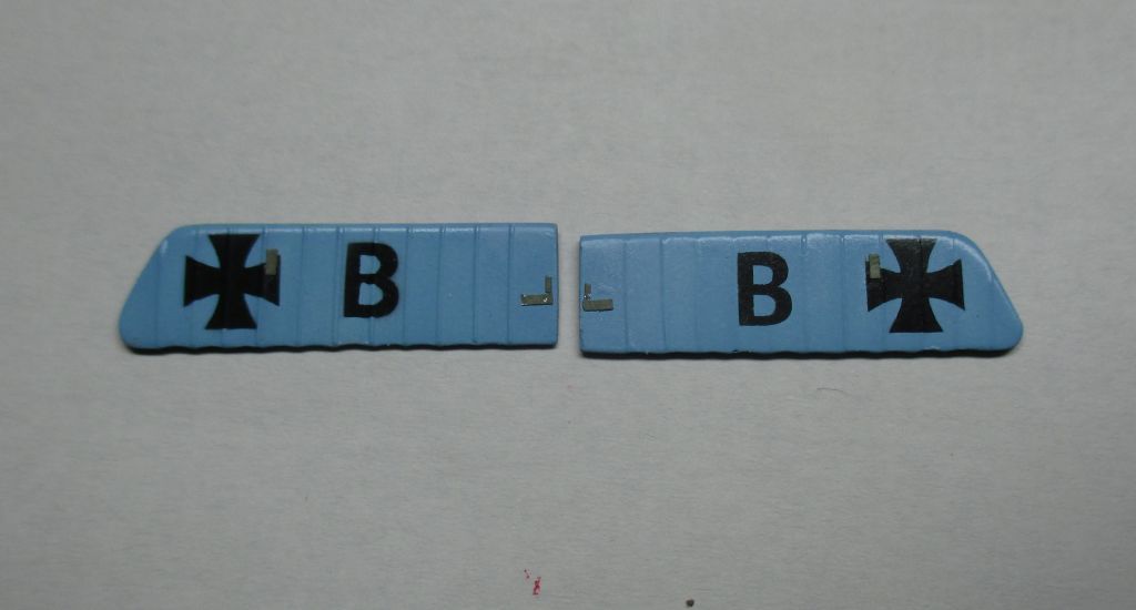

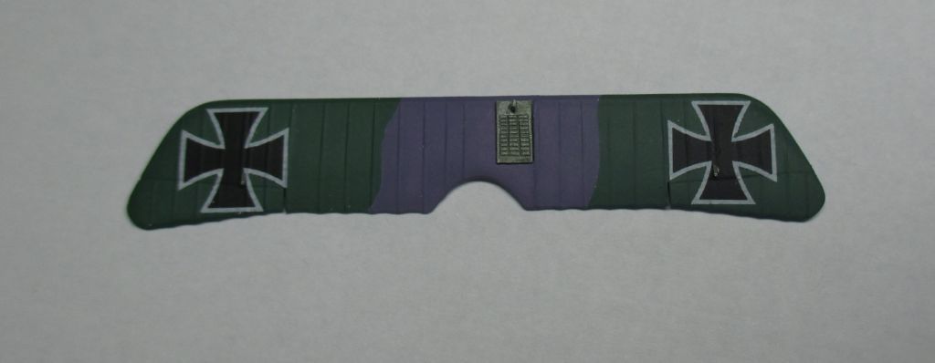

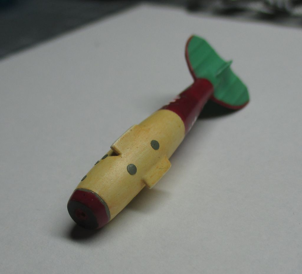

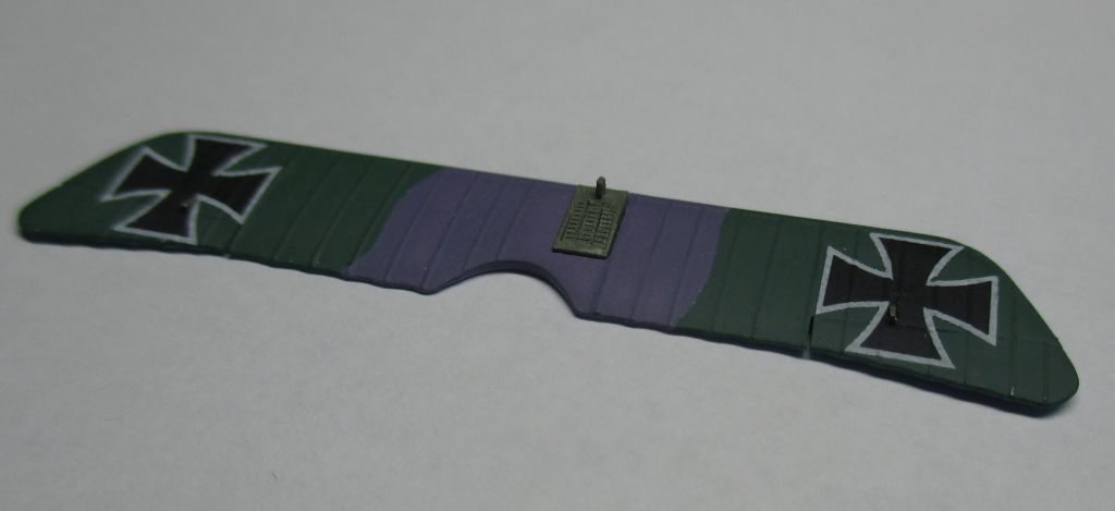

Decals are in place, I tried to make a sort of "preshading" on the wooden part of the fuselage using aquarel crayons, afterwards I will smoothen them with wet brush to reduce the contrast. The wooden panels should not be really visible in this scale, therefore I would like to achieve very soft differences between the particular plywood panels.
The upper wing also got decals and I added the aileron fairings - they are not really visible on the photos, but they are there. :) Still thinking about the radiator, I might give it one more try and make a new one, I am not really happy with this one.
Ondra

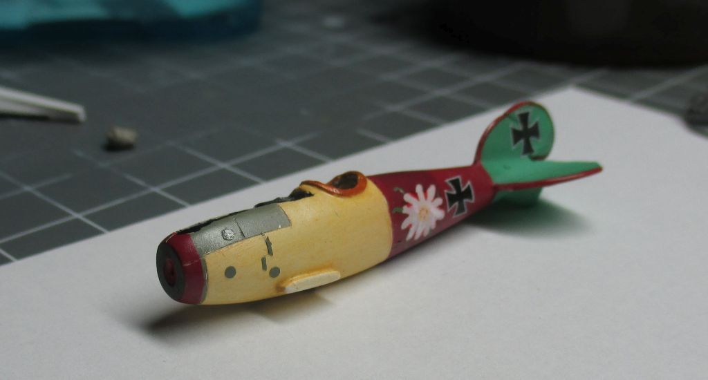

Some progress on the fuselage, woodgrain added and a few details made of self adhesive aluminium foil painted with DB greyish green.
The Edelweiss is really difficult, I have to paint details with a brush and so far the result does not look good at all. Maybe I will have to use a decal eventually.
Ondra
