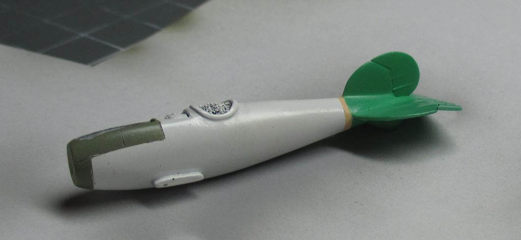

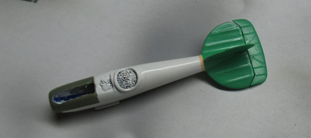

Ok, decision taken, it will be Bäumer's kite, the green tail is really cool (besides that, I already have one of Manfred's machines in my collection).
Basically all the previous effort on the tailplanes disappeared under the coat of green, but nevermind, I love that shade. It showed some flaws which will require a touch-up.
The red outlines will be quite challenging but I will find a way to replicate them. :)

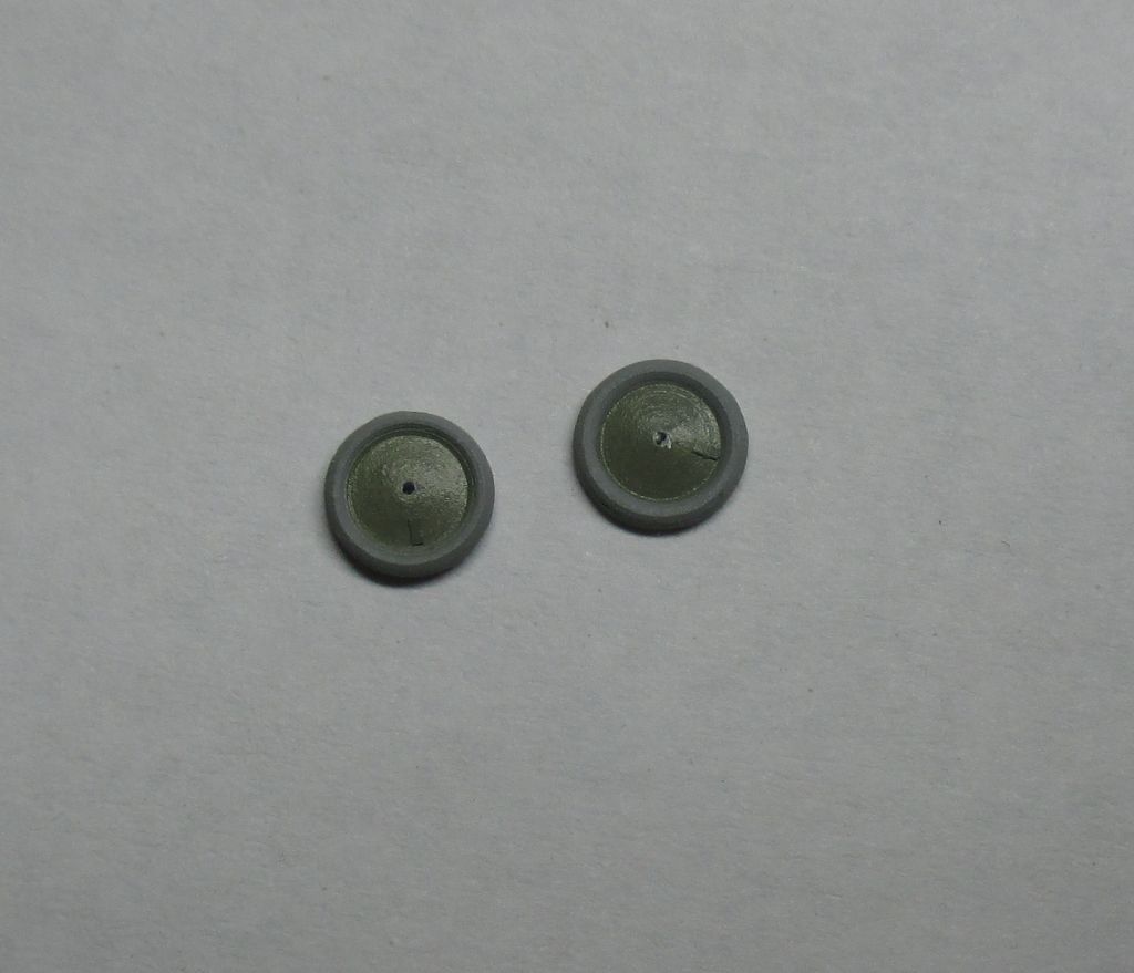

And this is what the wheels look like before wash and weathering.
Ondra

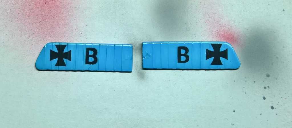

Hello everybody,
not much time for the workbench recently, so I just made a slight progress on the lower wings - markings applied using masks. Not perfect but I can live with it. I will have to rework the inspection panels - the first version was made using 0.1 mm styrene sheet, but those were too thick, so I will replace them with panels made of aluminium foil.
Ondra

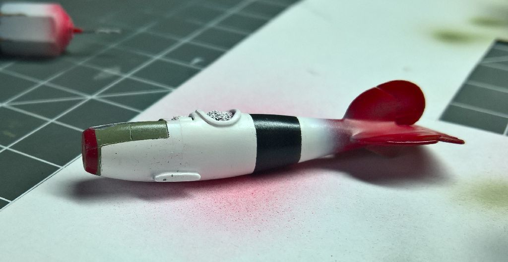

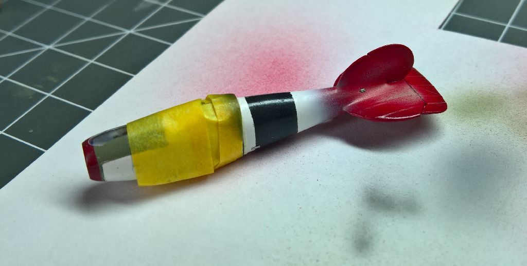

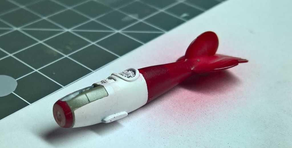

Some progress on the fuselage - originally I thought the dark stripe on the fuselage was painted with caput mortuum, but Sergey had made a research on this machine before and found out this plane originally had a black stripe on the fuselage, which was later on overpainted with red with black showing through. Masking was quite difficult but I like the result. I am having difficulties downloading photos from my phone (Windows 10 still needs to get some bugs fixed, obviously...), hope to post more photos with progress tomorrow.
Ondra

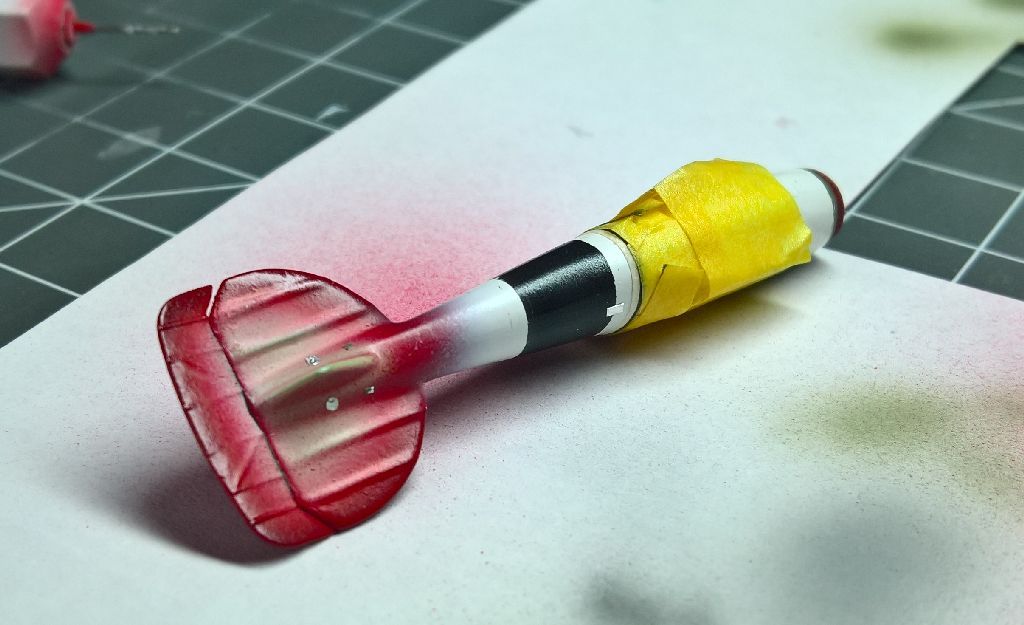

As promised, here more photos on the progress, acutally preceding yesterday's photo:
the black stripe on the fuselage:
and here the masked fuselage with a few details added:
Ondra
