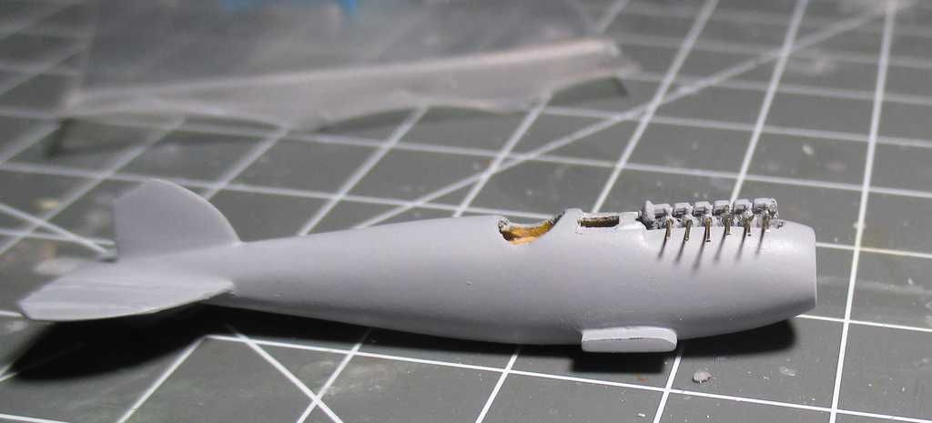

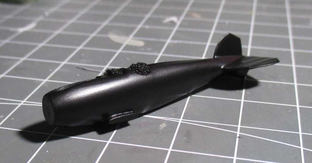

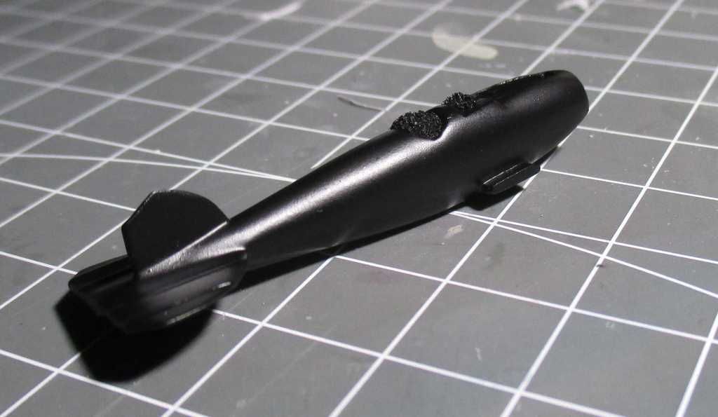

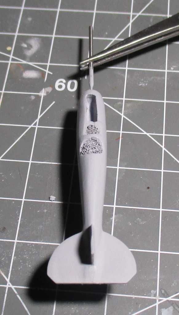

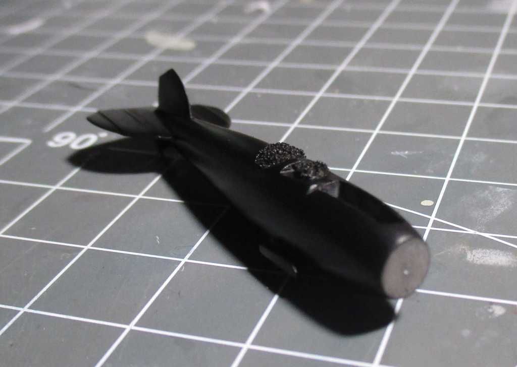

As my crew of ants left for summer vacation, I closed the fuselage. :) The amount of detail inside seems to be ok, actually only one gauge, the steering stick and the seat are visible. There is a huge amount of filing and sanding ahead of me but the shape of the fuselage seems to be basically correct.

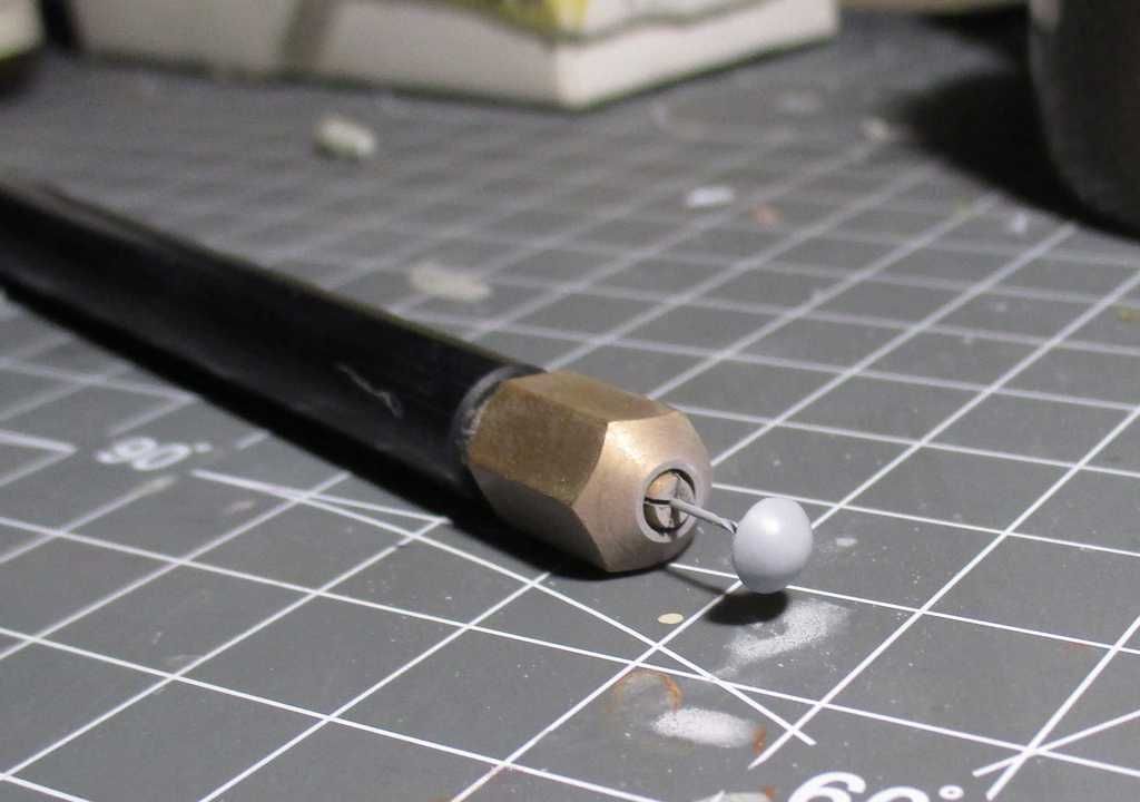

My new Proxxon Micromot arrived today so I tested it right away and made a new propeller cone (hope this is the correct word...). The first impression on the new tool is that it is worth every last cent.

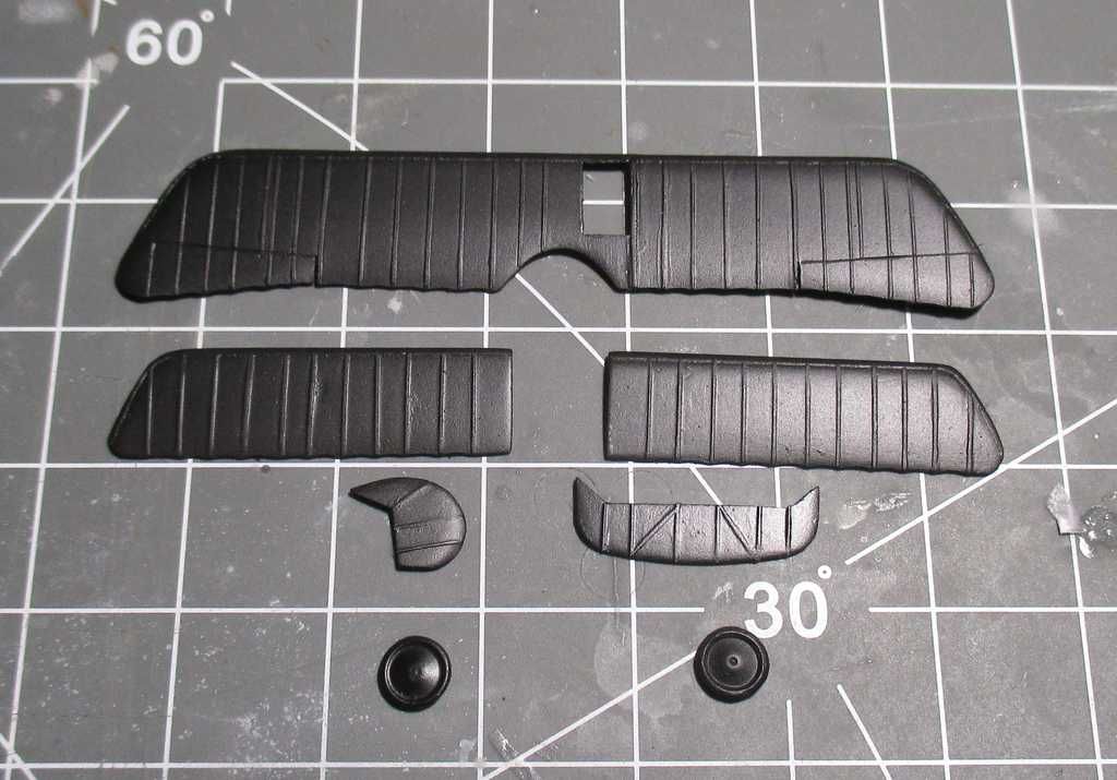

And this is the very beginning on the lower wings, the ribs are glued on and I sprayed a thicker coat of surfacer on the leading edges to simulate the plywood cover. Hopefully this will remain visible after sanding as I have to reduce the thickness of the ribs.

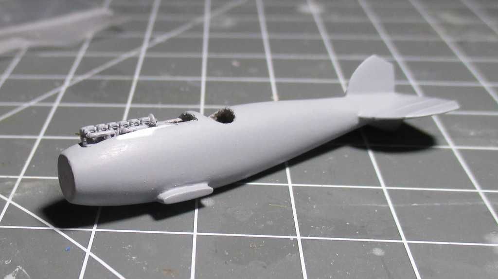

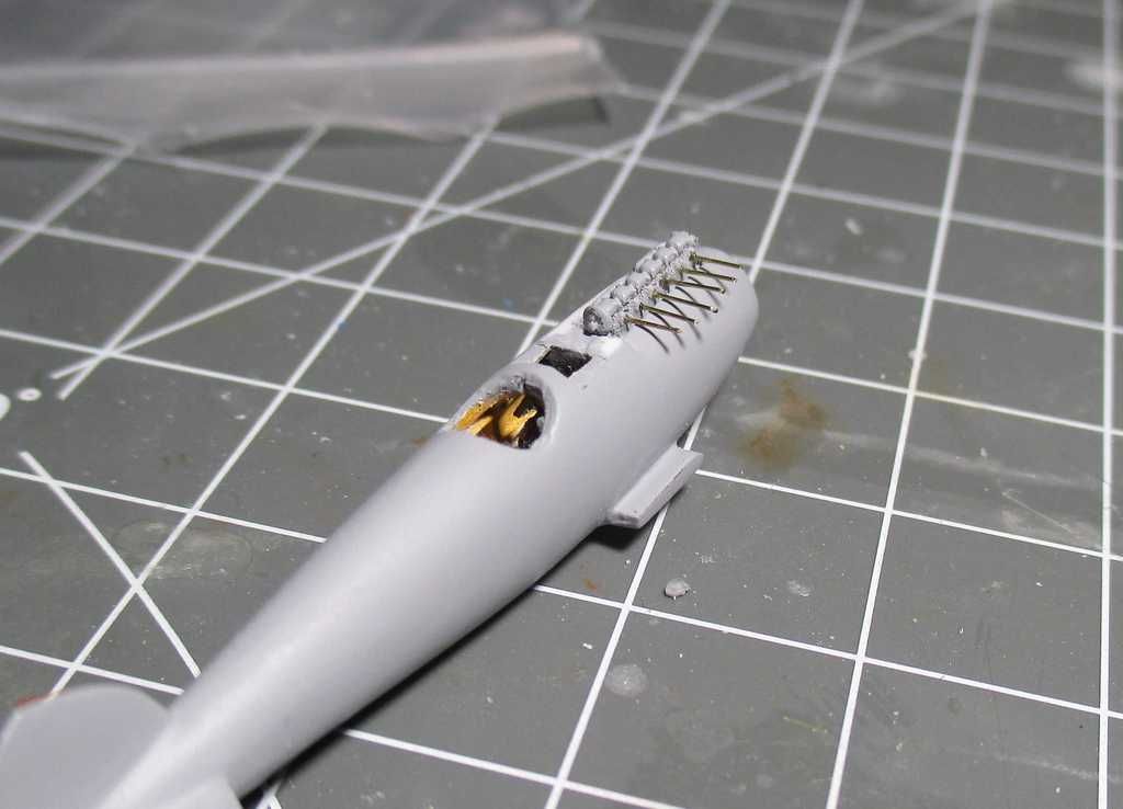

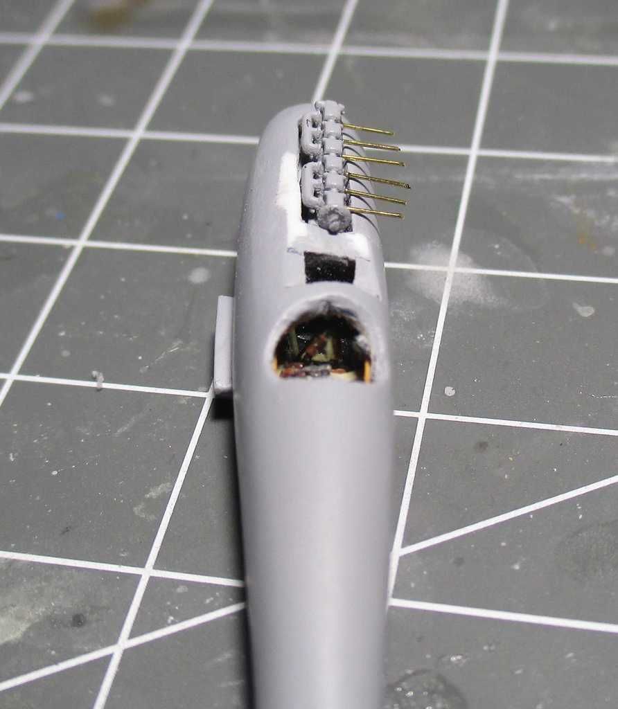

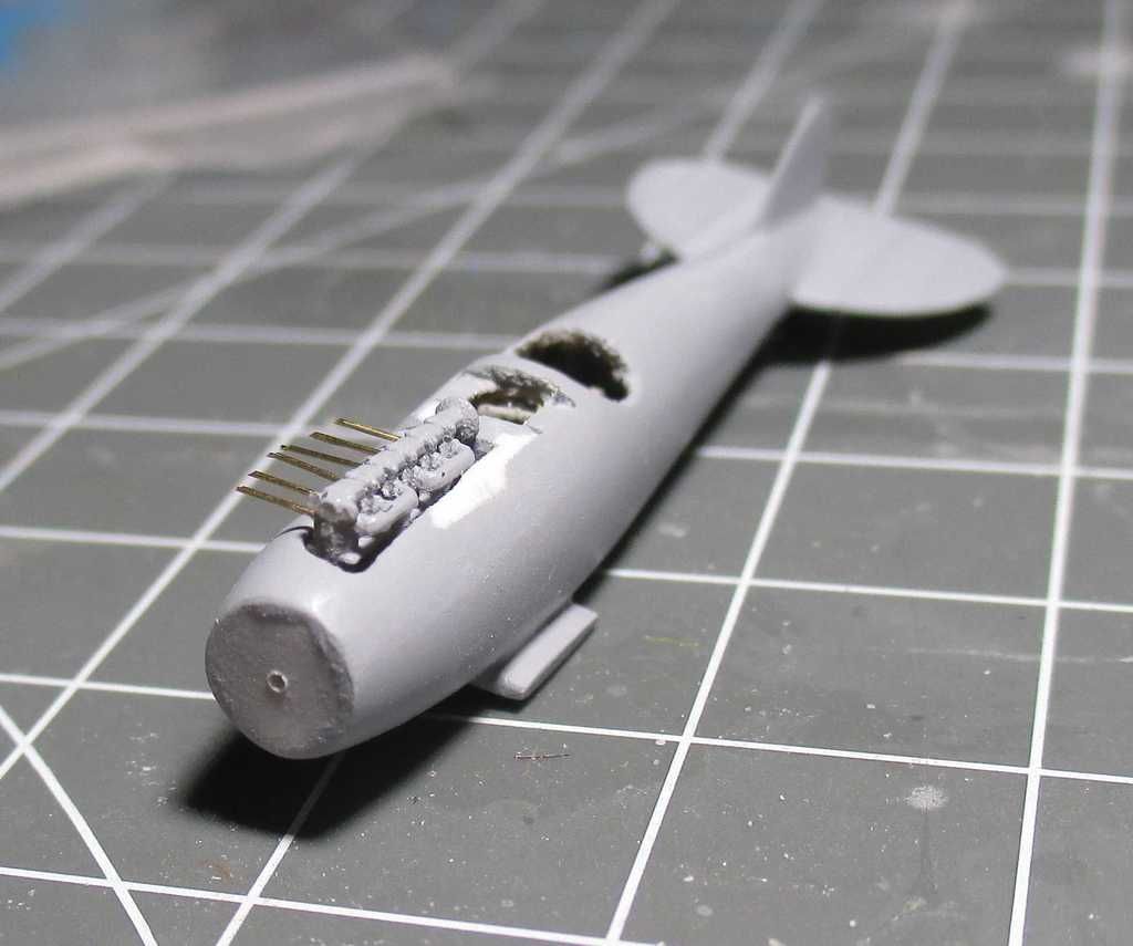

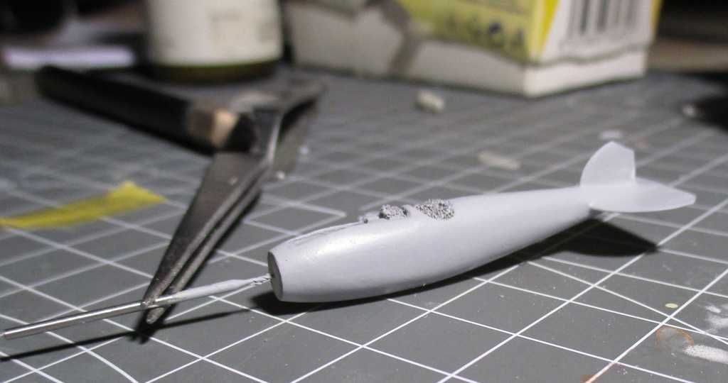

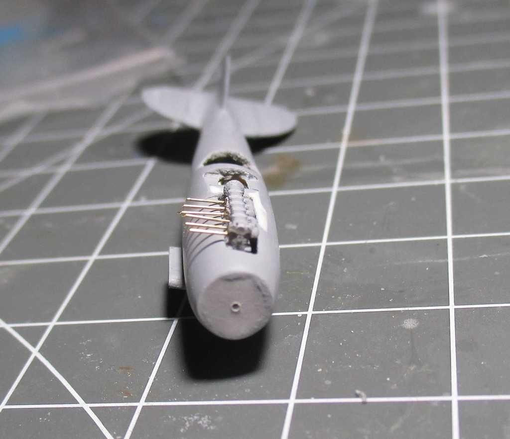

And one special big THANK YOU to Bo for the 3D printed Flugzeugwerke Mercedes D.IIIs. Today I made a dry fit test and they really look awesome! The wires simulating exhaust pipes are not glued yet.
The black surfacer showed a few flaws which will require a slight touch up, but all in all the parts look satisfactory.

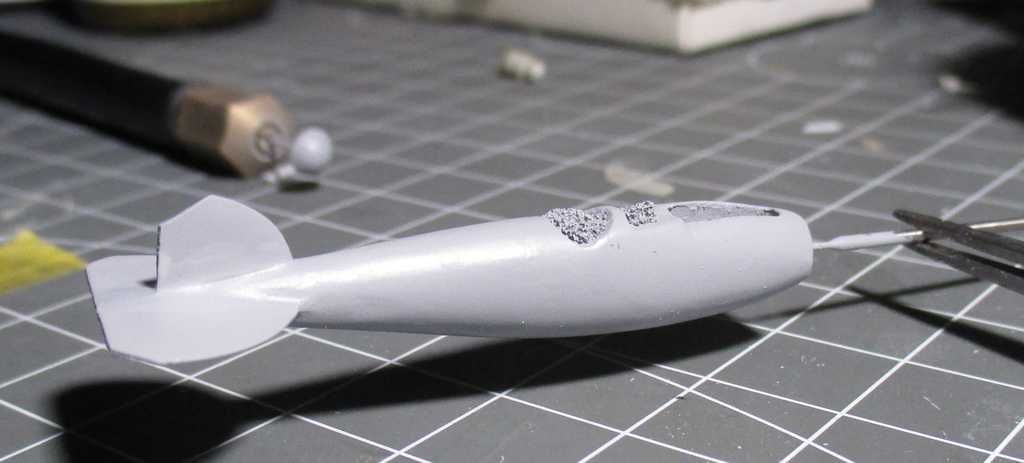

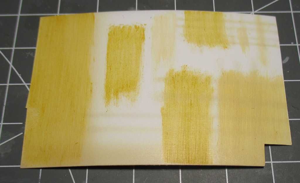

I started experimenting with oil colours for the fuselage plywood but I can't seem to hit the right shade.

Very cool, Ondra! The plywood shade looks right to me.

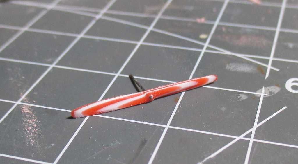

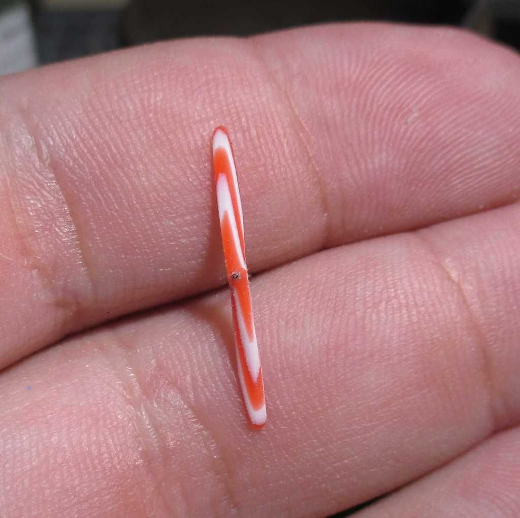

I was not very happy about the propeller so I decided to make a new one using a sandwich of red and white and plastic sheets. Only the front side has been filed to shape so far, I will see what it will look like with the woodgrain on it. But I think this one is much closer to the right shape and lamination look.

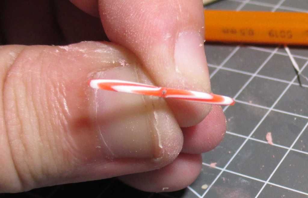

This is what the previous propeller looked like.
