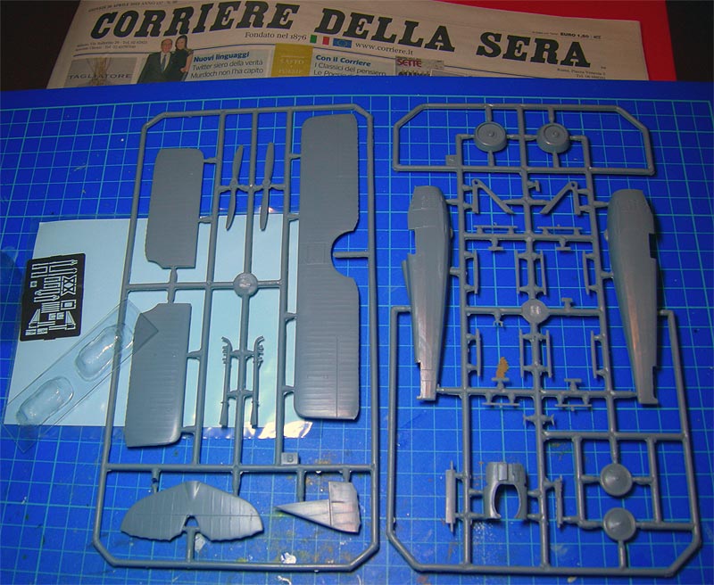

The sprues look very good, no flashes and no meaningful extraction points, the details are crisp and well proporioned

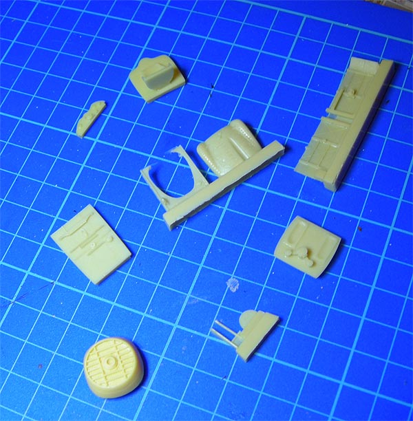

Some parts of the kit are resin cast:

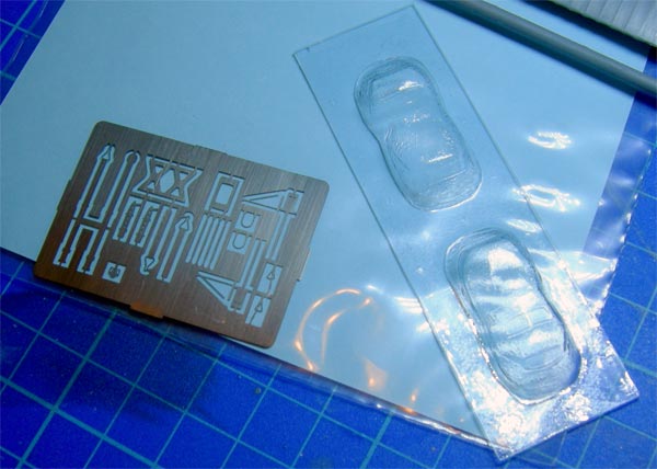

PE parts represent the seat belts and some parts of the controls,
This is my inspirational book: Italian aces of the Great War (by the Italian Air Force Documentation Services).
I have also bought this PE Part set...

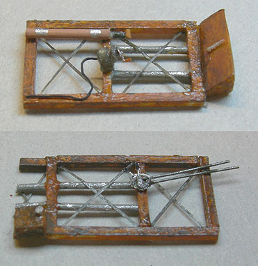

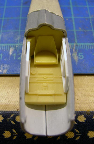

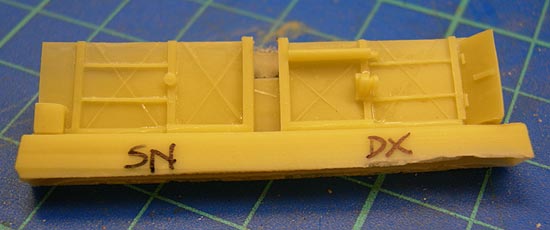

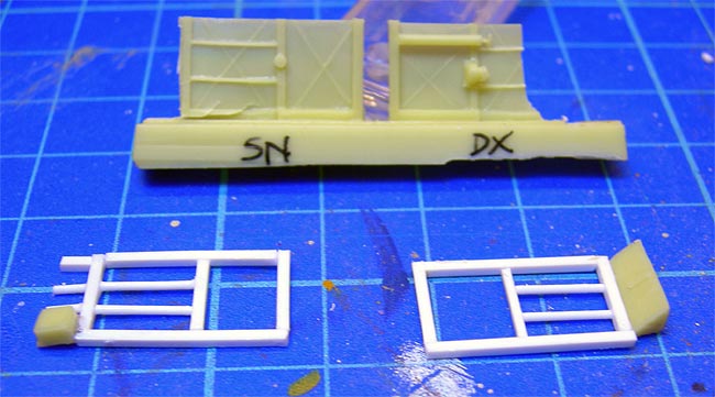

I started working on the cockpit, I do not like the resin cockpit sides, the fake rigging is awful

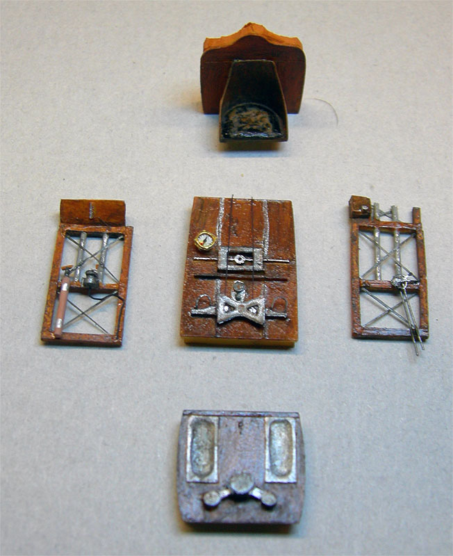

so I tried to keep just the wooden struts and tried to empty the space in between, but the piece is so brittle it broke... And I decided to make the cockpit sides from scratch and keep some elements extracting them from the resins

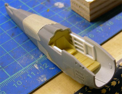

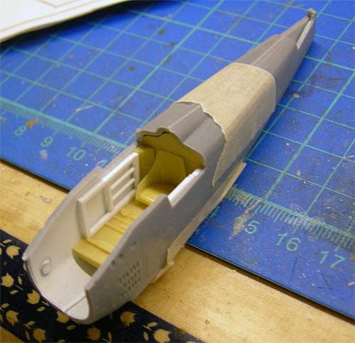

Here is s first "dry" assembly of the fuselage with cockpit pieces

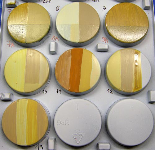

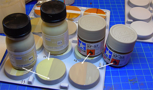

I started some colour test:
And at the moment I decided to go with  Misterkit #FR03 French Light Yellow for the CDL and Misterkit #FR04 Clear Doped Linen for the darker shade of the nose both metal and linen sections.
Up to now I have completed the 4 sides of the cockpit.

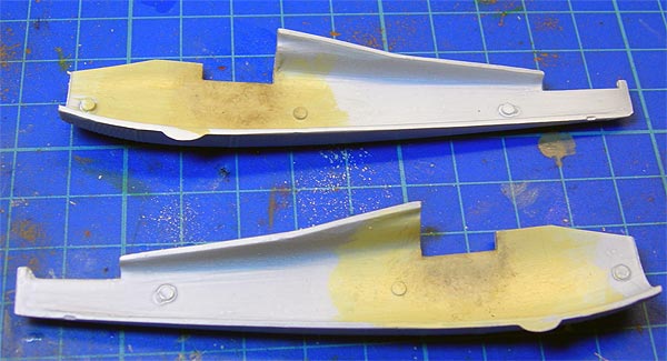

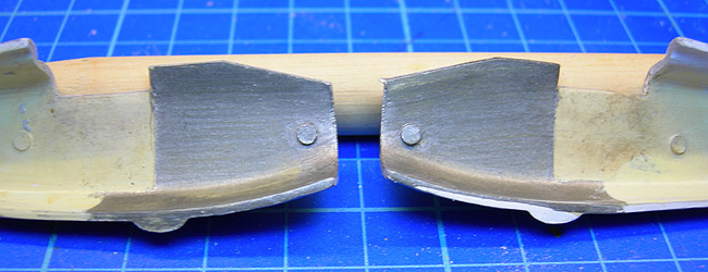

Then I have painted the fuselage interiors dividing it in Linen and metal following the panel lines visible on the external side.
Here is the result before painting the metal (must re shoot the picture, sorry!)

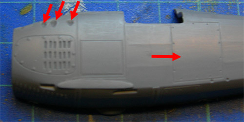

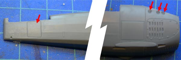

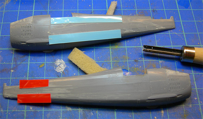

I have been in touch with Tomasz Gronczewski who studied Giorgio Pessi's SPAD I am trying to reproduce here...
He gave me so many interesting suggestions and I will follow them.

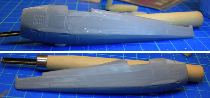

So after studying Tomasz directions, I have proceeded to modify the fuselage:
here is how it looked before the care
In Blériot-built Spads of the 1xxx series the tail skid access panel on the right side of a fuselage was not there, they had a "T" shaped stitched cutout on the left side of rear fuselage, so I have to remove it, as I need to remove the camera access panel on the left side of the fuselage right behind the cockpit-
Also the exhaust holes have to be lowered...
After the care (mr.dissolved putty, primer mr.surfacer 1000, letter punch tape and a small gouge) here is the result
Then I have painted the inner surfaces of the metal panels that will be painted beige on the outside.
Now I will complete the cockpit details.
Antonio

« Reply #13 on: July 08, 2012, 07:57:10 AM »
Excellent work in making the unwanted detail vanish.  I just received Tomasz's excellent book and it has inspired me to build the SPAD V.II.  Very few airframes had the panels that the SH kit has, so I'll be doing the same modifications on my kit.  I'll be following your build very closely.
