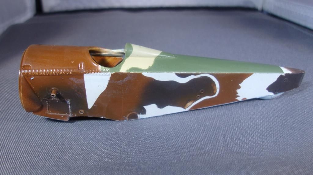

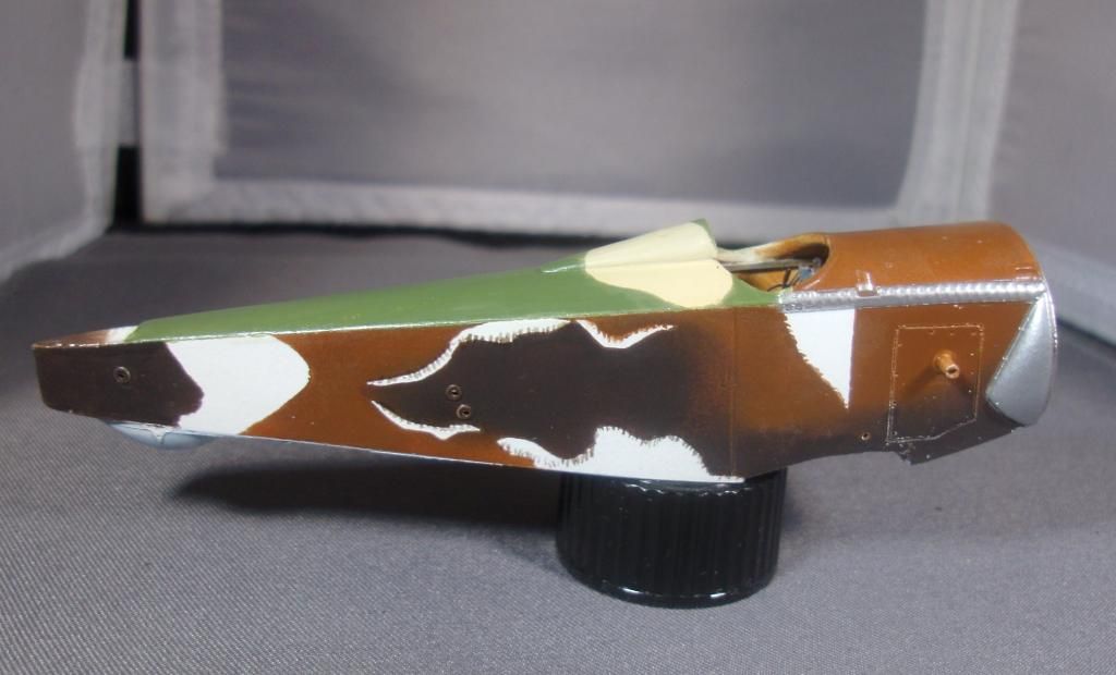

Over the weekend I began the fuselage painting, first a coat of white primer was applied.  Next I scanned the color profiles of Pavelka's aircraft in the Over the Front article, and reduced them to 1/48 scale.  I printed them out and used them to cut masks from Tamiya tape and covered all of the white areas.  I also masked the upper fuselage and bottom of the fuselage to allow me to spray the lighter colors later.  I sprayed Model Master Leather for the red brown, for some reason this did not dry flat but stayed glossy and took a long time to dry.  Once it dried I sprayed a mix of Mode Master French Chestnut Brown and black for the dark brown.  Once it dried I masked off the fuselage sides, and sprayed the upper fuselage with a mix of Model Master British Gulf Lt Stone and White to give me a French yellow shade.  I masked off the spot behind the cockpit and sprayed the upper fuselage a mix of Model Master Forest Green and RLM 02 gray. I wanted the colors on the fuselage to be different from the wings since this was an old aircraft that had been repaired and repainted several times and used by Bert Hall and several other pilots before Pavelka got it.
The bottom of the fuselage was painted Misterkit French Light blue to finish the basic colors as seen here.

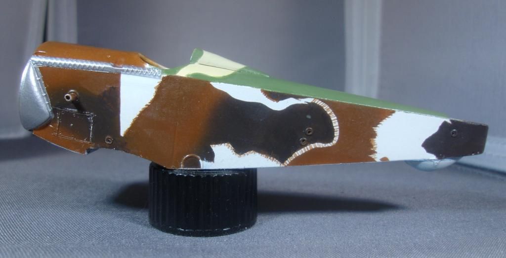

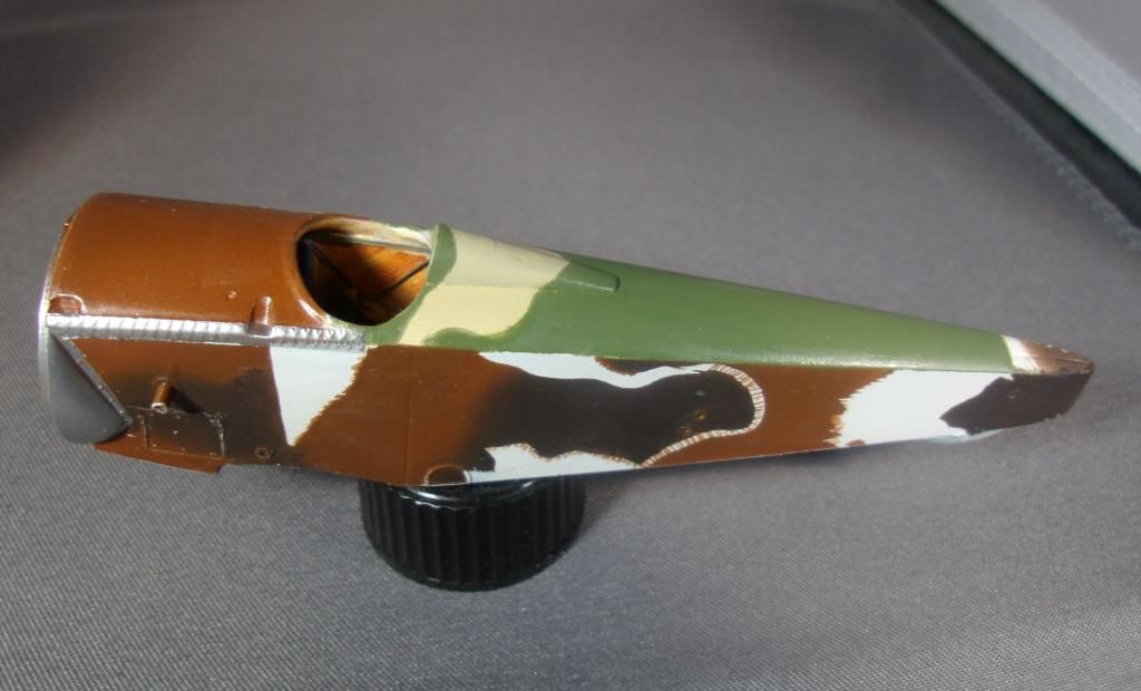

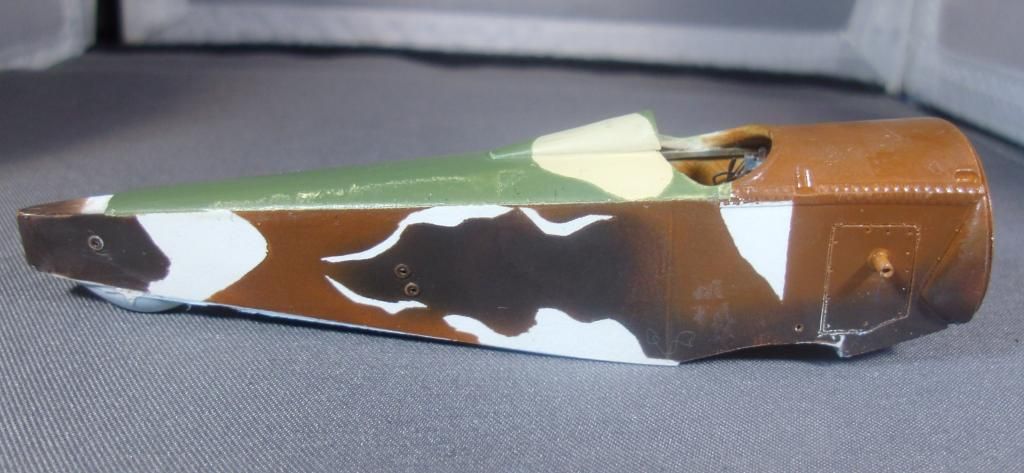

I used a brush to repair some damaged areas in the paint, and also a fine brush and Leather paint to make the small lines between the colors as shown in the profile, and a little darker color to do the fine lines over the white stripes.  Next I masked off the aluminum cowling, side panels and reinforcement between the forward fuselage and upper deck, then I airbrushed this area with some Floquil Old Silver.

Dave,
Absolutely outstanding! Cow hide indeed!

what an original camouflage. sirely paint in the field.
I haven't found picture of this plane in the web, only this paint:
it si obviously  this plane. is there any picture of it ?
cage à poule, member of this forum did the plane when bert flew it.
This is another one or it 's the same?
anyway your camouflage is very interesting, and very well done.
the darker color is bdark brown isn't it?
it could have been fabric color too, wich was the colors of the apparence of the nieuport before the camouflage appears in 1916.

Very nice Xan.  I was thinking of doing BERT at first but decided to do the later version as painted by Pavelka, as it is a one-off scheme and will stand out of a collection of camouflaged Nieuports.  But in Alan Toelle's article in Windsock we learn that the underside of Hall's Nieuport N 1208 was painted sky blue at the factory.  Both Pavelka and Hall have written that the underside was sky blue, and Alan has found information from 14 May 1916 that says to "tint the undersurfaces of the camouflaged airplanes to light blue".  He concludes that aircraft with serial # N1201 and higher had the blue undersides.   So we can safely say that aircraft with lower serial #'s had the clear doped linen underside, while those later (which would include the early Nieuport 17's) would be light blue.

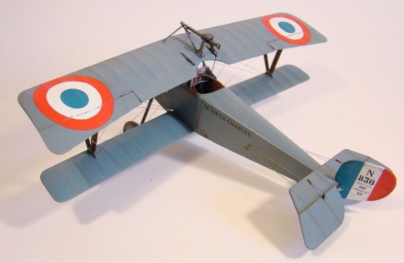

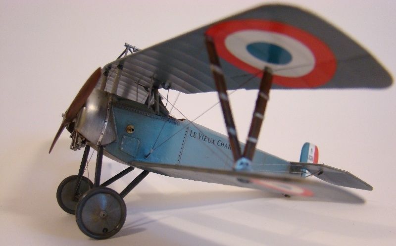

All right, some bébé were truelly paint in blue or blue varnish before the camouflage appears, as the Ni-11 of Verdun memorial mooks like:
wikipedia
the most famous of them is the Guynemer's one, the n°836
http://www.vadelaincourt.info/aviateur.htm
cage à poule, again did this model:
in my opinion this blue had to be horizont blue, the same you used around the wings...

Hi Xan,
If you look at my first photo you can see that one of the planes in my Nieuports over Verdun series is the blue N.11 flown by Guynemer.  I painted this with the same color that I used for the outlines on all of my camouflaged Nieuports.
In the first part of the Windsock article Toelle mentions there were several solid colors, including horizon blue and cream.  At first I thought that the horizon blue would be the same color as the outlines so I painted my wings that color but every profile and built model of this plane shows the lighter blue.  That brings into question exactly what color Horizon blue is, if we look at the French Horizon blue uniform here is what we get:
So I am thinking that this shade is lighter than the color used around the edges of the wings and the metal struts.  Perhaps I will use that as a base color and give it a thin coat of light gray to tone it down a little.
Oh sorry!
the color you used seems accurate to my eyes...
Anyway I am always asking my self about this blue coat. Is the 836 the only one ? if not how much and why?
One problem is that this color is very difficult to detect in B&W pics...
