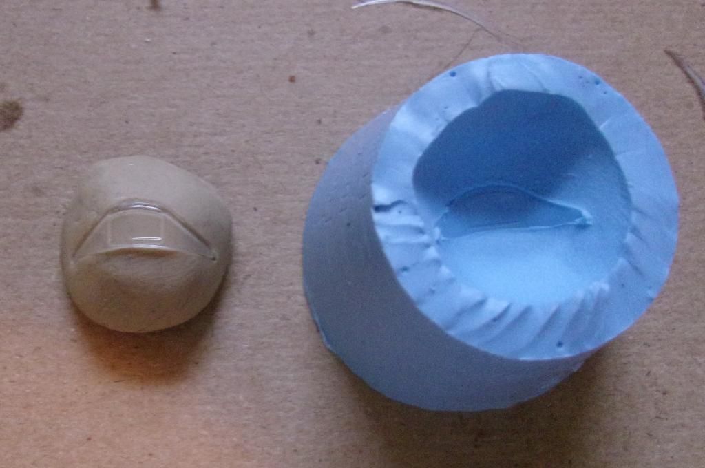

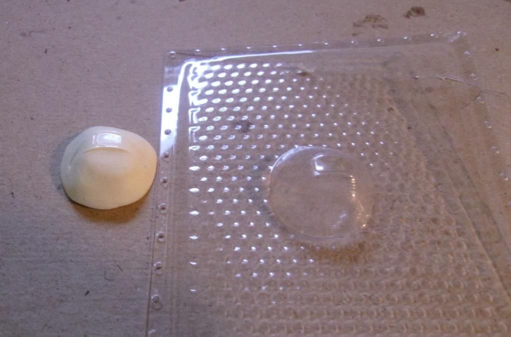

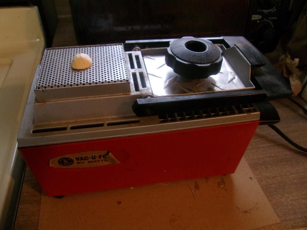

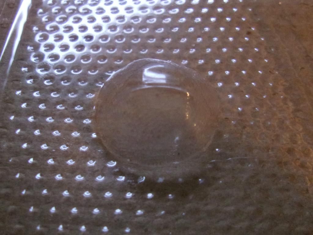

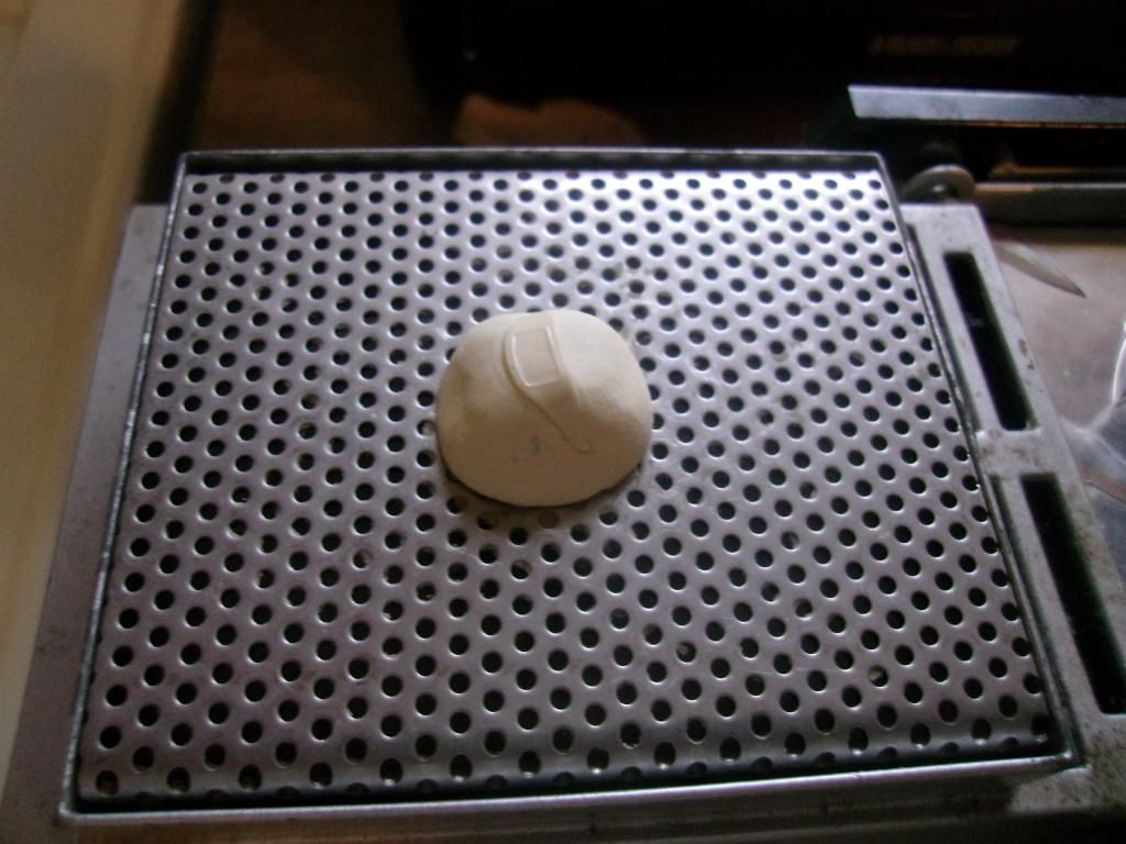

Latest update on a snowy New England weekend...  I was looking in the box of Nieuport parts Friday night and cannot find any of the clear canopies from the 3 Eduard kits in the box... I'm sure they were in the original Eduard boxes but have been misplaced over the years since I started these.  so I decided to open up another Nieuport 11 kit in my stash and make a resin copy of the canopy (windscreen may be a more accurate term...) this allowed me to pull out my old Mattel Vac-u-Form which I restored a couple of years ago with a new pattern holder and seals for the vacuum pump.  The secret to getting this to work I have found out is to let it warm up 10-15 minutes before your first pul, then once it is warmed properly you only need to heat the plastic sheet a couple of minutes before you can get a good pull.  I made 4 nice copies so I will have enough to finish the three in the works and replace any damaged in the cutting or painting stage.

Nice work Dave! I do Miss My Old Mattel Vac u Form Machine!

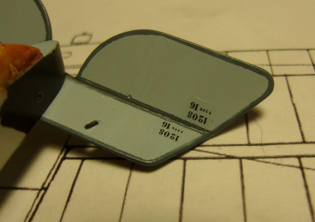

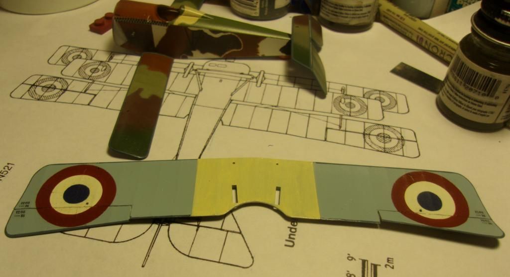

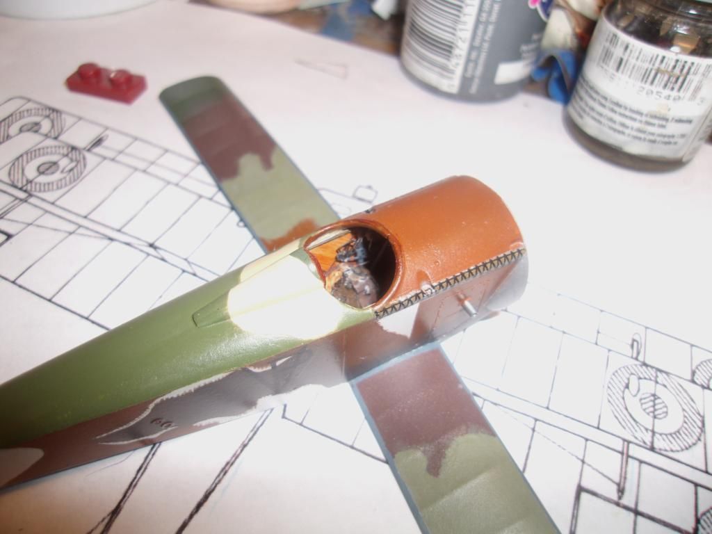

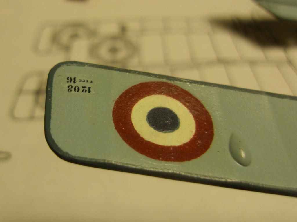

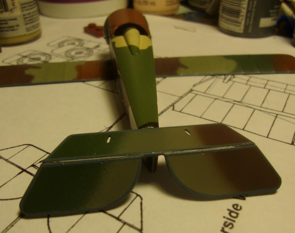

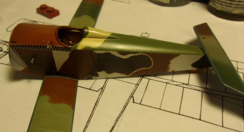

Another week of work, assembled the lower wing to the fuselage and puttied that all and smoothed it in, not that easy since they were already painted, but I ended up brush painting the light blue bottom with the Misterkit paint, that levels nicely to avoid brush marks and took a couple of coats to blend everything nicely.  I scored the horizontal tailplane and bent the elevators to the dropped position as usually seen on the Nieuports on the ground.  Then ran a brushful of glue down the score line.  Will have to go back with a black wash later as bending it cracked the plastic and some gray plastic is visible between the two blue lines.  So I assembled the rear tailplane to the fuselage using a Lego block jig to be sure everything dried straight and level...
Offline davecww1
  • Posts: 464
Re: Nieuport 16 N.1208 Paul Pavelka N.124
« Reply #43 on: February 22, 2015, 07:46:03 AM »

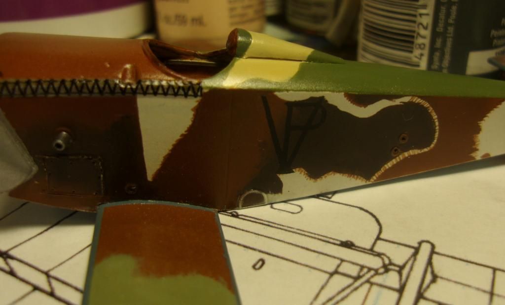

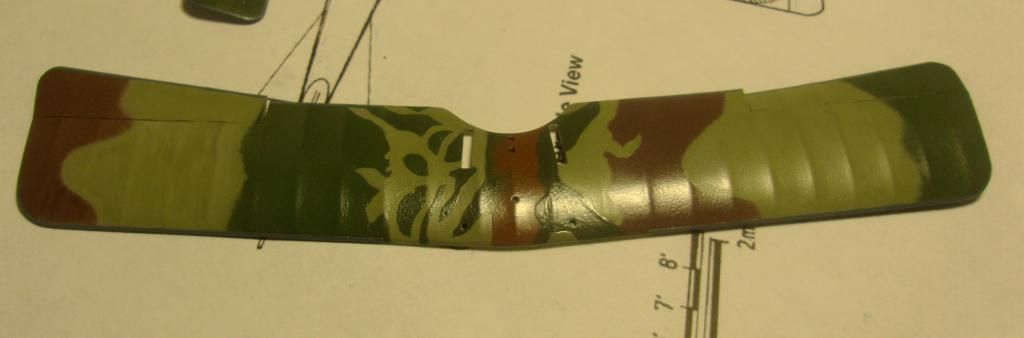

Forgot to mention, I also applied my home made decals to the fuselage, lower wings and tailplane, and rudder.  One thing I'm not sure about, the dark brown on the fuselage looks a little too dark to me as it is hard to see the PV brand on the side, but perhaps that is ok since it was supposed to represent a cattle brand on a piece of cow skin so would not be that much of a difference, but I will have to google cowskin I guess to find out how dark the dark brown areas really are!
Also note in photos of this heavily repaired aircraft the center section areas of the wing were repaired and repainted at the Escadrille level, so the repaired area on the upper wing was camouflaged by brush using whatever colors they had.  Also you can see clearly in other photos of this plane that the bottom of the wing had a different color in the centersection than on the outer wing area, so I am figuring the outer remained the factory blue while the center area was recovered with clear doped linen or else patched and painted the French Yellow color, so here is my take on that as well.  Still have to add a couple of CDL patches to the alierons as seen in photos.

« Reply #44 on: February 22, 2015, 07:50:17 AM »

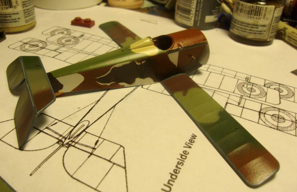

One last photo for this week, here is an overexposed picture of the fuselage (forgot to turn off the cameras flash) but it gives a nice view of the seat and interior detail visible through the cockpit opening.
