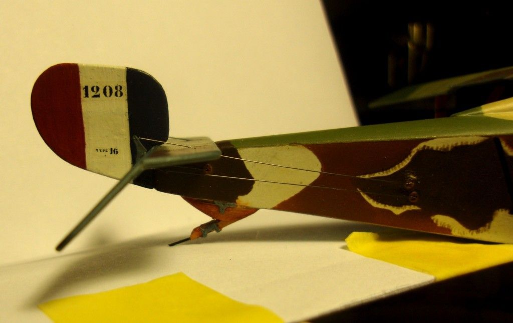

After taking the summer off to work on other things like my 1/1 scale car I am back to work on the Nieuport 16. First thing that I did was to scratchbuild the details on the tailskid, and carve a notch in the kit tailskid where a piece of steel wire will go to represent the tailskid. This allows me to make resin copies with the wire in the center of the mold so it comes out with a resin encased rod that will support the weight of the aircraft without breaking.  So I will be able to have these resin tailskids for the remaining Nieuport 11 and 16s in my collection.  I will have to study and see if the Nieuport 17 and 21 skid are identical.
Offline davecww1
  • Posts: 464
Re: Nieuport 16 N.1208 Paul Pavelka N.124
« Reply #53 on: October 12, 2015, 09:13:18 AM »

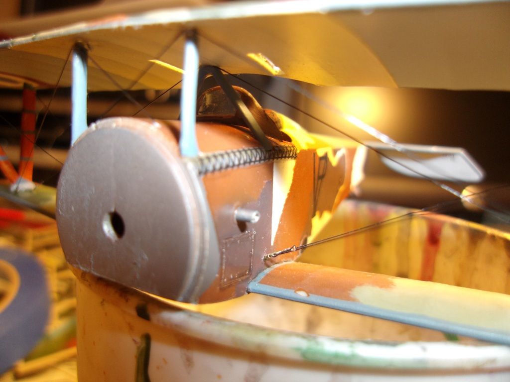

I also installed the upper wing and began rigging.  I tried using some Modelkasten .06 flexible rigging which looks good but I think it is too black, I will have to try to get a metallic color on it somehow.  I used Bob's buckles threaded through 1.5mm tubing for the buckles attached to the fuselage and lower wing.  I had trouble getting the superglue to stick to the Modelkasten wire but guess it looks OK.
Offline davecww1
  • Posts: 464
« Reply #54 on: October 12, 2015, 09:19:15 AM »
I also attached the rudder with a steel pin and added Eduard's photoetched control horns to the stabilizers.  I did not want to put any tension on these brass control horns and the control lines need to be tight, so I used a different material, I used the ceramic "Wonder wire" for these.  I had to use 2 pieces for the upper, cutting it where it went through the hole in the stabilizer and adding a short piece from there to the control horn. The lower wire is one piece cut to the exact size and attached with superglue.
  • Posts: 8660
« Reply #55 on: October 12, 2015, 09:20:36 AM »
Dave,
   I use Mr Metal Colour #213  "Stainless" on the Modelkasten thread and it works very well. Just keep it thin and don't go back over it or it will "clump". If you use one pass it looks really great.
Offline davecww1
  • Posts: 464
« Reply #56 on: October 12, 2015, 09:28:23 AM »
In the last photo you can get a good view of the resin and wire tailskid after installation.  Looks much better than the kit part.

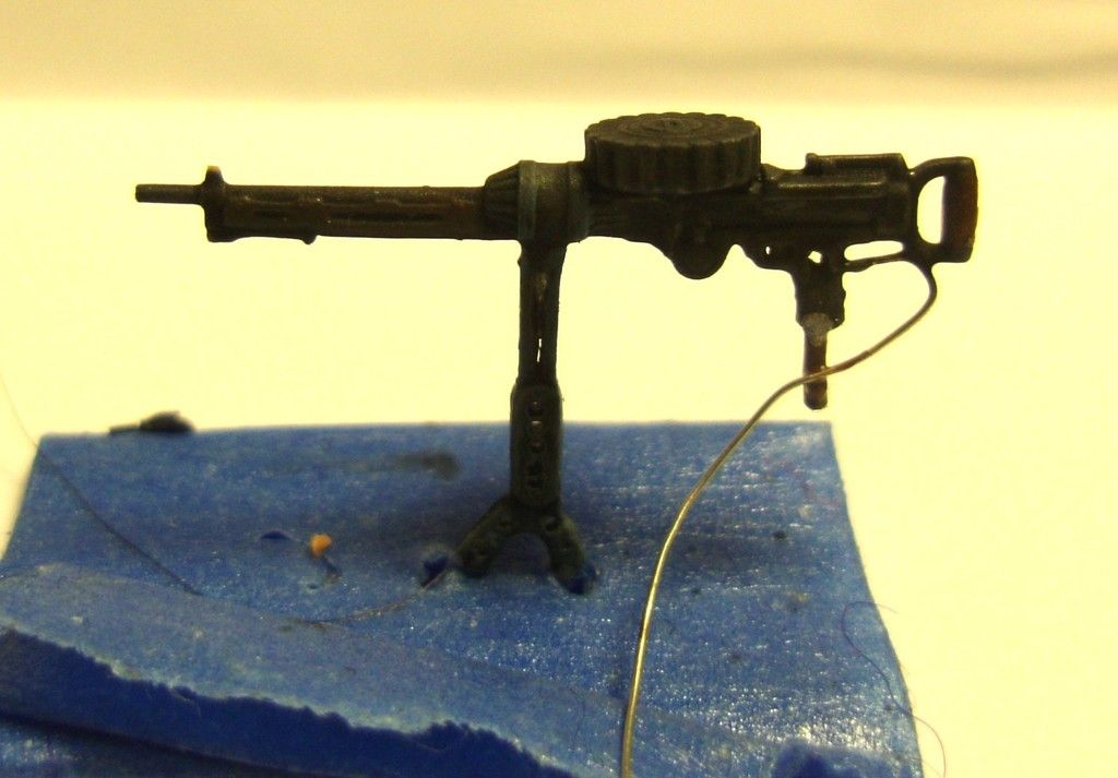

Here is the Lewis gun as used by Paul Pavelka.  I found a detailed photo of his gun in the Over the Front issue listed previously.  For this gun I needed one with the jacketed barrell & gas tube, so I ordered the Gaspatch Darne Lewis gun.  I drilled a hole in the hand grip and squared it off to match the photo of a gun with the hand grip removed.  Unfortunately these guns are very brittle and cracked into a few parts but I was able to glue them back together with super glue.  I also added the extra hand grip as seen in the photos, and the bowden cable to the trigger fro some fine silver wire.  The mount was the kit piece with the holes drilled out and a razor saw was run down the center to make it look like two rods at the top.  I painted it a dark gray, gave it a black wash and drybrushed it with powdered graphite to look like gunmetal.  then I painted the handles wood and the mount Intermediate blue.
