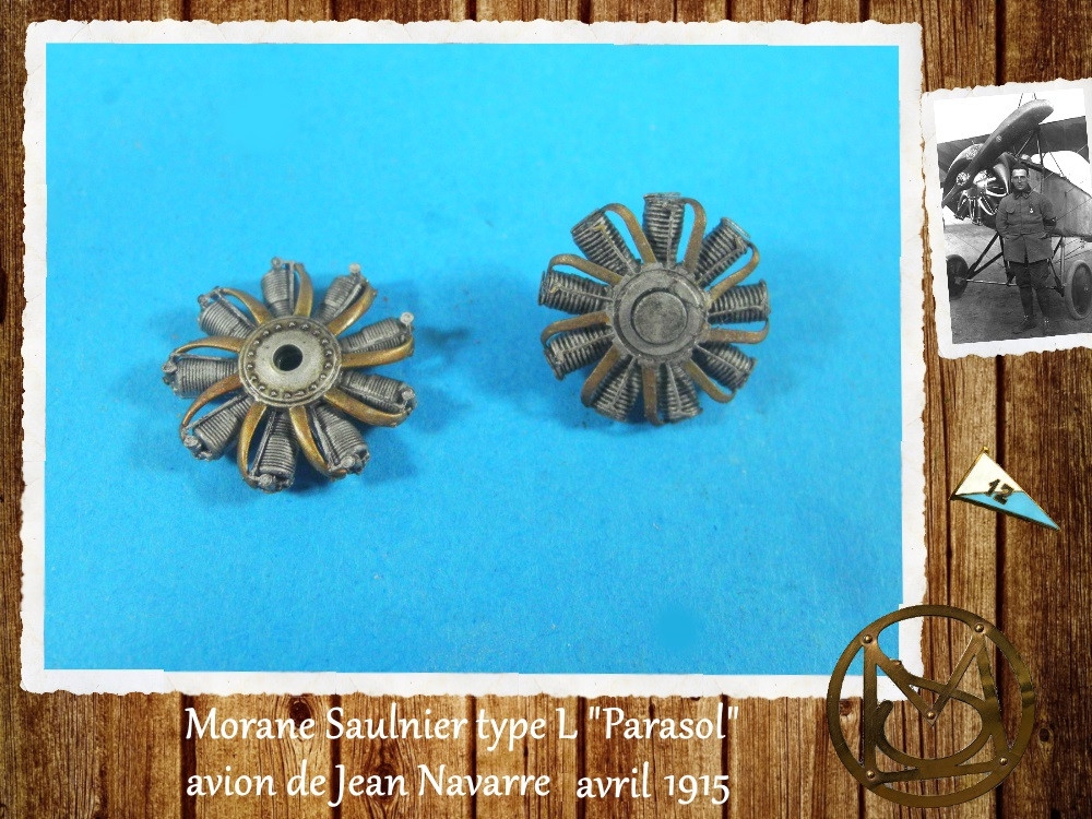

Here is the engine, an 80 horsepower rated Le Rhône 9C
http://commons.wikimedia.org/wiki/File:Le_Rh%C3%B4ne_9C.jpg
first parasols had 7 cylinder Gnome engine too...
Le rhone 9c was a rotary engine; you can see (and ear) one here: https://www.youtube.com/watch?v=atMn9s6m-j4
I have the box one and a newer nieuport engine of the same house.
here they are:
of course I will keep the newest one at the left...
Xan

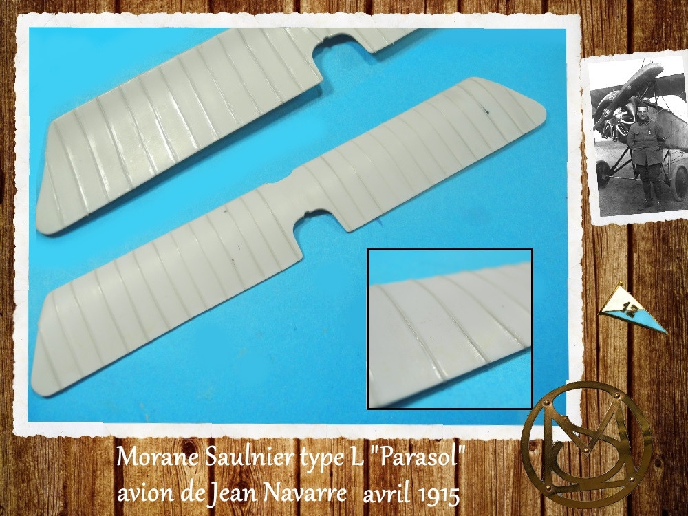

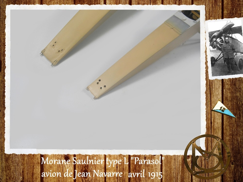

I'm whiting for thr 0.3mm drills to prepare the wing ; mean while I staid in the wing.
Morane Saulnier wing have a specificity, the rib seams are protected by wooden rods as it can clearly be seen in the musée de l'air 's type H:
http://www.mincbergr.net/index.php?page=morane-saulnier-h
this system appears also in the type N:
http://albindenis.free.fr/Site_escadrille/Ecoles_Avord.htm
as in the type L, wich concern us:
http://asaviateurs.pagesperso-orange.fr/sesavions.htm
I represent it with stretched plastic (plastique étiré?)
There is still work to be done, sand down, surfacer etc, but I am quite satisfied with the result...
Xan

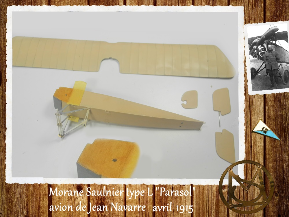

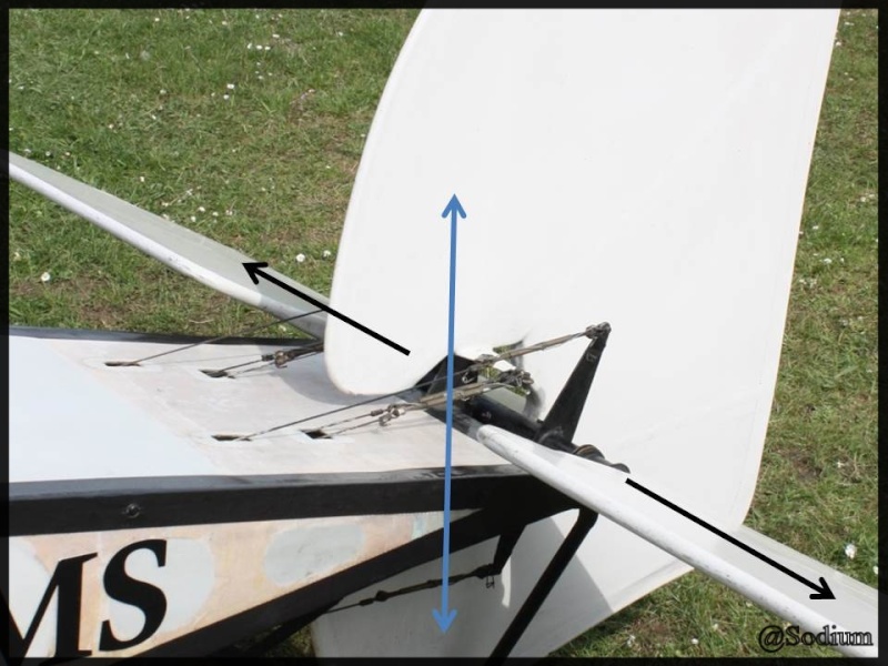

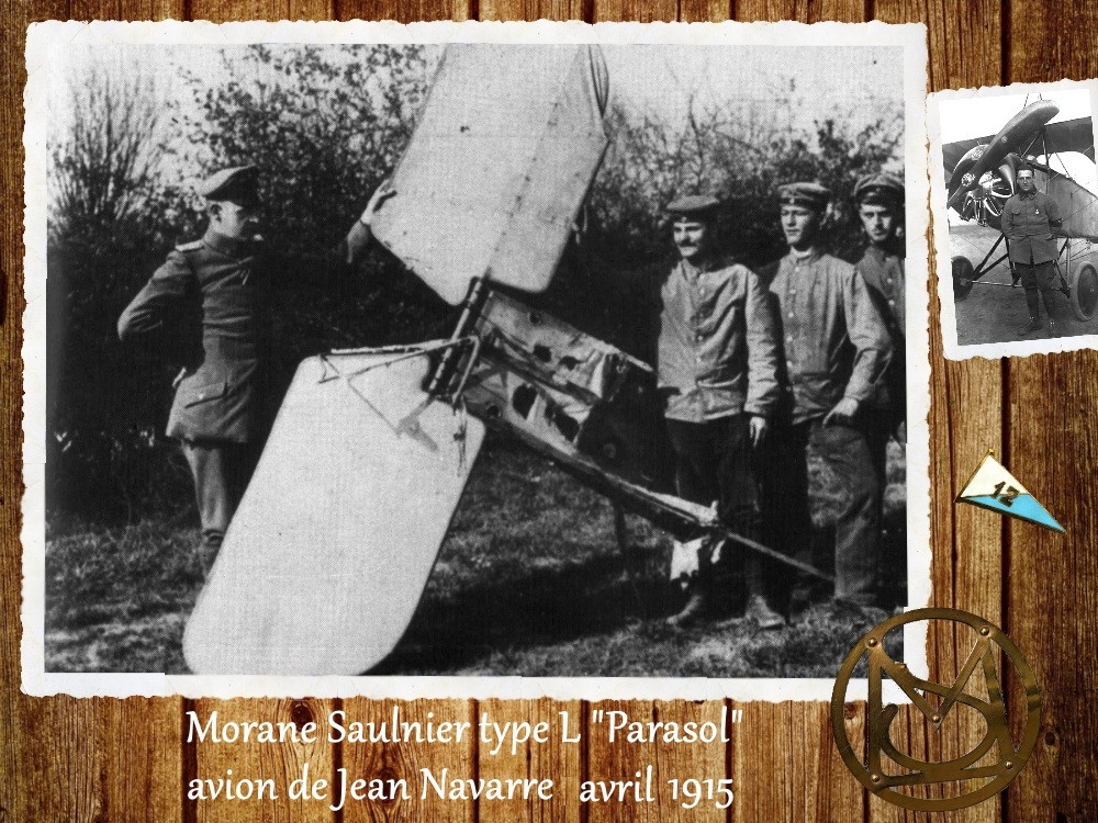

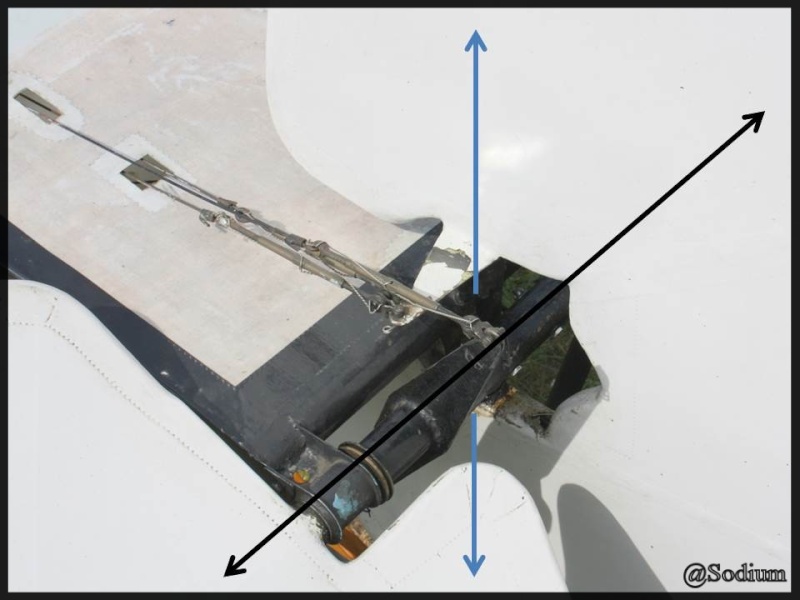

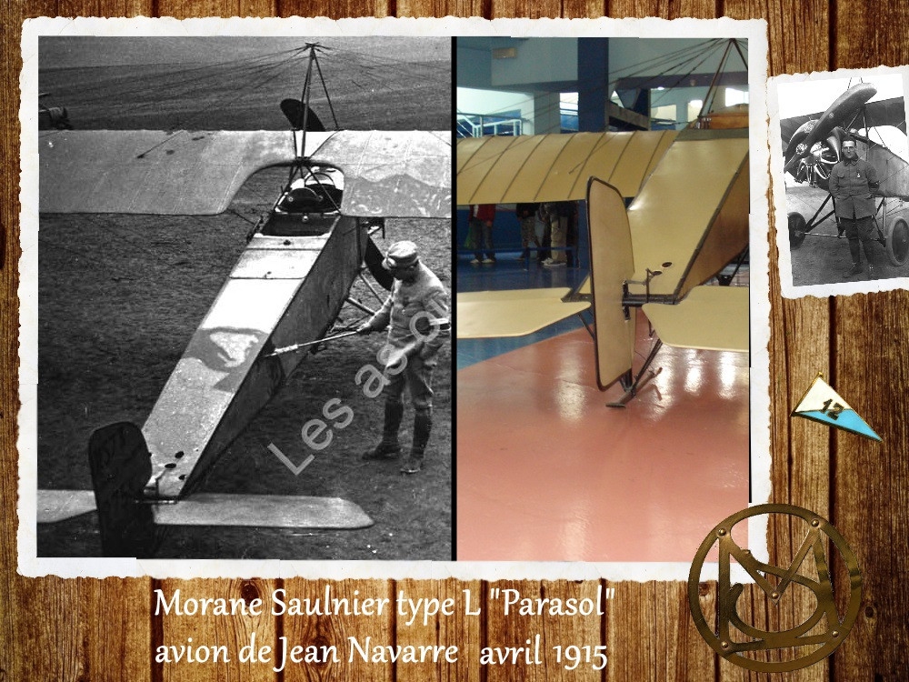

Well it's the empennage turn.

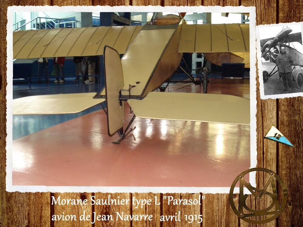

here is the best pic I have:

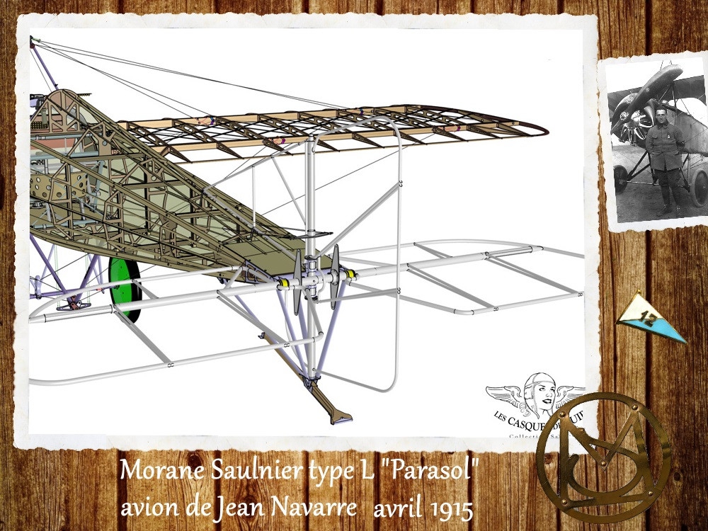

the principal interest of this pic is to confirm us that it's the same system the type H abd type N; forthose one we have more information
for the type N,this 3D draw fom the "casque de cuir" website:
and for the type H this pic from the musée de l'air plane:

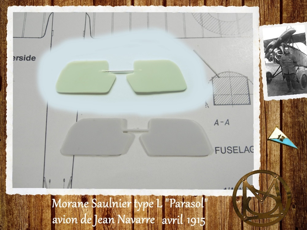

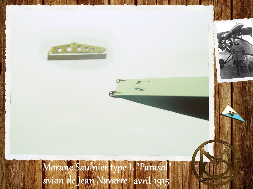

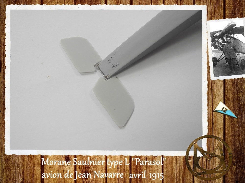

First of all I cut off the plastic axe to remplace it by a metalic one:
for the 4 attachments I use rest of a spitfire photoetched and cut them to give them the good form
this is the result (damned macro)
here is the final result:
the empennage is not yet fixed because I have to add the cranks.
The photetched cranks was adapted to the plastic axe. But with the new one, , I have better to rebuilt them in photoeched , making really losenge with an hole in the middle.
But gosh, no more drills! I wil have to wait the post man...
For the rudder I think the axe is where I did the red line , but I have to think more the best way to do it...

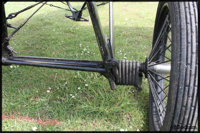

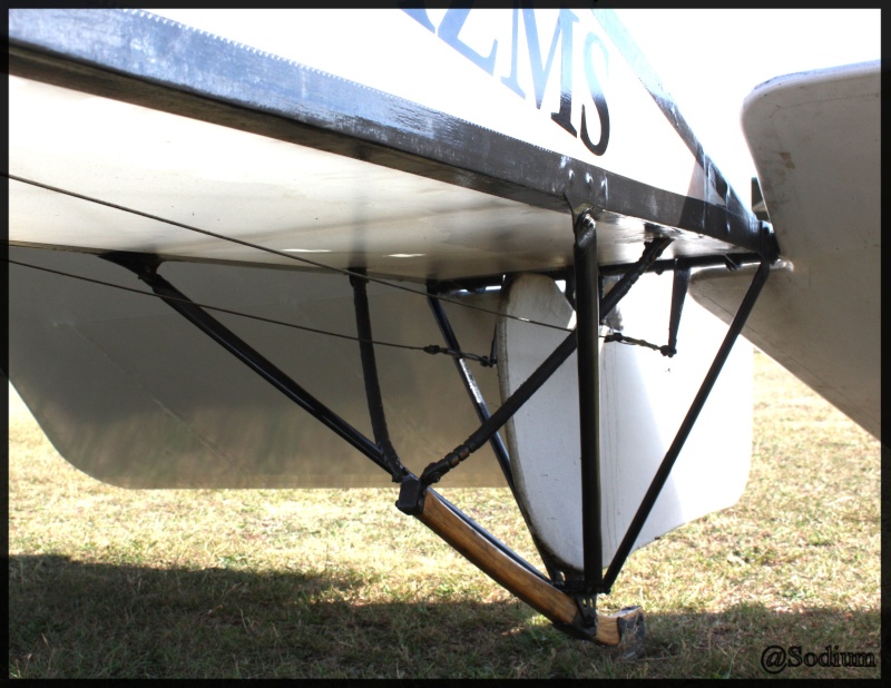

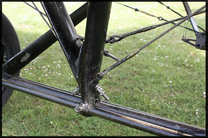

Thanks a lot Sodium for those pics. I imagined something like that...

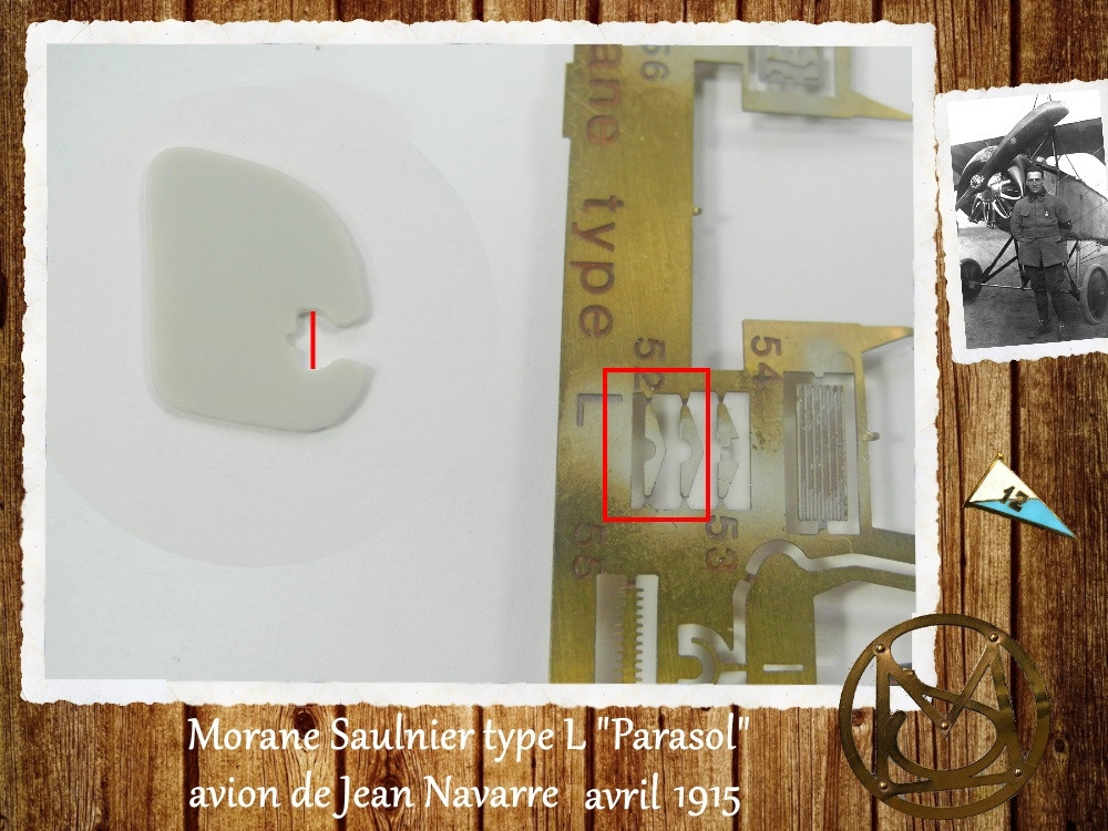

Today a little work:
as in the pic of the echarpe blanche replic, Eduard gives little photoetched rectangle fot the holes inn the fuselage for the empennage commands
locking at the pics (type H of the museum and old type L picture), I saw they were much more big and circular:
when I started painting the fuselage in fabric color gunze H316 randome, the peint put in evidence the ocean of glue I used to fix the photoetched parts.
So I decide to take it of I do it more conform to reality (even is paralelism is quite strange)
I received the 0.3mm drills, I'm going now to do a plenty of holes in the wing!!!

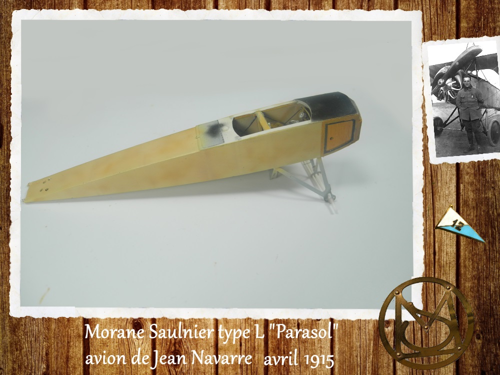

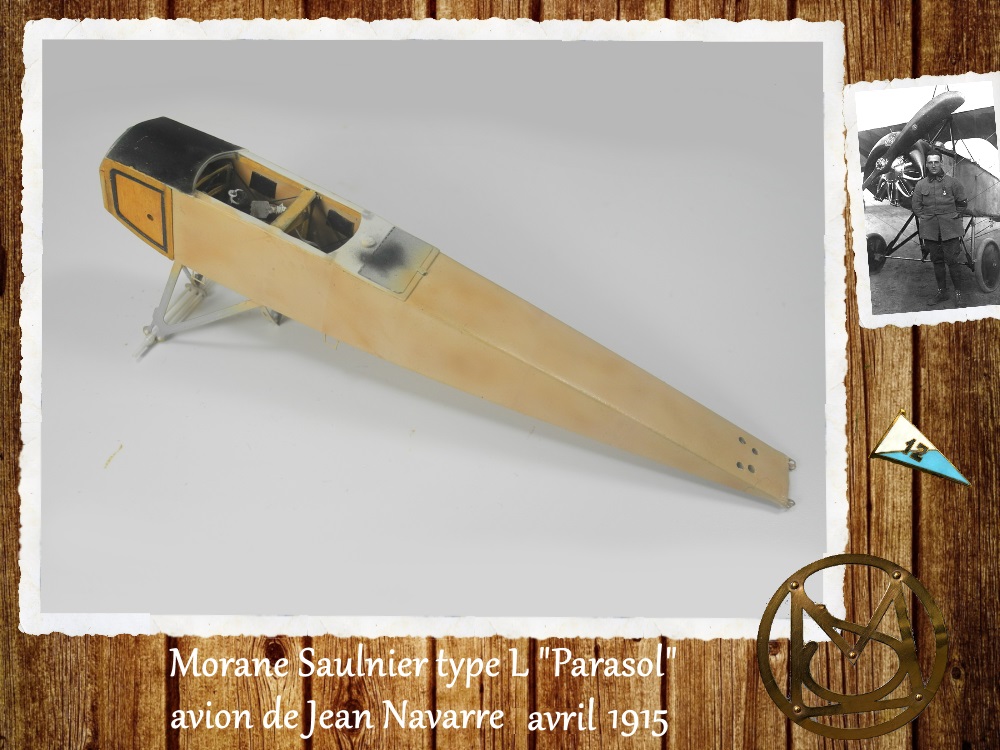

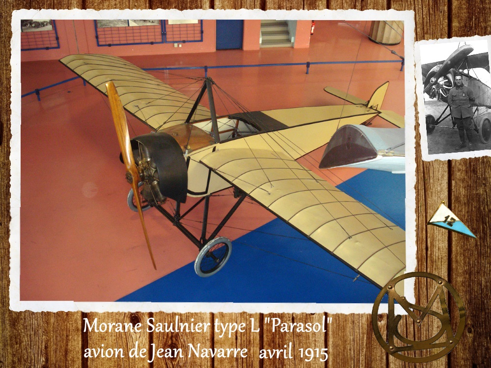

Apicture just to watch that the painting goes on:
fabric : gunze H318 radome base
wood pannel: Prince August ocre yellowfor the base  and oil raw sienna
Metal panel under the engine: alclad black alu
Xan

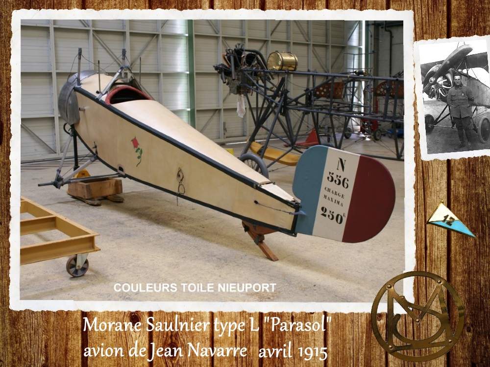

Speaking about painting , we have a parasol autochrome:
The color are quite pale (the fabric as the the wood pannel)
I prefere to take as reference the MAE museum typa G as their Ni-11.
I tried to represent the varnish not spraid out in a regular way., like the Nieuport fuselage fabric...
for this i used Gunze H66 quite diluted.
I went on the pannel wood too...
Xan
