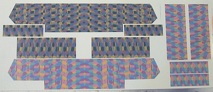

I've slightly lightened the lowerwing lozenges. Then I had the idea to print a dedicated sheet for Böhning's a/c, that would already include the rib tapes. For that, I've scanned a 1/72 plan which was used to set the correct spacing between rib tapes.

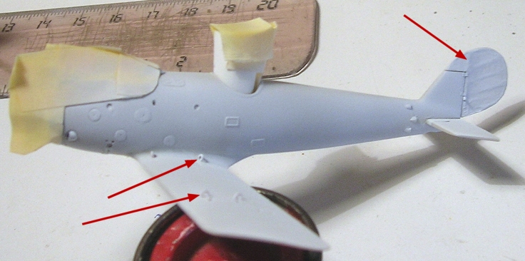

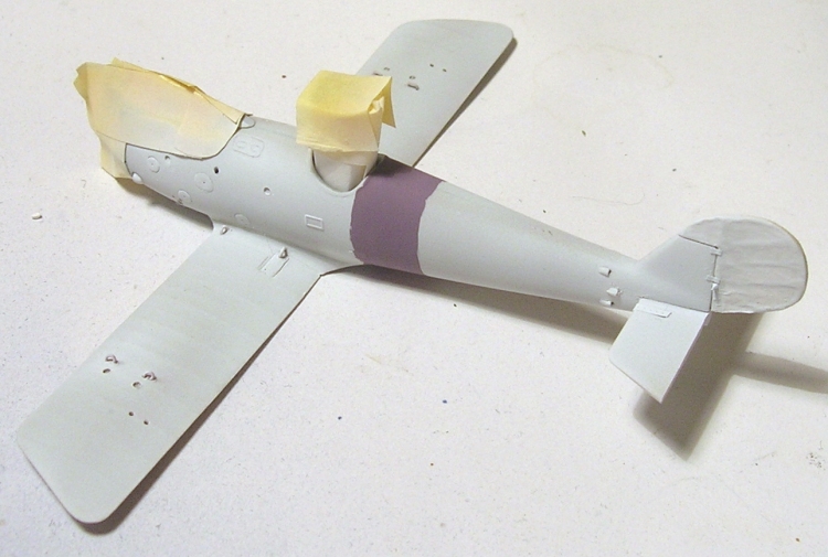

Stark's D-III has received it's coat of matt white, intended to make the following aluminum coat flatter. Hooks for the wires are already in place. This aircraft has the scratch-built rudder that integrates rather well:
Unlike the Albatros D-V on which I used tan as an undercoat for lozenges, this time I used ivory in order to alter the lozenge colors as few as possible:

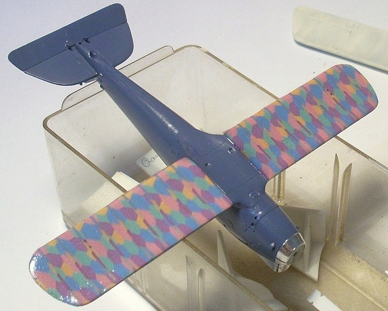

Then the lower wing has been masked, and the fuselage was painted with a dark shade of blue (Humbrol 144+25)

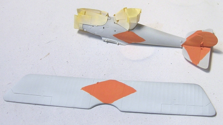

On the two other birds, the color areas were roughly painted and will be masked prior to spraying the aluminum dope:

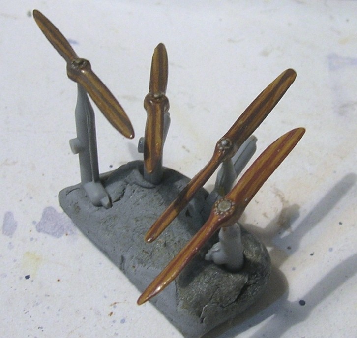

The props are almost finished (only the makers' logos are still missing). I tried different shades of brown, and my favorite combination is on the foremost prop:

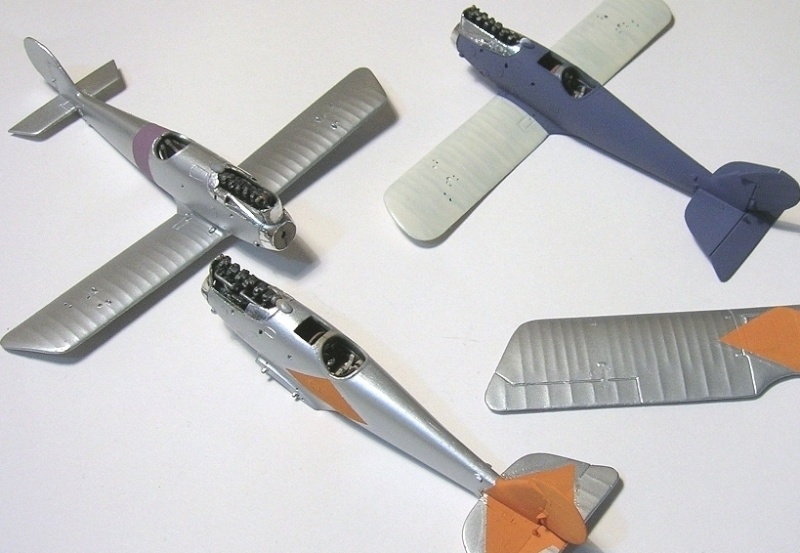

The three fuselages after i've sprayed the TS30 aluminum dope and unmasked the colored areas. The differences between the painted airframes and the metal panels is visible. I will add a coat of satin varnish on them to take the scale effect into account.

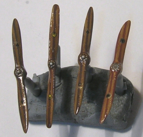

Props after they've received their makers' logos and a final coat of Future. The second from the left is for sure an Axial one, as the logos are visible on time pics of Pfalzes. From their shape, the others should be two Wolffs and a Garuda (or Niendorf maybe, not sure).

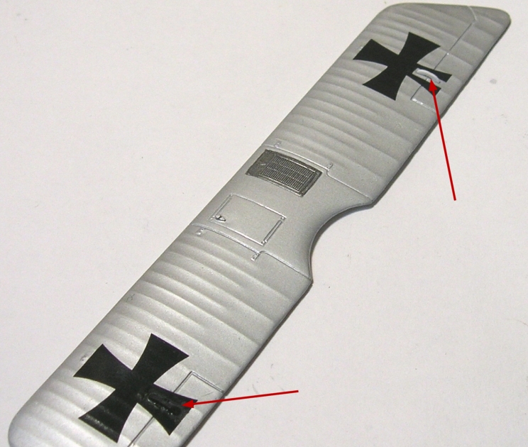

Stark's upperwing; The radiator has been painted gunmetal then drybrushed with aluminum. Horns have been scratch-rebuilt using slices of a tube portion. I've cut the crosses rather than applying them onto the horns (up) and then a touch-up of black paint to fix it and paint the horn (low):

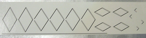

The "D-IIIa" box includes the s/n and crosses for Hans-Georg von der Marwitz's plane, but you have to paint the orange areas yourself. I've printed the black outlines using a scanned 1/72 plan as a template:

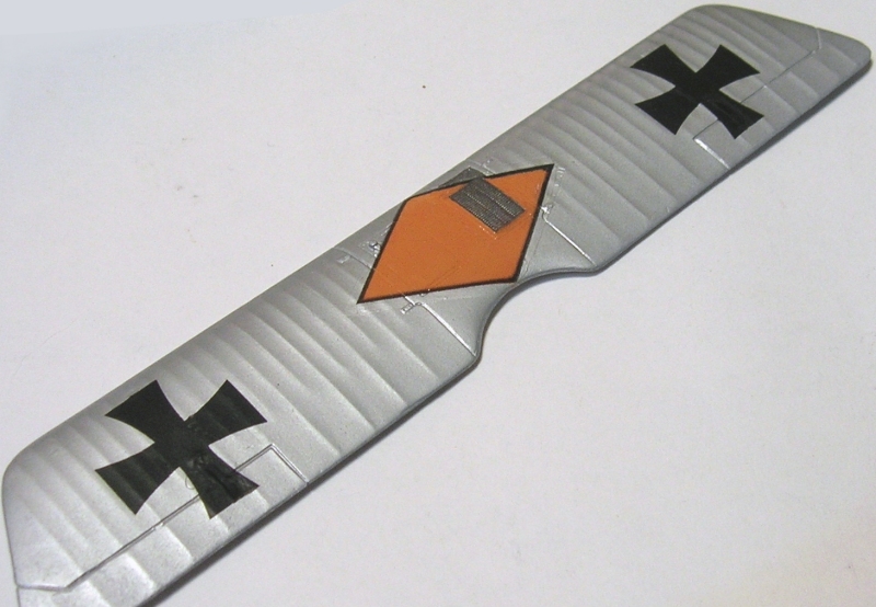

The black outline is applied on the upperwing. Then I put the crosses. The decals are crap on this sheet, the crosses desintegrated when I took them out of water. What you see here are puzzles of black crosses and black paint touch-ups...I will have to remind to spray a coat of varnish on the decal sheet in order to be able to use the rest of it.

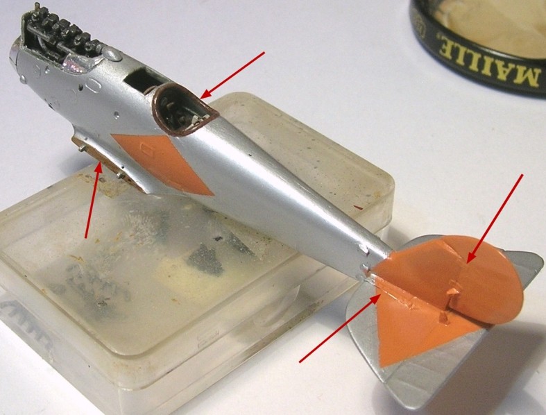

Marwitz's D-IIIa's fuselage after a good coat of future and a few addings: the wing roots have been painted in ply color, the cockpit leather padding, leather-brown. The adhesive aluminum parts are visible: rudder hinges, stabilizer reinforcement plates.

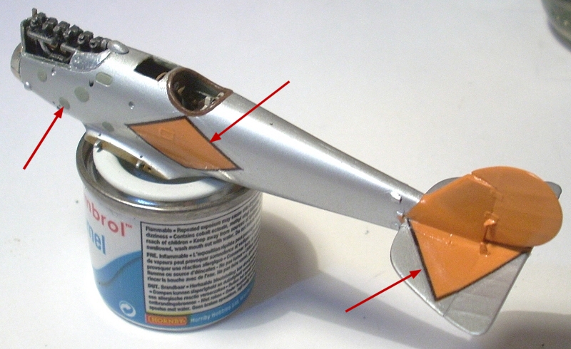

When I put a coat of Future to secure them, the repaired crosses went into pieces. I'm afraid the rest of the sheet will do the same...So I've reprinted all the markings for this very aircraft from a scanned version of the sheet. (I could also have used the image of the decal sheet you can find on MAC Distribution's website).
I put the black outlines on the fuselage, but the black surrounding of the rudder and fin edge will have to be hand-painted. The rounded hatches have been overpainted in grey-green.
I still have a lot of work with the decals on the three birds. I've already put my home-made underside lozenges on the blue aircraft's lower wing. The pre-printed rib tapes will allow me spare a lot of time:

I really like seeing what you are doing here. Bad luck with your disintegrating decals, but you are coming along nicely. The black surrounds of those diamond markings look very convincing.
