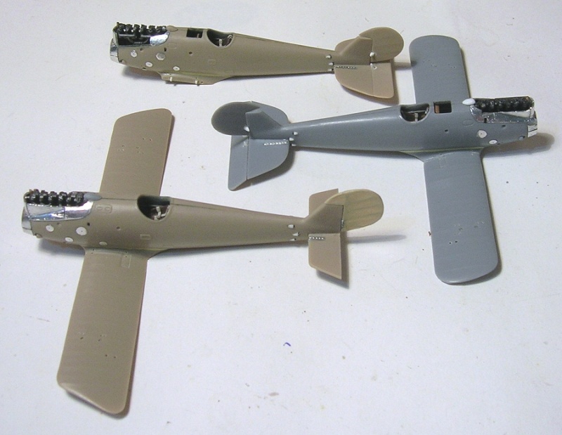

Attaching the lower wing to the fuselage is tricky, the fitting being poor. To get a correct alignment of the wing, I've added a plasticard guide (the white bit on the rear) and also had to add plastic at the front of the lower center section:

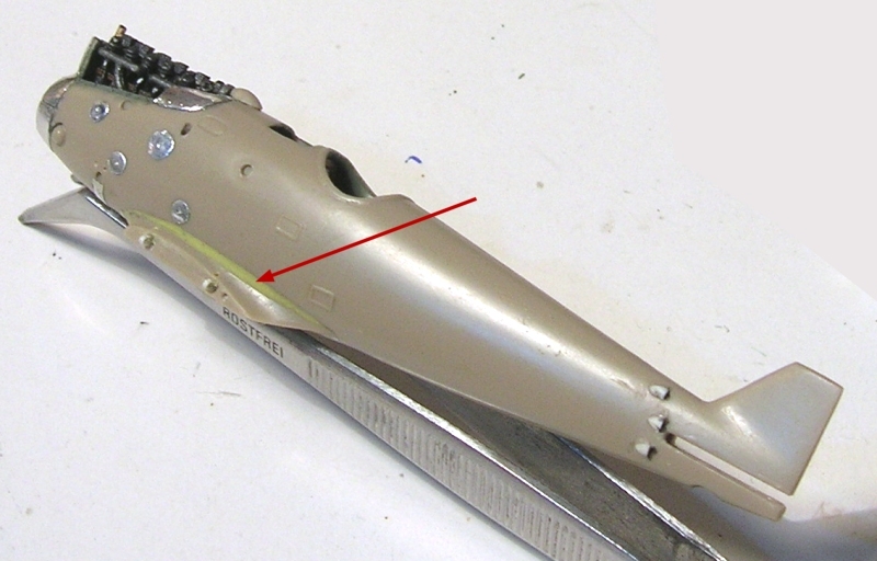

Lower wings have been cut away and removed on von der Marwitz's a/c, and wing spar attachment points were added. The joint between the fuselage and the karmans leaves a crisp line that will have to disappear.

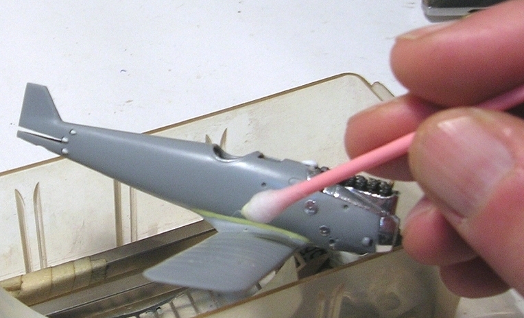

I used Milliput for this, and wet swabs (is that the right word??) to smooth it:

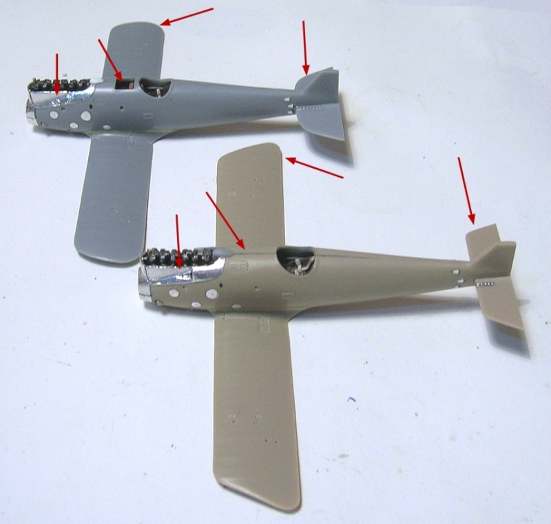

The tailplanes were added. I've also used adhesive aluminum tapes to rebuild the reinforcement plates. The arrows show the main differences between a D-III and D-IIIa.
Next, all three planes had their rudders and elevators installed, except Stark's machine for which the elevator will remain uncovered and will be put in place after painting:

Incredible job. I do not know what it cost you to achieve such detail in this small detail, but I can only say to keep still because your project turns into a small shedyorar. I have a question for you: I saw that in the joint smoothed kit with cotton buds, but with what you've soaked?

I also found out that the shape of the rear end of the karmans is wrong on the MAC kit (it's closer to that of a Spitfire than a Pfalz D-III), so I had to sand the lower wing rear lowerside to get the correct shape back.

Frame, the cotton buds were soaked in water. Water allows to cleanly smooth the Milliput putty without leaving any traces, and I wanted above all to prevent any further sanding to preserve my aluminum hatches.
