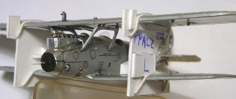

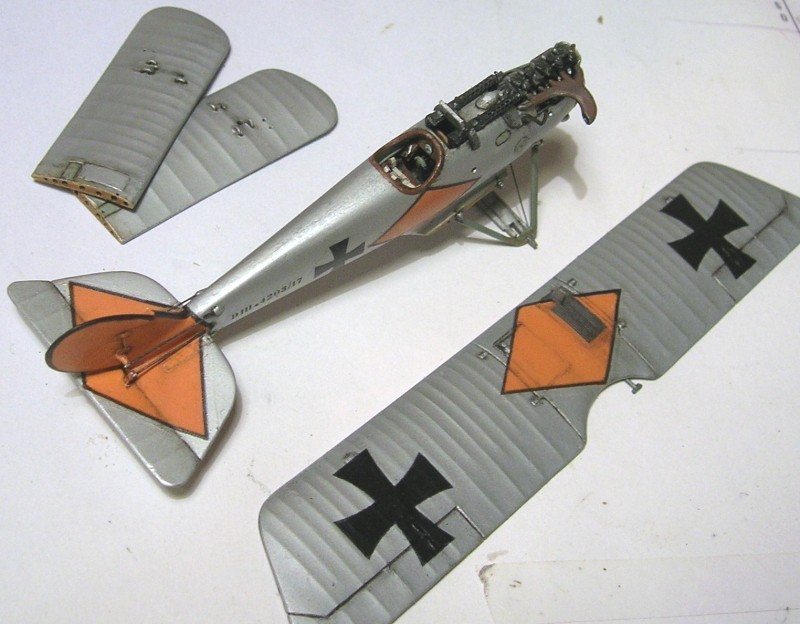

Marwitz's D-IIIa with the first step of the weathering (oil wash), it's landing gear and the rear radiator pipe in place. This one is almost completed since only the prop and wheels will have to be added after the flat varnish coat:
The most important step for any biplane: attaching the upper wing. The kit still with the plastic templates, since only the cabane masts are glued. Big issue with the outer masts: when the upper wing is properly positioned for the cabanes, the outer masts are too long. I have to sand them and reshape the tips. This bird also received an oil wash:

yes, on time pix, those birds do not look very dirty. Moreover, the fuselage, fin and karmans are one-piece so there are not many panel lines to catch the usual dust/oil mix. I will just add a few streaks with dry pigments behind the radiators and around moveable surface hinges.
I had to modify the outer masts so they fit in place. I don't know if their shape is wrong or if it's me who modified the lower wing dihedral during the early assembly stages. All masts are glued on the D-III and I could remove the templates, which are now between Bohning's D-IIIa's wings. I will post pix when both are done.

Aren't you afraid of scratching the wings surface/damaging the paint while using your selfmade template?

No problem, they're made from thick plasticard which is just held in place by elastic threads. And all surfaces are well protected with a coat of Future. The only thing you have to take care of, is that their shape (seen from side) allows to remove them when the masts are glued to both wings.

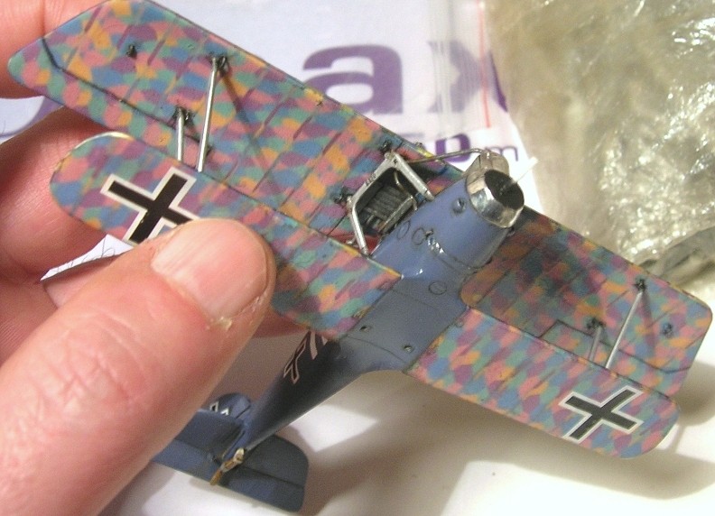

I removed the templates from Böhning's a/c yesterday night, now that all masts are attached. Just some touch-ups to do on the mast ends where paint suffered from sanding, and a little oil wash around the ball and socket joints.

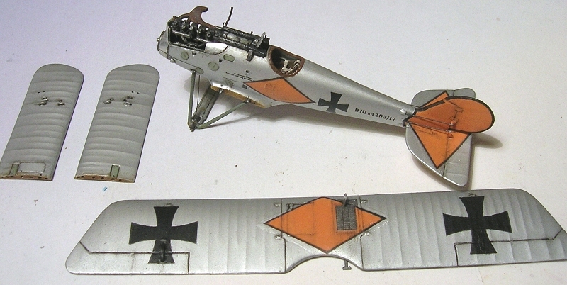

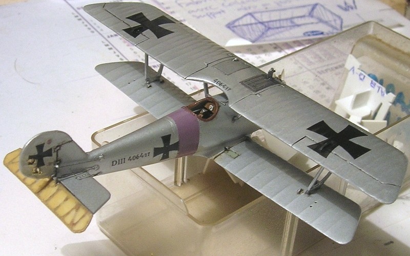

This view of the D-III shows the scratchbuilt elevator and its translucency.
I've done that plummery: on this pic can be seen the wing tank pipes, made from folded and shaped copper wire, then painted dark copper (I guessed they were probably made of copper or brass). It is pretty crowded between the fuselage and upper wing.
On the other side, radiator ducts are visible, made of lead wire and plastic rod, slightly washed with rust. The serial number can be seen on the mast, as well as the radiator shutter, its handle and rails.
A "dryfit" rigging attempt with 0.15mm stretched sprue. A bit out of scale but it doesn't look bad. If i got it well, there's no turnbuckle below the upperwing, the wire simply goes through and eyelet and goes to the wing root then.
Marwitz's D-IIIa has received a coat of flat varnish which gives the aluminum paint the final "Silbergrau" look.
I have also coated the metal panels with flat varnish which makes them a little less shiny, and gives them a better aluminum look at the scale.
