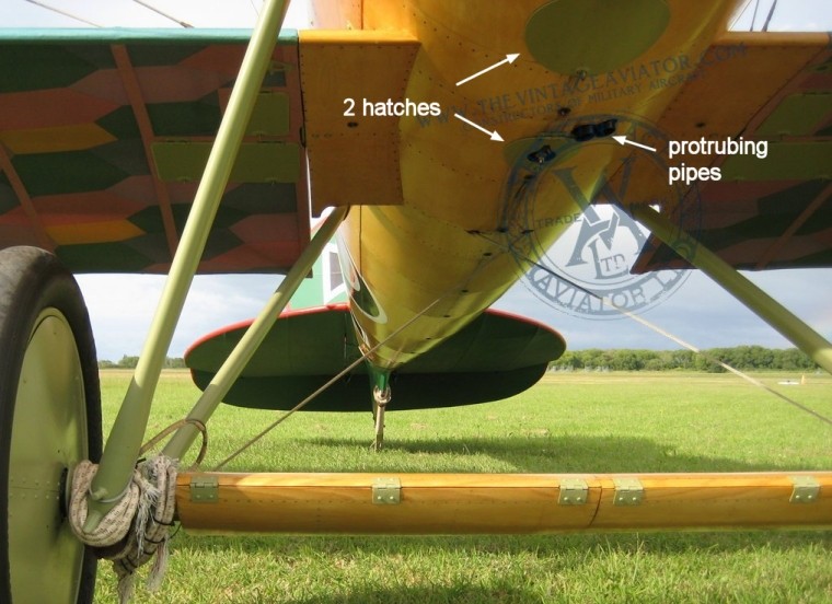

And thanks for your advices, Ian. As for the upper wing, one more problem is the fact that the radiator will be very close to the seam with the right wing...
Quote

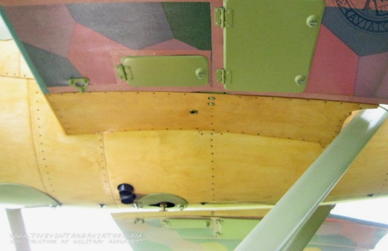

You will need to thin the underside of the centresection wing stub as it is too thick. Also the inspection panels that Roden moulded onto it shouldn't be there (Take a look at the DVa walkaround pics on the TVAL site).
OK, I was wondering about this rounded panel as the Windsock plan doesn't show this area. It is hidden by the wheel axle fairing. Yes I've noticed I'll have to thin up the center wing portion. And I will have to manage to add metal rods on each side to secure the lower wing assembly.

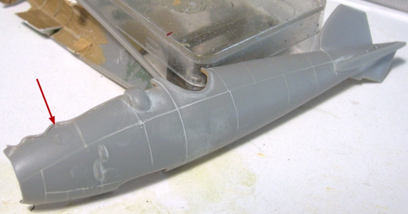

I've added the small "lips" to the engine cowling aperture using stretched sprue fixed with CA:

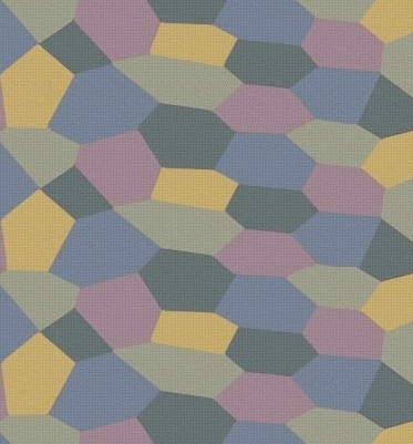

I've collected material and pics of preserved printed fabric to draw this sample in a paint program, adding a faded and fabric effect. Then I've printed that on a clear decal sheet.

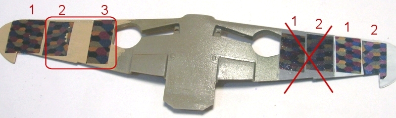

I've made a print of my latest lozenge sample and it's definitely too light, specially the blue and purplish-violet. So I think my previous attempt (the lozenges that were applied to the aft cockpit wall) seems the best I made and I'm going to prepare a ready-for-application print. I mean, rather than cutting slices you need to apply at 90° on the wings, I will build-up the full pattern for each wing in the paint program, and apply only one big lozenge decal on each, in order to reduce the count of decal seams. Is that a good idea or is it more difficult to apply wing-size decals?
I was looking for something else, and found evidence of the additionnal hatch that Roden has molded under the lower wing central section. Unfortunately it will be sanded away when the part is attached, to match the fuselage underside, so I'll have to rebuild it from adhesive aluminum sheet. Of interest is the gap between the right lower wing and it's root. Something we would find unacceptable on a model...

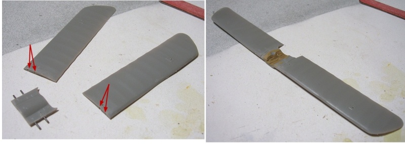

Here's some news. Firstly, I strengthened the lower wing attachment, as nothing was really provided for that. When I got a correct fit, I put the wings apart as they will be painted and covered with lozenges before assembly.

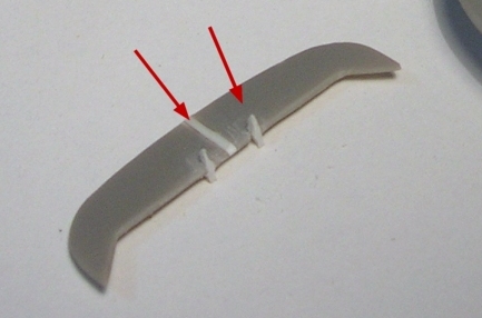

I did the same on the upper wing. I also filled up the gap around the aileron controls, the kit being definitely a D-Va. I added the small plate which covers the aileron pulley on D-V's:
After that, I noticed that the elevator had become too narrow after I glued the stabilizer separately, so it required to be widened by adding a piece of plastic that was sanded in place. The control horns were rebuilt, being one-piece (up and down) on each side:

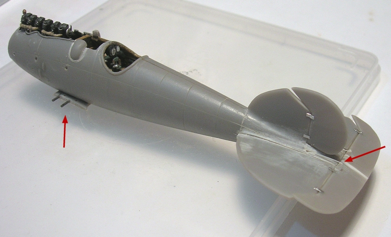

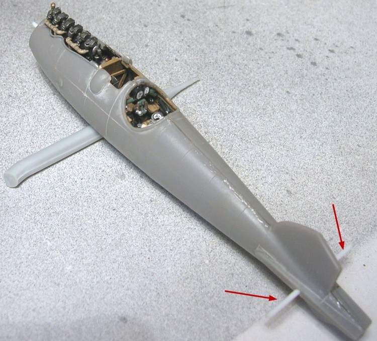

Then, the lower wing central section was attached to the lower fuselage, followed by the rear control surfaces. Control cables were added as well as aluminum hinges:

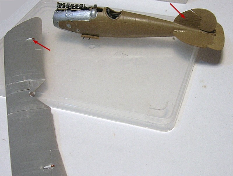

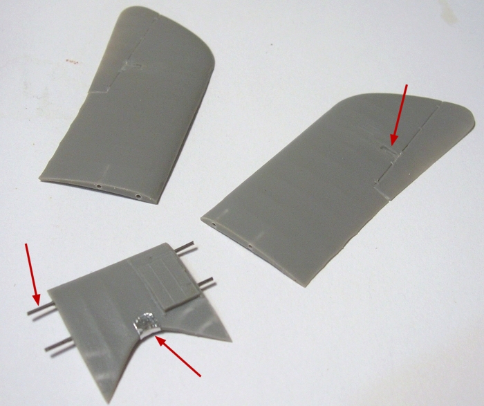

The first sub-assembly is done, that is the fuselage and tail, that will have to be painted before going any further. I applied paint undercoats: medium brown for wooden parts, aluminum for the cowling and gun fairing, and tan for control surfaces.  I painted wood veins on the fin only, as the wood will remain visible around the serial number. Besides this, I assembled the upper wing and scratchbuilt the control horns and fairings that are typical to a D-V:
I tested several samples of home printed lozenges to check what they looked like and what should be the correct undercoat color. The grey undercoat makes definitely too dark lozenges. Colors look a little too bright IMO on a white undercoat, so I think light tan is the best option. The version marked 1 has a too dark shade of purplish-grey that looks rather wine-red (although there is a Fokker D-VII replica that has lozenges almost this color). As a conclusion, I still hesitate between 2 and 3, but it looks like the polygons are a little too big in "3", so "2" is likely to become the definitive option.
