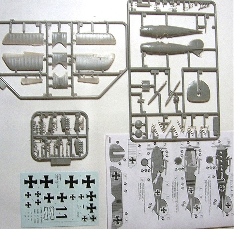

I started with collecting reference info (thank God, Windsock is among us), and my first task was to find the most accurate kit. I compared several and finally chose the Roden issue for the following reasons:
-first of all it almost perfectly matches the WD 1/72 plans
-accuracy of bent up aileron tips (compared to Revell or Eduard kits)
-better fin/fuselage joint
-detailed engine
-optional propellers (although only 2 are provided, it's already better than those kits that come only with one...)
Negative points:
-upper wing molded in 3 pieces, which will require some strengthening and adjustment
-lower wing in 2 parts, without anything provided to attach it to the fuselage
...but I have some experience with short-run biplane kits, and with drilling holes or adding plastic bits so the whole thing stays together.
-ah, one more thing: the Roden kit is a D-Va, with distinctive features like additionnal reinforcement bars on the base of the V-struts, and D-III-type aileron wire controls. Nothing really difficult to modify to make it a D-V
This is what the kit looks like, although it would be better with a less blurry image:

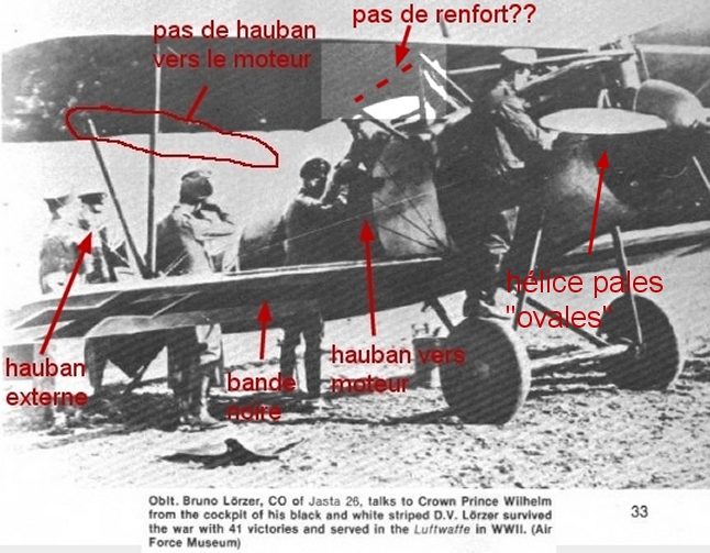

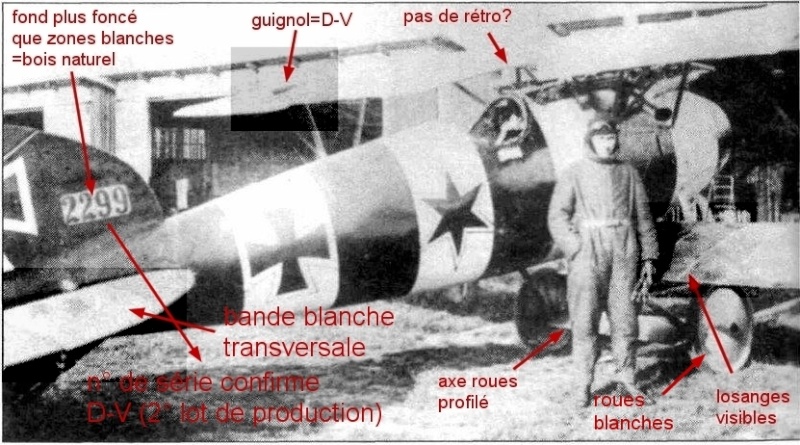

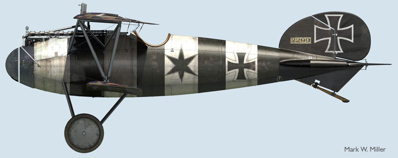

After reading a few books, I decided to make a black D-V with lozenge-covered wings, and found period pics of Udet's, Loerzer's, Kissenberth's and Jacob's mounts that would match this requirements. Jacob's plane was soon eliminated as I only found the photo of a wreck. I could identify it as a D-V from the aileron horns, but the rest is a heap of small wood and fabric. Kissenberth's birds are well documented but I needed a better-known pilot to stard with. Udet's machine is supposed to be a D-Va, has external aileron cables but no reinforcement struts, I found it suspicious. In the end there was Bruno Loerzer's D-V, the s/n of which is known, and I could identify most important details I know about so far (prop type, wing camo,  additionnal rigging, wheel-axle fairing). Here it is:
Period pics (sorry, the comments are in french but roughly describe the details I mentioned above)

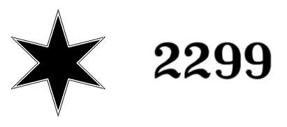

I couldn't find any decal sheet that includes Loerzer's plane, but as it consists mainly in black items (the 6 point-star on a white band, and s/n on an unpainted wooden area on the fin), I drew them in an image program and printed that on clear decal:

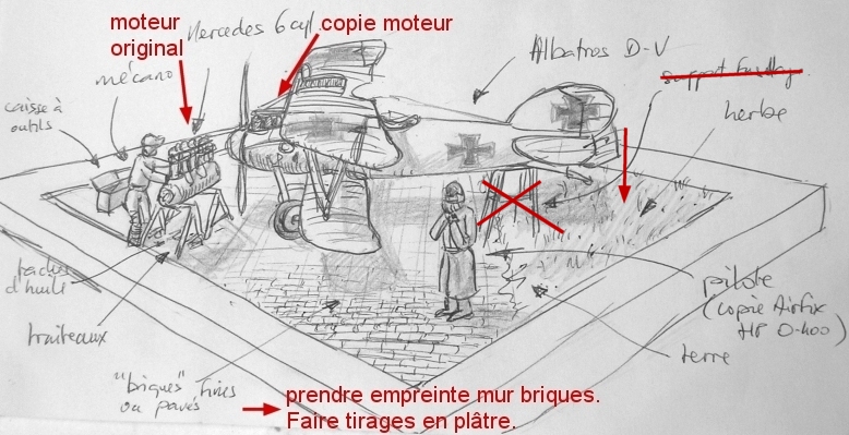

Since 2 engines are provided in the kit, this gave me the idea of building a small scene I made a sketch of:

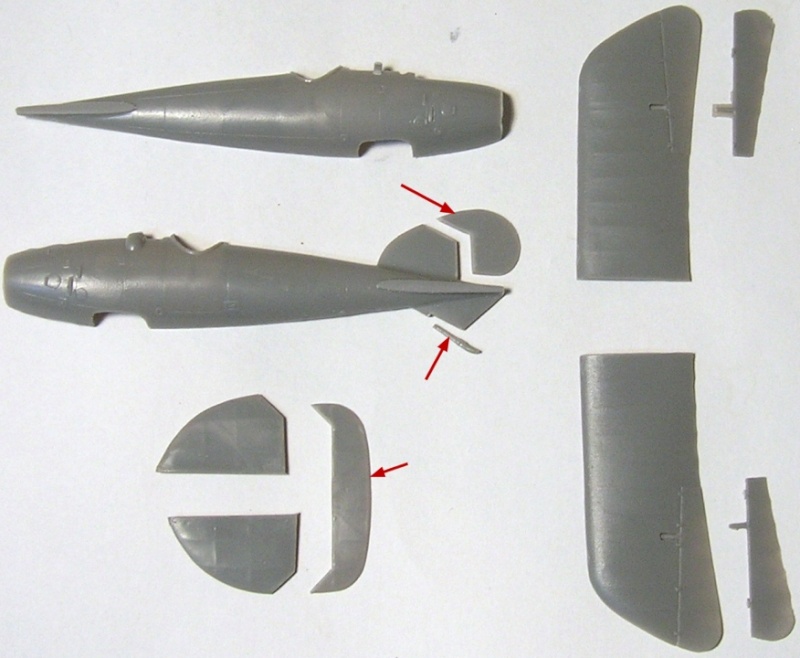

Let's start scratching plastic now. I started by cutting away the elevator, rudder and skid:

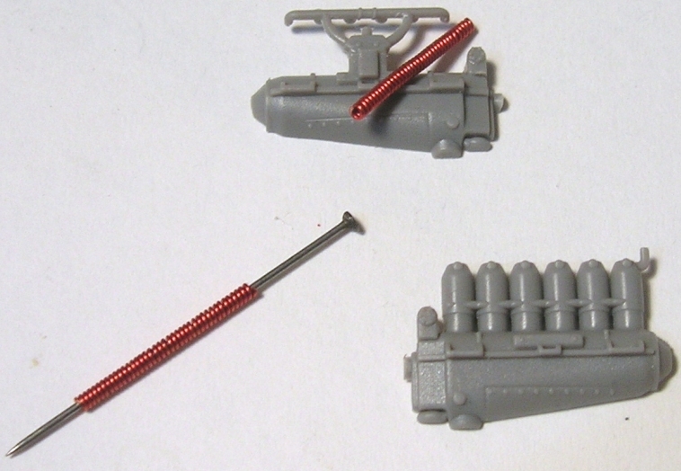

I put the airframe aside and noticed the valve springs were missing on the engine. I wrapped copper wire around a pin to make them (which is something most of you are probably used to do...):

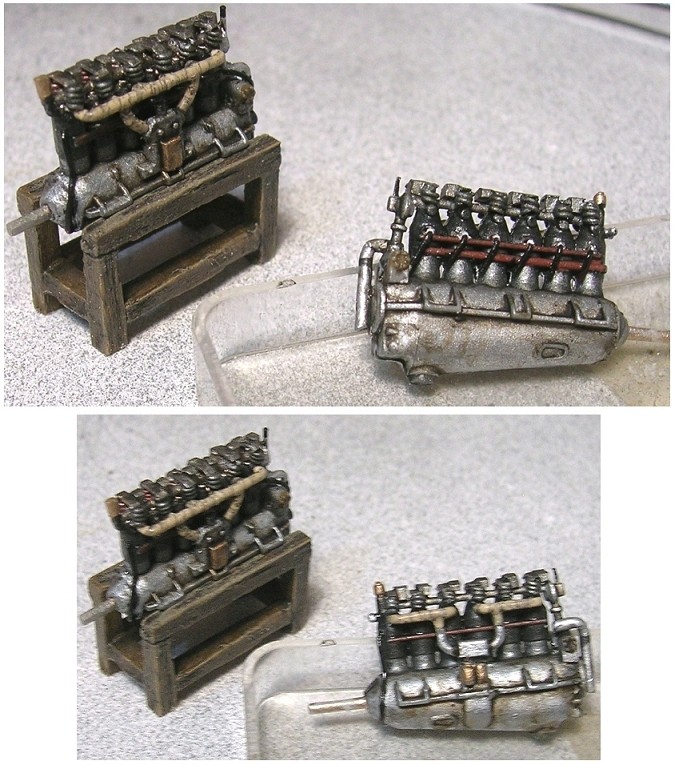

After having added valve springs, a camshaft, rockers, spark wires, a few pipes and further wires, I painted the 2 engines, built an engine stand from match bits, and used oil paint to give them an oily look:

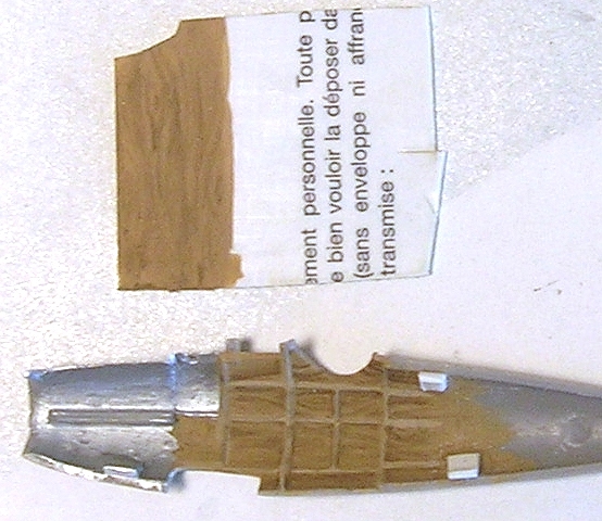

I then tried to give a plywood aspect to the cockpit, and painted an additionnal "wood" plate that will provide missing fuselage walls, dashboard and floor:

For your first WW1 model aircraft your work so far looks brilliant - love your engine!

 Regarding some of your "identifying marks" for the DV - not all DVa's had the reinforcement to the front of the interplane struts - some DV's DID have it retrofitted, so it's not a good indicator. Similarly, the upper drag wire was not on all machines, it may have been an addition made at the Squadron level?
Basically, if it has the little fairings on the ailerons for the actuators, and the control wires run up from the cockpit to the upper wing, it IS a DV. It would probably also have a small fairing over the spent shell chute on the left MG, which was more common on the DV's.
For wood painting in this scale, I find it very easy to overdo it. My own technique is to paint everything Clear Doped Linen (CDL) or similar, then brush the wood colour over that, but don't stir it properly! It will streak and look pretty good! (in my opinion anyway!) I use leather for the wood colour which works well with the CDL. A darker undercoat can be used for darker woods.

What Ian said -- the lines between the D.V and the D.Va (not even an official IdFlieg designation) are extremely blurry. The only real harbinger is the routing of the aileron cables (as Ian said).
Not sure if you care or if it will even be visible, but much of the inside of the engine compartment (which you have painted silver) was actually wood. It is often depicted painted interior green on the lower half.
I love the sketch of your vignette with your notes, and I can't believe you are attempting valve springs in 1/72 scale :)

Thanks! If I got it well, the only distinctive detail between a D-V and a D-Va is the aileron cables. Which means Udet's black D-V is a D-Va then, even without the additionnal wing strut. Good to know.

The valve springs are a little too big for the scale, but I don't mind too much with emphasizing (is that correct LOL?) some small details to make them more visible, guess this is particular to 1/72nd.
No I don't think the color of the inside of the engine compartment will be visible, I made some tests with the engine inside the fuselage halves. I scratchbuilt the oil tank though, just in case...Since then I been working on the pit, more pix soon.
