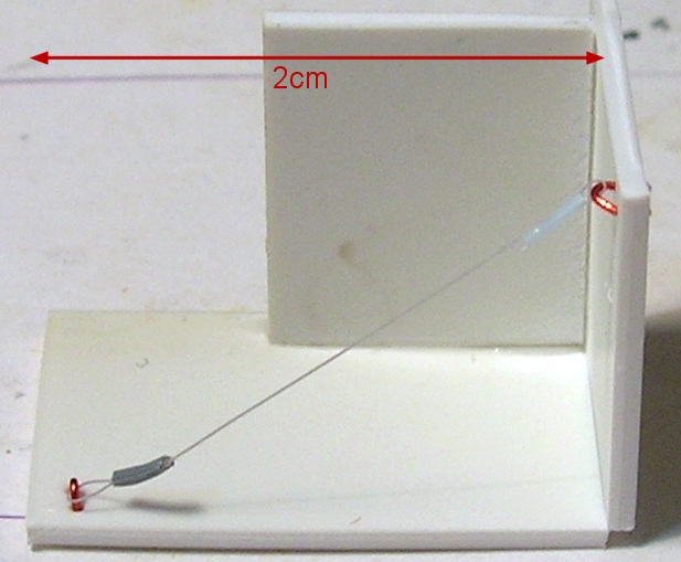

Thanks. I unfortunately had to revert back to where I was a few days ago, cos the brown "wood" undercoat remained sticky after 2 or 3 days, so I had to remove it.
But meanwhile, thanks to the advice a friend modeller gave me, I've been able to make a successfull test with building wires with buckles and stretchers. This is what it looks like:

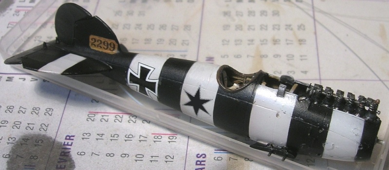

Current state of the bird:
First, the painted and decorated fuselage. A few paint flakes have been made but it's still waiting for furhter weathering:

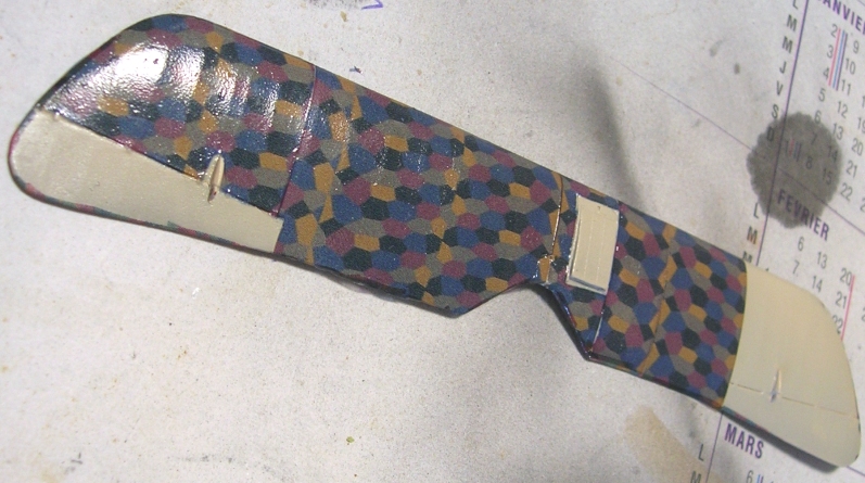

WIP on the upper wing. It was primarily painted in light tan to slightly alter the color of lozenges as it was the case on real aircraft:

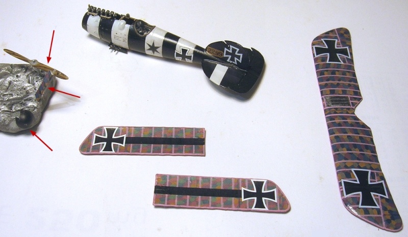

Now all sub-assemblies in their current state. The prop has received Wolff logos (from the shape I suppose it is a Wolff one), and the wheel axle fairing has also been covered with lozenges (it is barely visible beneath the prop). The third arrow shows the painted prop cone.

Very nice indeed, Vincent, I especially like the prop! I'm looking forward to seeing it all put together.

Looks really nice Vincent, but it is unlikely the fairing between the wheels would be covered with lozenge -- it was made of plywood.

Looks fantastic Vincent, the lozenge is very well done.

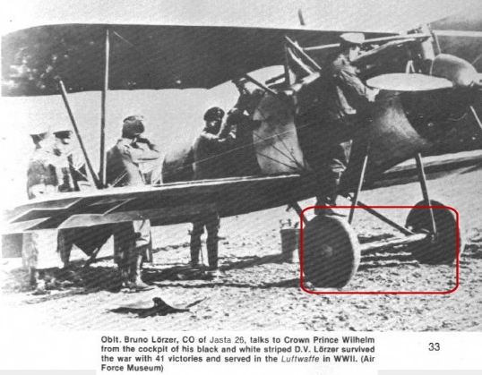

Bo, thanks for your info about the wheel axle fairing. The strange irregular shades seen on this pic
made me think maybe the fairing had been either covered with lozenge-printed fabric, or painted to look as such (since I know lozenges were sometimes hand-painted on fuselage parts). What d'you think?

I think that is spilled engine oil reflecting the light differently, not lozenge.
I'm with RB. Seems very unlikely that they would go to the trouble of painting lozenge on just the fairing, it would be an exception if they did. A prototype DV had a hand painted loz fuselage, but I know of no others.
There would be no reason to cover the plywood in fabric.
As RB points out, the fairing tends to collect quite a bit of oil from the engine, along with other debris.
Finally, there is a row of six hinges on the front of fairing, these are finished like the other metal bits, I think that's partly what you are seeing.
The fairing is actually four pieces, split in the middle right and left and wraps over the axle in clamshell fashion. Hence the hinges in front.

Thanks for the explanations. I knew that fairing was made of plywood but I didn't think about it being covered with oil or dirt...Mmmm, I have to think it over. It looks to me there is clearly a triangular and regular dark shade on the front top of the fairing, which looks rather weird as for oil spills...Don't know what to do with this now. :(
You have posted the photo while I was typing...From the location of the central hinges, it appears that what I see could just be dirt around those hinges.

It may be that it was painted to match the fuselage decor, now you are wandering into the realm of pure speculation (absent a better photo)...

Beautiful work on the striped fuselage and Lozenge! As for the axle cover I tend to agree with Bo.
