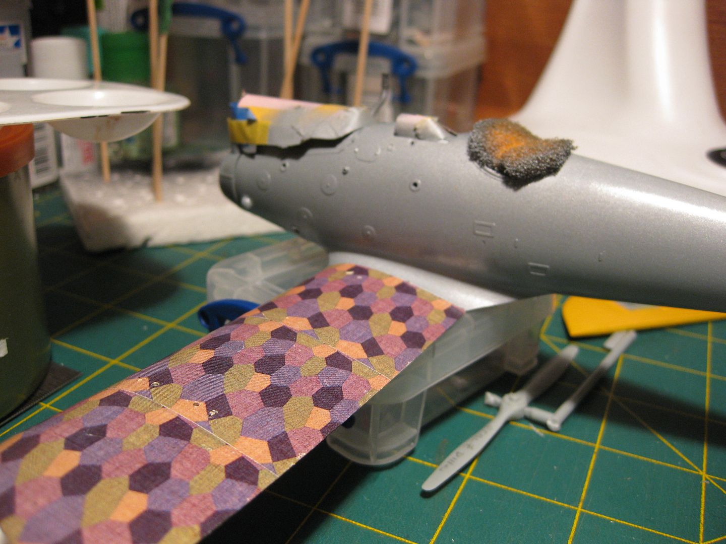

   The seam I had to redo was actually at the rear top where the fuselage fairs into the vertical stab portion, just a careless oversight on my part. The repair worked nicely and all is well. I've been more or less successful at solving the rib tape problem, the Microscale decal film eliminated most of the chipping in the cutting process and I've completed the upper wing, now labouring away at the lower one. It's a slow go as the chipping of the lozenge bolts I'm applying causes a lot of patching here and there. Slow and steady is the key, I hope to get that update with photos posted soon. :P

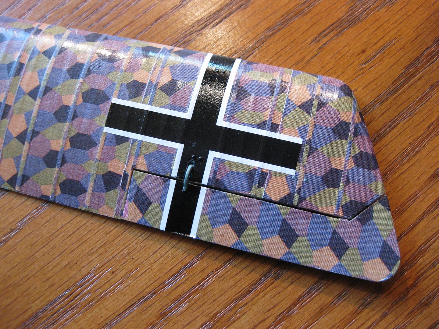

     Time to update this Build before the model is completed; there should have been one more since the last but I'll catch up on the progress here.

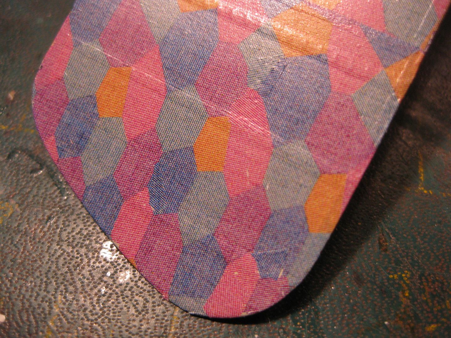

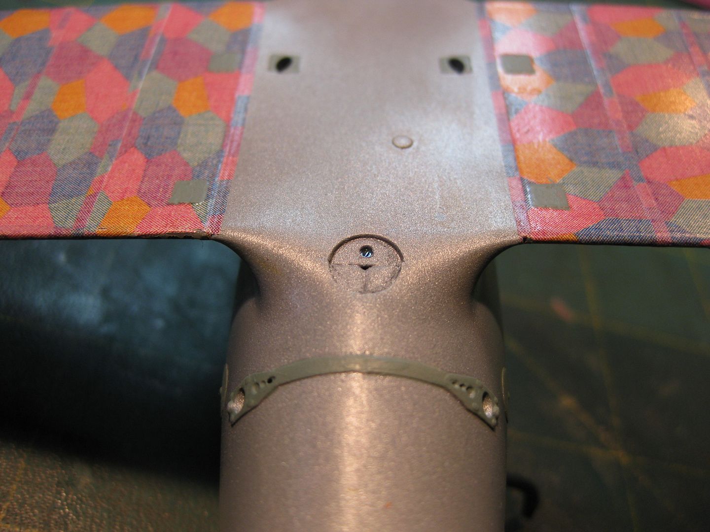

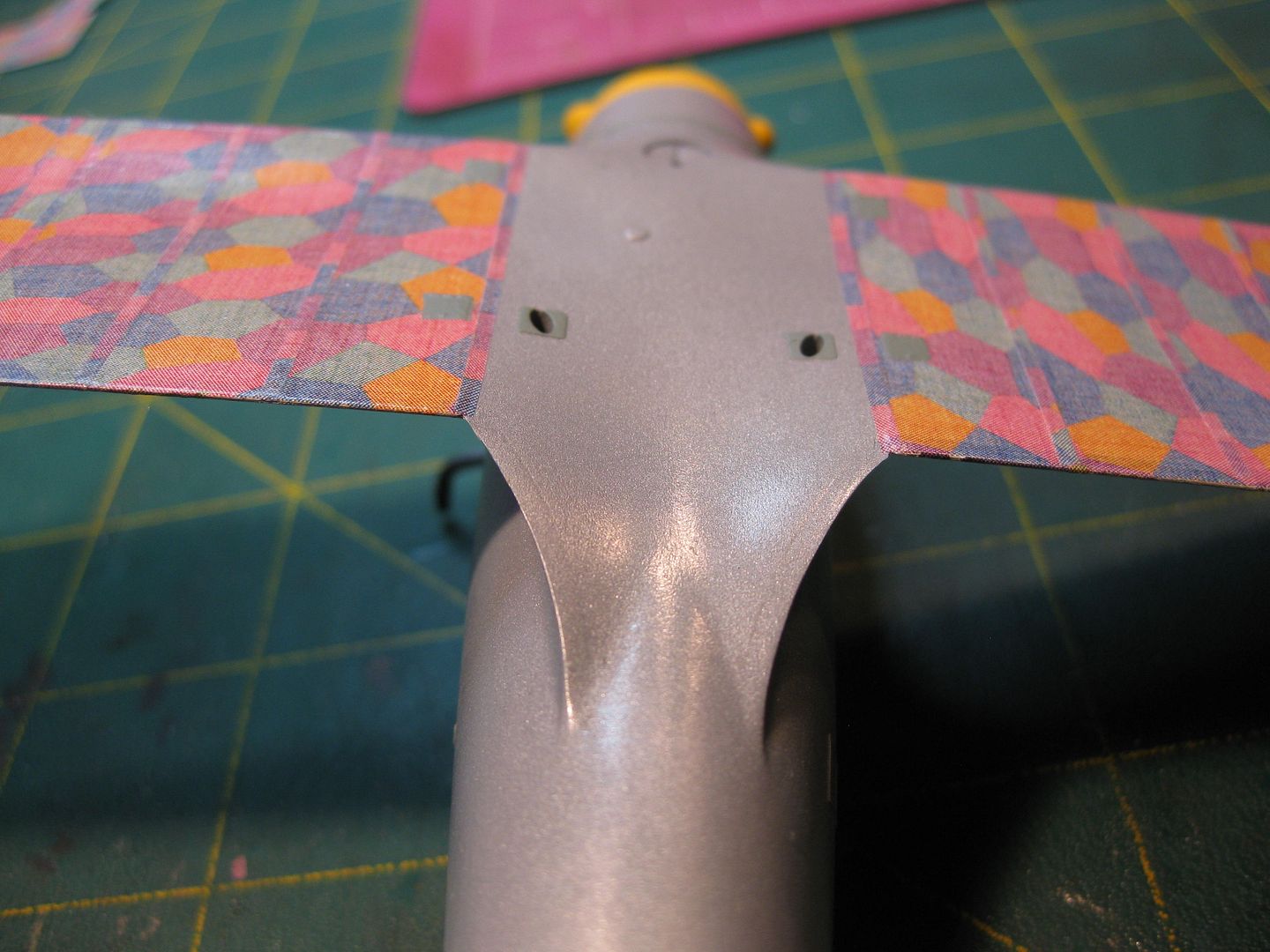

     Once the fuselage seam was repaired as mentioned earlier it was given one brushed coat of future to seal the finish and prepare it for decals. With that dried overnight the lozenge was started on the lower wings, the top already being underway.

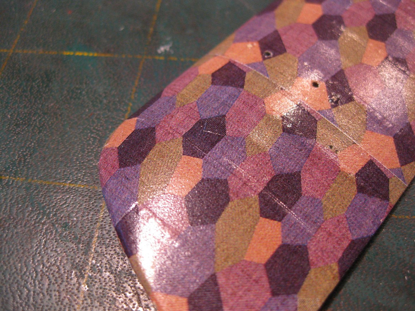

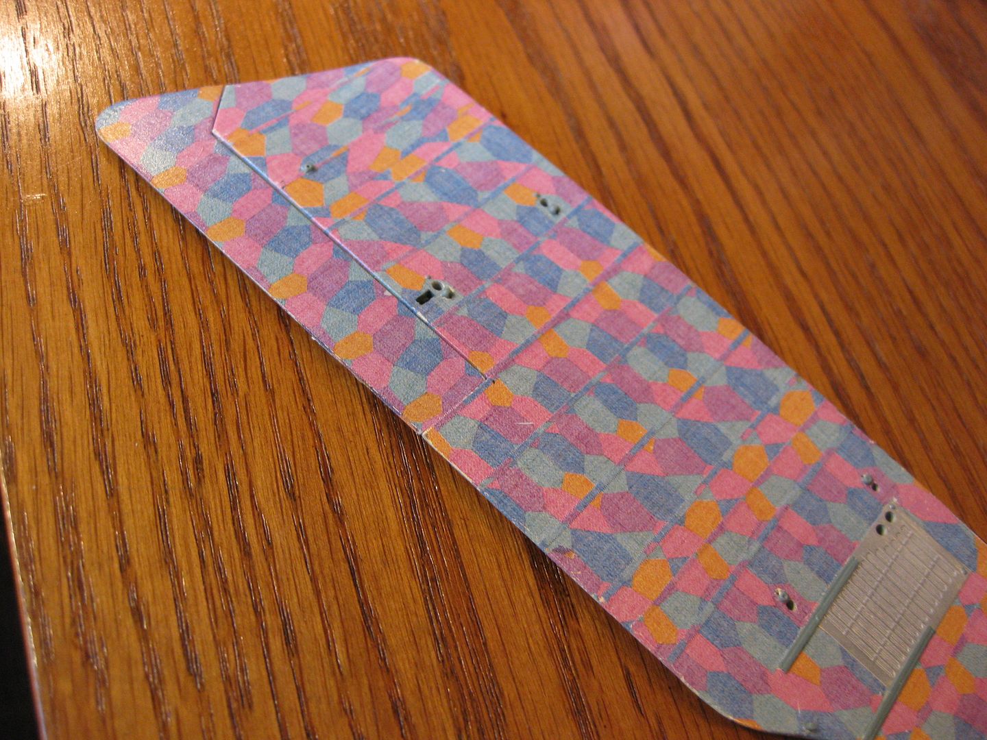

   Here's the lower wing completed, one brush coat of Future and ready for the tapes. Note the chipping close to the wing root, in this case of no concern as the strengthened walk panels will cover them nicely.

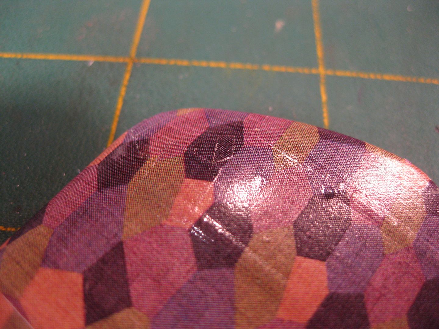

    The lozenge chipping led to a lot of patching which was less then ideal as the white decal base showed regardless of how sharp a blade was used or how many attempts were made. In retrospect applying decal film as was done prior to cutting rib tapes would have vastly improved the results. If you look closely you'll be able to pick out the patches...............
   All the rib tapes were applied followed by the decals on both upper and lower wings.

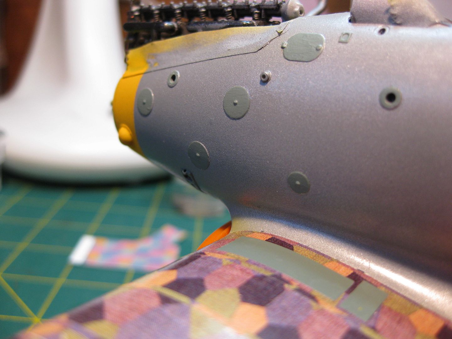

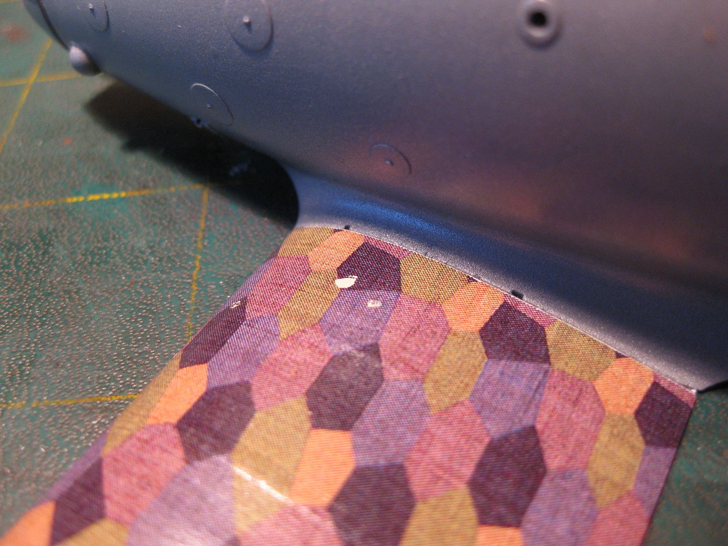

      At this point the fuselage round access panels were masked off for painting; the step Kick Plates and wing access doors having been completed already, the former with overpainted decals, the latter by hand brush. The panels had been carefully measured several weeks back and the masks were special ordered from our great entrepreneur, Bob von Buckle, alias von Mask Maker and produced on his Vinyl Cutting Machine. OUTSTANDING PRODUCT!!! They were so good I was able to use them twice from one side to the other and have more to spare then I used. Also, significantly, no lifting of the future top coat. I elected to hand paint the panels and fittings, hopefully the brush marks will be more subdued by the semi gloss finish coats when applied.
   Masks in place with paint applied.........................The wing step areas were done with scrap decal overpainted with the grey/green interior and protective colour with a layer of decal film on top and the yellow nose area masked and airbrushed. Model Master Insignia Yellow Enamel provided a good match to the Profile and three light coats provided solid coverage and colour.
and final results...............

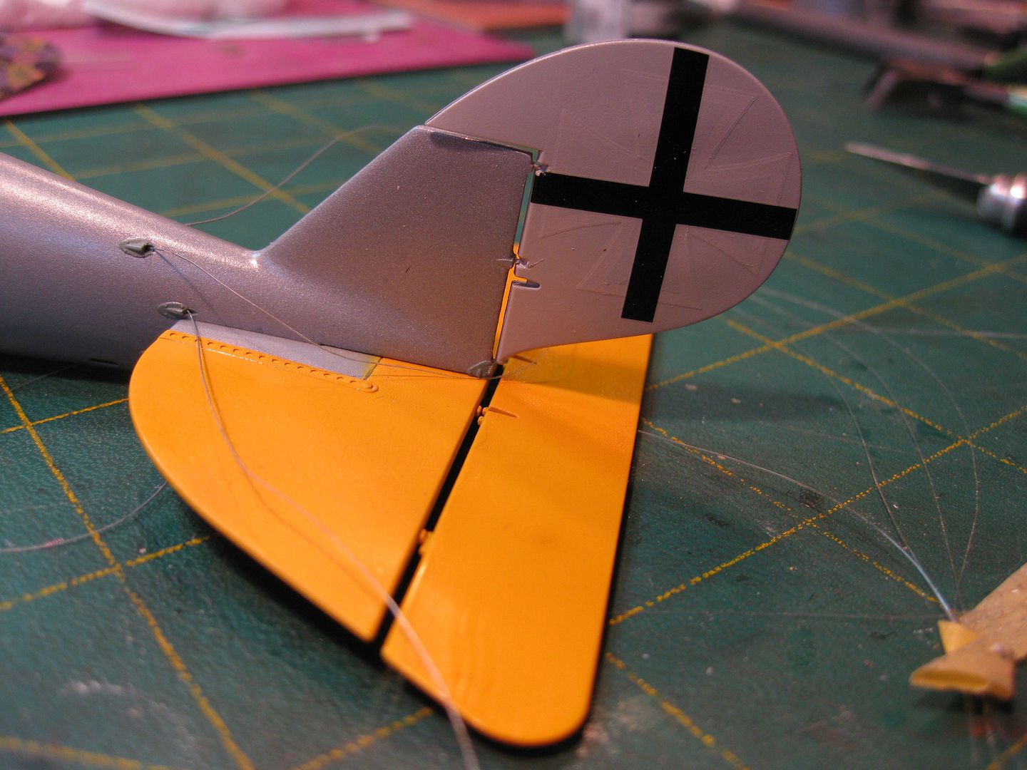

    The tail section has been painted as well, components "posed" here for illustration. A little touch up required in this area............

It all looks great IMHO! The lozenge is patched but I think the real thing was patched up after a fight too  ;) so it is basically the realism in its purest form!
Keep up the good work Lance!

Great update! I'm so happy the masks worked well for you.

This is coming along nicely.  I have used W&W lozenge before and experienced the same chipping.  When I use it again, I will definitely give it a decal coat.  Your patches are imperceptible and your walk areas nicely covered the chipping there.  The masks are the bees knees.  I will have to send him a PM about those!! ;)  I am interested to see how you will weather the fuselage.  I am doing one now; albeit you are way ahead of me, in Rudolph Berthold's markings.  So I will be watching to see how you weather the model.

Thanks, All, for the positive feed back, means a great deal to me. von Buuckle, Thank you so much for the excellent response on the mask request, these should become part of your product line as they are outstanding. Mark, the decal coat I used was Microscale "Liquid Decal Film" worked very well.

That’s a lovely couple of shots of the lower wing fixing to the fuselage.  Don’t you just love those wing fillets on the Pfalz D.IIIa.  I did try and count the number of compound curves but got a bit mind boggled.
Very nice lozenge as well.  I agree, a patch or two is entirely appropriate.  A mate of mine also uses those little Tommy roundels that come with the WnW decal sheet.  Ah, now I know what they’re good for.

Lance, for what it's worth, I really had to look closely to find the patches so you did an outstanding job with them. Consider also that I'm looking at closeup photography here, so at regular viewing distance, they'll be invisible. In my humble opinion, patches add realism to the model. Well done!
