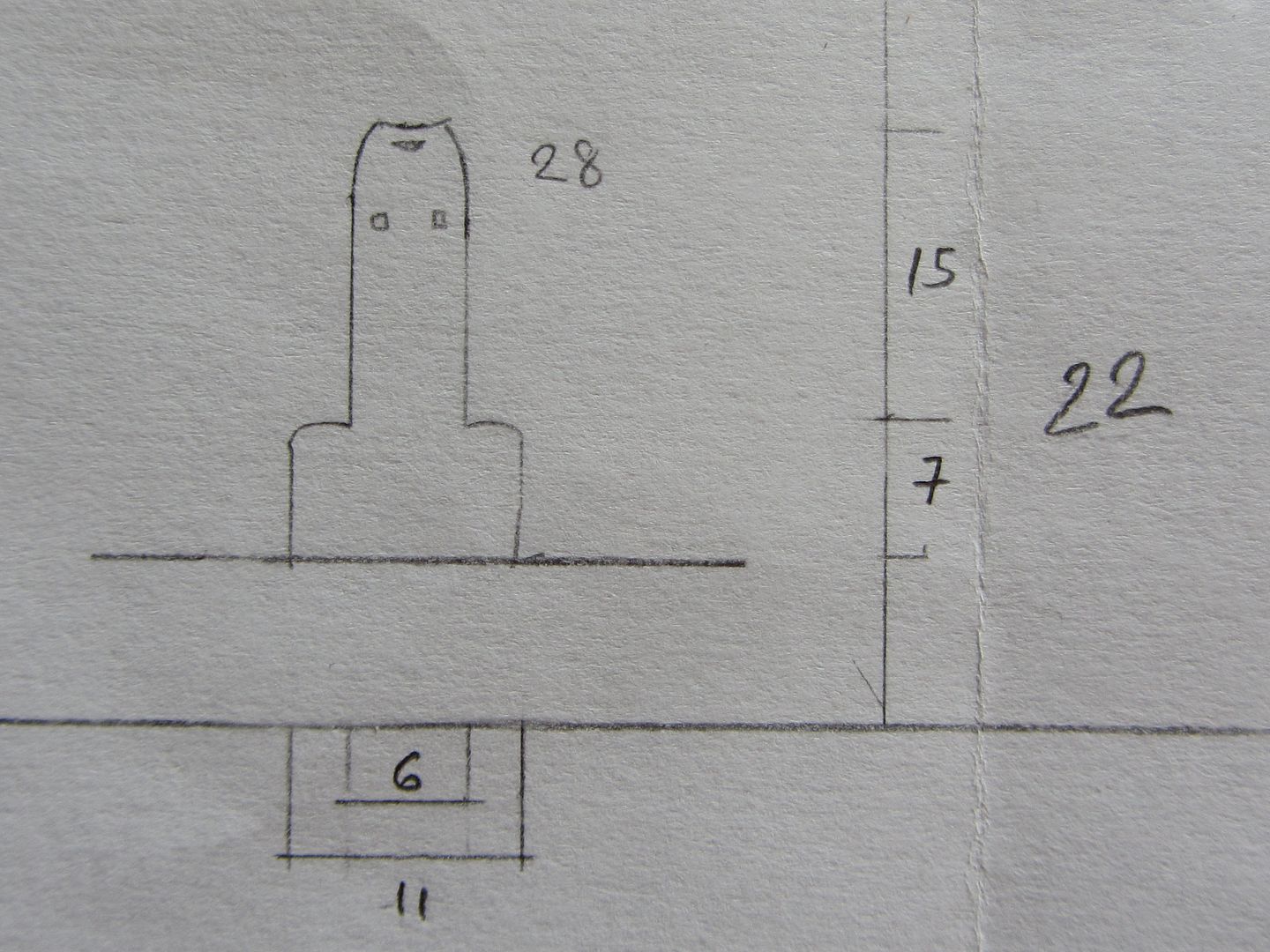

ernie, yes, it's a map case from eduard... I draw up it also on paper, for future use, if you wish I post it here. ;)
Paolo, that would be great.  Thank you!

The map case grabbed my eye as well, it is very impressive, a post of the map case here would help many modelers, thank you.

« Reply #25 on: November 22, 2013, 01:24:17 AM »

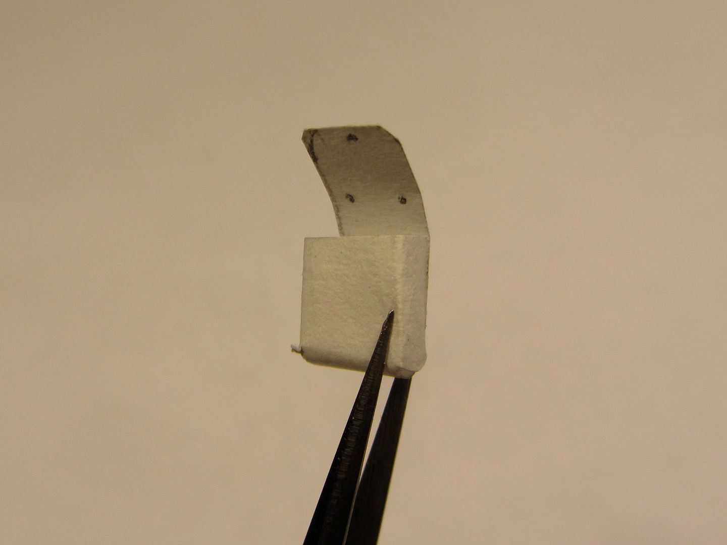

quite easy...
I hope eduard do not be offended!
here the measures in millimeters. oops! that "28" does not mean anything!

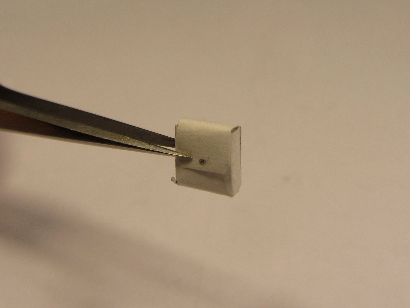

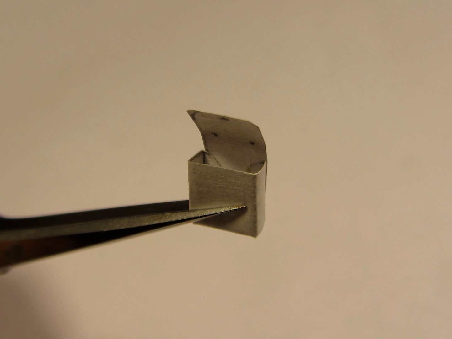

and here the development of a prototype in paper.
8719
8720
8721
the best thing is to use a brass sheet, or thin plastic card.
another thing that probably should be considered is to do it shallower, I guess (I'm sure) that at that time there were no bootlang jeppesen, and the necessary maps to fly VFR with less than 300km of endurance does not require too much space...
bye, p. ;)

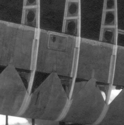

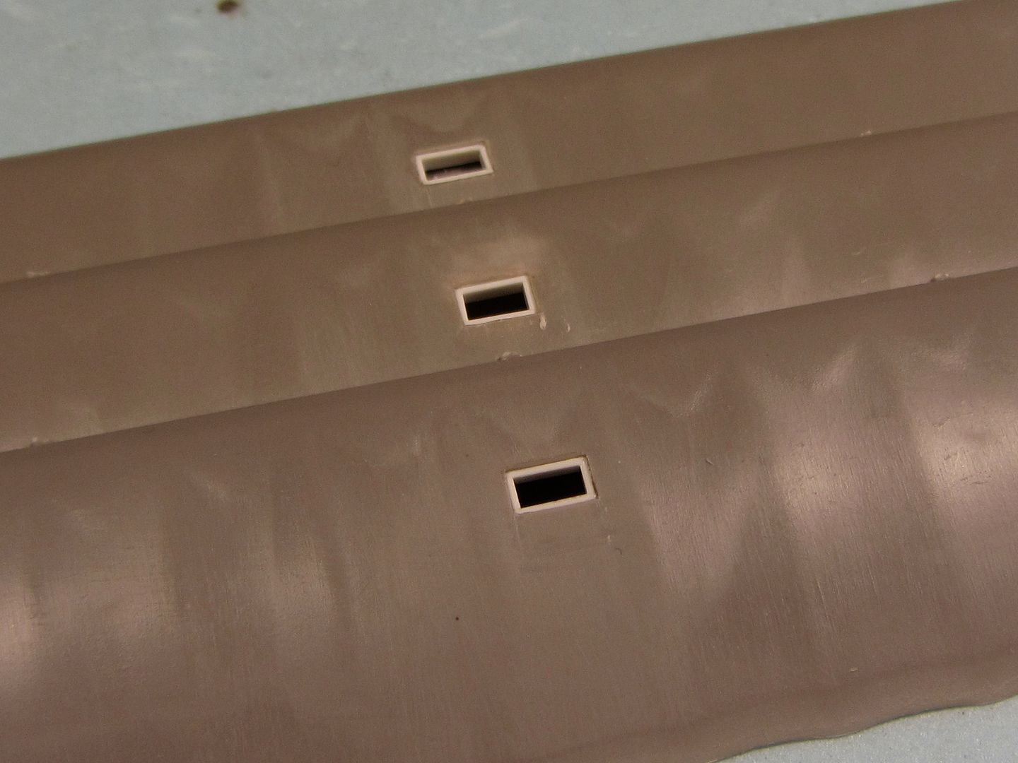

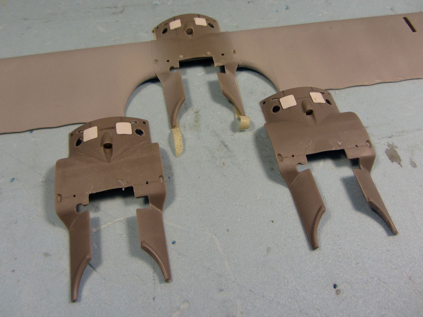

this is the window corresponding to the wing spar of the upper wing, through which were visible mark, code and serial number assigned by the commission responsible of construction supervision (bauaufsicht) which in turn was under the control of aviation Inspectors' army (idflieg).
commissions were numbered from 1 to 45 (less than 28, go figure why) and verified the entire production cycle of the machines, numbering each part. at the end of the process, a machine's number was given, and written on the spar, visible through the window together with logo and symbol ZAK (Abnahme Zentral Kommission).
is interesting (and bizarre) to note that the codes did not match with the werk numbers... but I think I found the correspondence table.
all this to say what? that I located and opened the window...
8924
or better, the windows! the other two kits are arrived, too...
8922

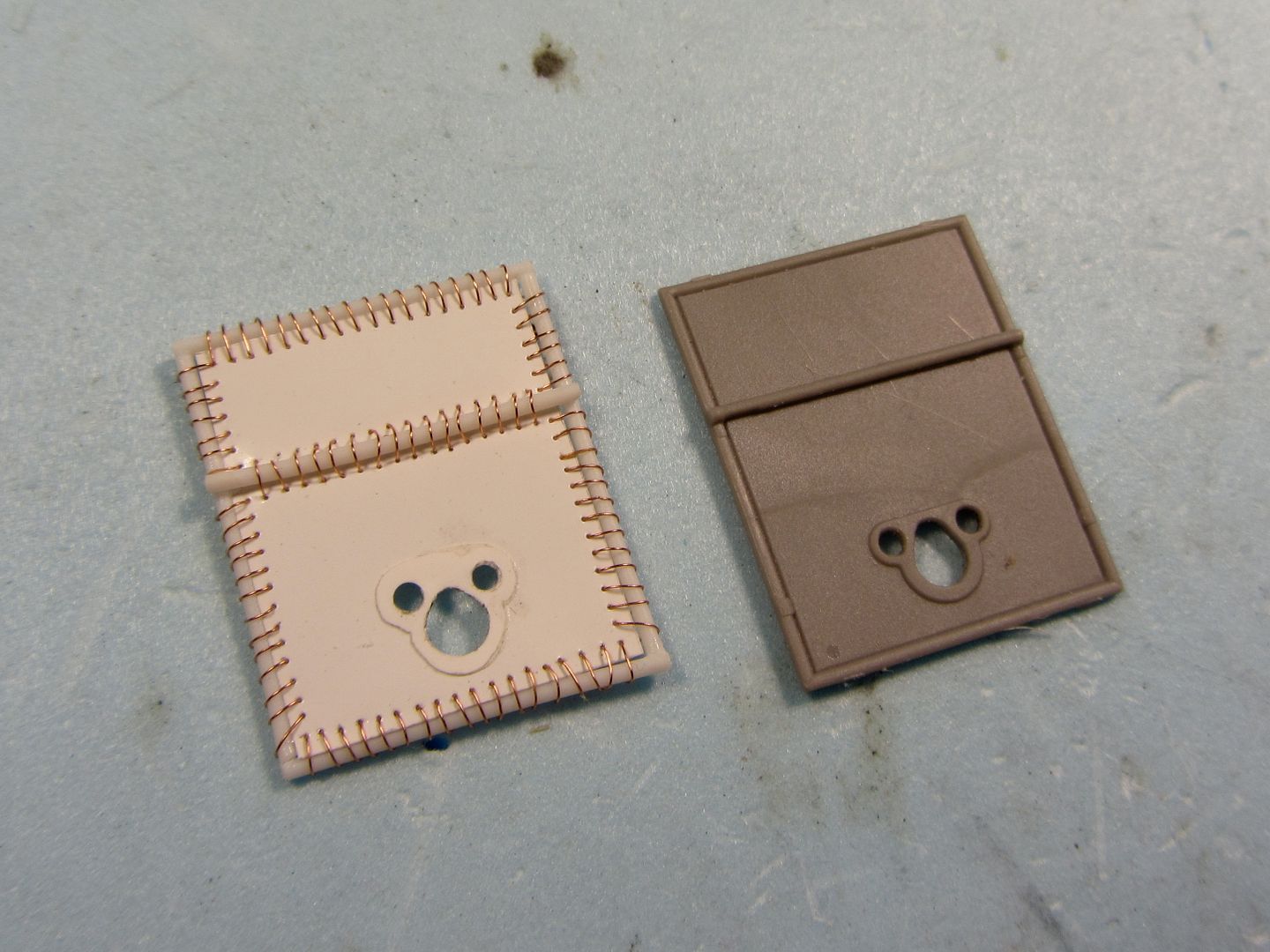

also I worked serially other parts, trying to do all identical. well, similar.
8920
also, I tried to rebuild the seat frame and his curtain behind. too long story, and I'm not convinced at all from the results.
