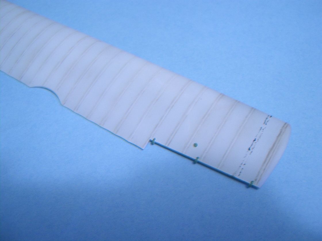

Thanks Patrick! I have made some progress and My Aviattic Lozenge( Fokker Built Cookie Cutter) decals arrived today!  :D So now a question. Those that have used Aviattic decals, Should I pre shade?, Use pastels? Oil washes along the ribs like the DVa pictures I posted earlier? What have you had success with? Let me know!

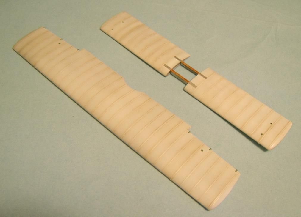

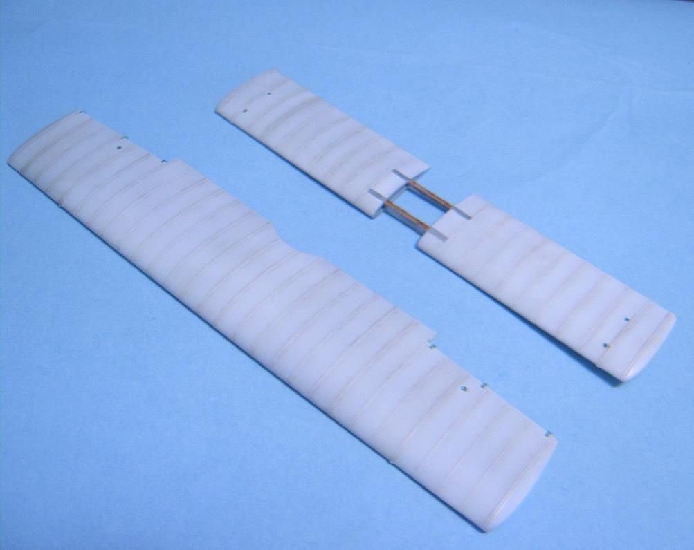

I have done the preshading using Artists Oils. My method is straight forward. Mix 50/50 Mars Black and Burnt Sienna. With a small pointed brush make a line or dots next to the rib edge. Wipe running parallel to the rib, ( this gives an edge to the rib) then rub away excess going across the rib. This outlines the ribs and adds just a touch of color between. The pictures show the process. The final pictures show the wings glossed and ready for the decals.

Looking forward to seeing how this (great looking) pre-shading looks when the decals go on.  I have some Aviattic lozenge too, so I watch with interest!
Re: WNW Fokker DVIIF: Erich Lowenhardt, Jasta 10
« Reply #118 on: November 15, 2013, 10:03:36 AM »
Awesome preshading technique, amigo!  Gonna have to give that one a try.  What's the drying time on the oils?
