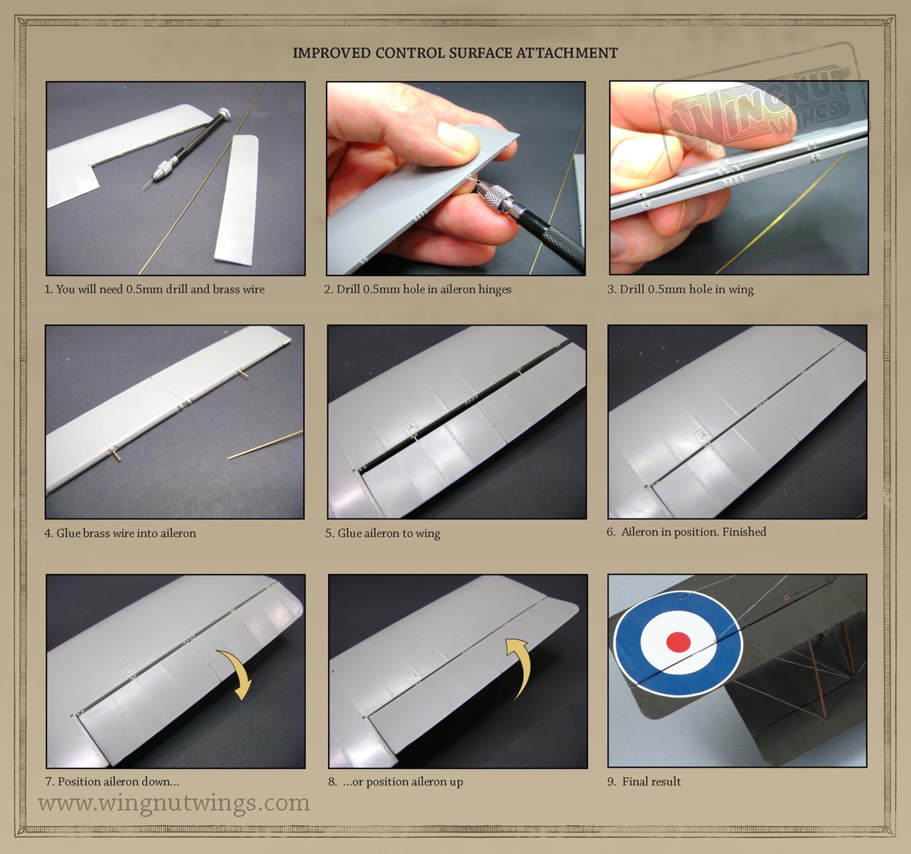

It looks like you are making good progress.  No worries on the control inspection windows, just ensure you mask them off well prior to painting.  As Des Mentioned just ensure your control horn attachment points are facing the right direction.  I pinned mine with brass wire, it helps a lot with rigging and handling as you can leave them off until you actually need to rig them and you can put them on and off for decaling as well.  In fact, I pin all of my control surfaces now just for that reason.  It is easy to do and really saves a lot of hassle with glueing and knocking them off later.

Thank you so much Mark. For the moment I'm fixing the ailerons and I'm painting a lot of parts for future use. For the horns Mark, are you saying that you replace the plastic horns by brass wire until at the end, after painting and applying the decals, you glue the original onces? Or did I misunderstood that?

Thank you Rizzo! I had it all wrong. Maybe a little bit of confusion with the terms I'm not so familiar with them and it's not my native language. Thanks to all of you gentle people I will come to learn them. Thanks again!

After re-reading my post, I can see why you would be a little confused, as it wasn't real clear.  The link shows how to do the pinning quite nicely.  As you can see it is a simple procedure but yet effective.  I put the control horns on quite towards the end of the build so as not to ruin them.  I did split the ones for the tail control surfaces, but had no problem attaching them.  I let them set up overnight and they were fine to rig later.

The link makes it all clear. Unfortunately I glued the ailerons before your post, but I didn't glue the control horns except for the tail plane. I guess I will have to live with that. I will remember that technique of pinning the ailerons for the next one.
