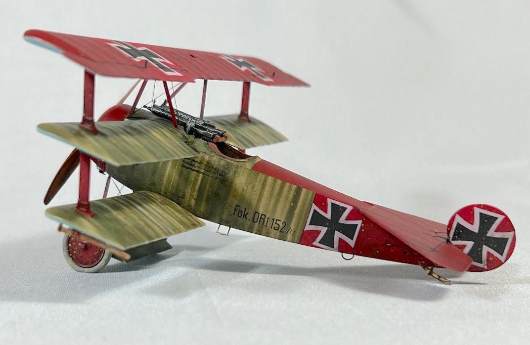

Part2.
Moving along with the build. I?ve added more details to the fuselage. Punched Evergreen discs for the tacks on the cockpit combing, leather supports for the control cable openings, and rivets on the firewall.
The Spandau guns were replaced with 1/28 scale guns from the Revell Dr.1 kit. I really wanted to add photo etch gun jackets but can?t find Toms model works set.  Gaspatch has offerings but too expensive for the likes of this model.  I also added gun rings made from brass wire.
More washes on Mr. Barron, added blond / gray hair making him an elderly sole.
I finished the light and dark face washes and began painting the uniform. I copied a German WWI uniform picture but have not researched what unit or rank it represents. I just liked the colors.
Not sure I?m liking the chrome pickelhelm. I have a plan to add a cover?
Thanks for looking in!

Part 3.
I want to represent the picklehelm with a cover on it. I used cocktail napkins and white glue to cover the chrome dome. I made the helmet band with masking tape and the buckles from Evergreen strip.
Next I painted the underside a light blue color and masked it when dry. Then the upper surface was painted a depot buff color as a base for the Fokker streaking.
The green color is Tamiya flat drab for the initial application. Next I added a little flat black to the green and applied it over the initial layer.
That?s all for now. Thanks for looking in!
Tim
