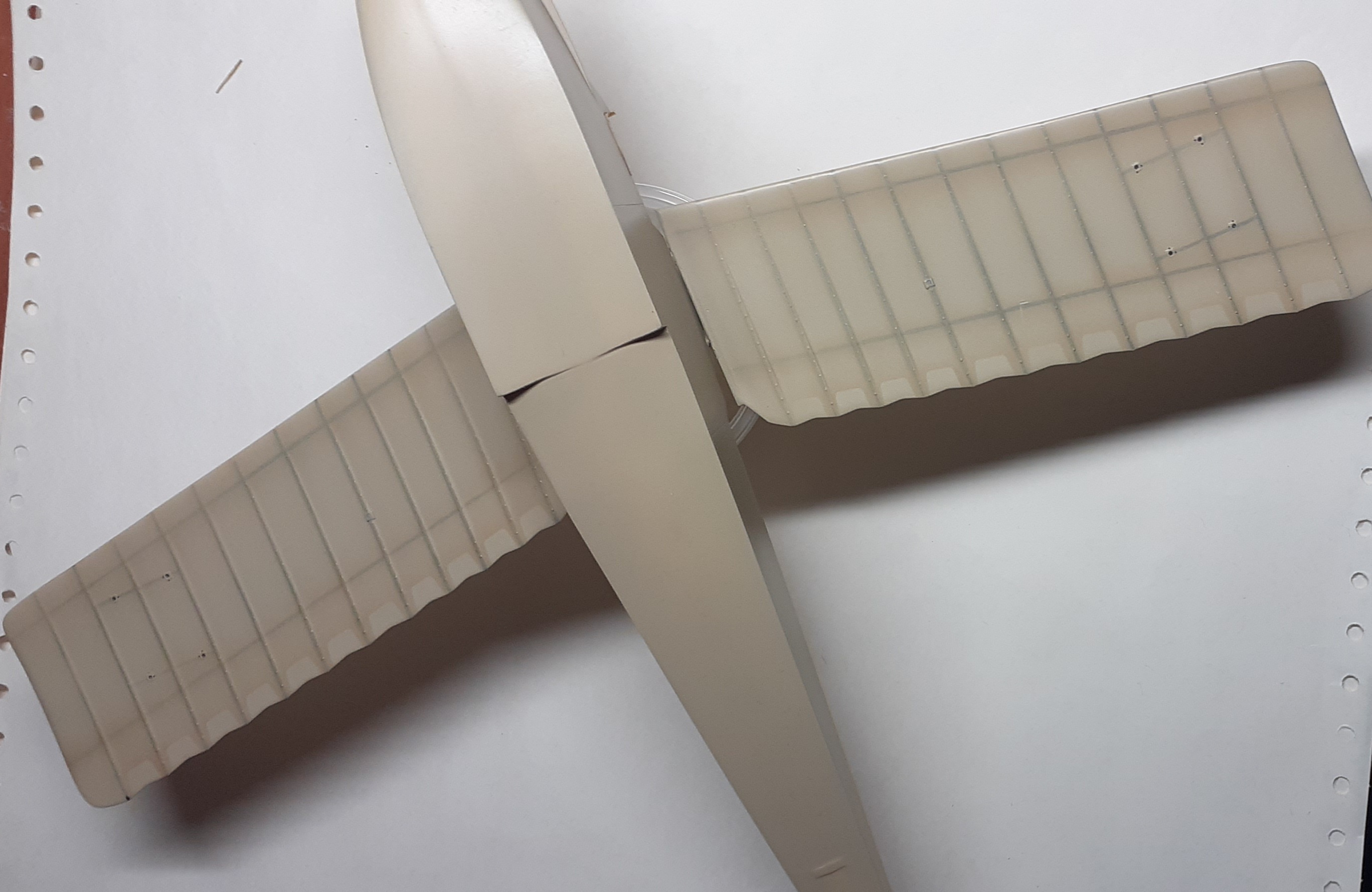

« Reply #48 on: March 28, 2023, 06:56:17 AM »
The turnbuckles prepared, 60 small ones, 58 large ones and 24 small ones with Uschi lines for the control surfaces.
And the colouring started. The linen undersides with pre and postshading to show the traces of the inner structure... Also the wood got the background colour.

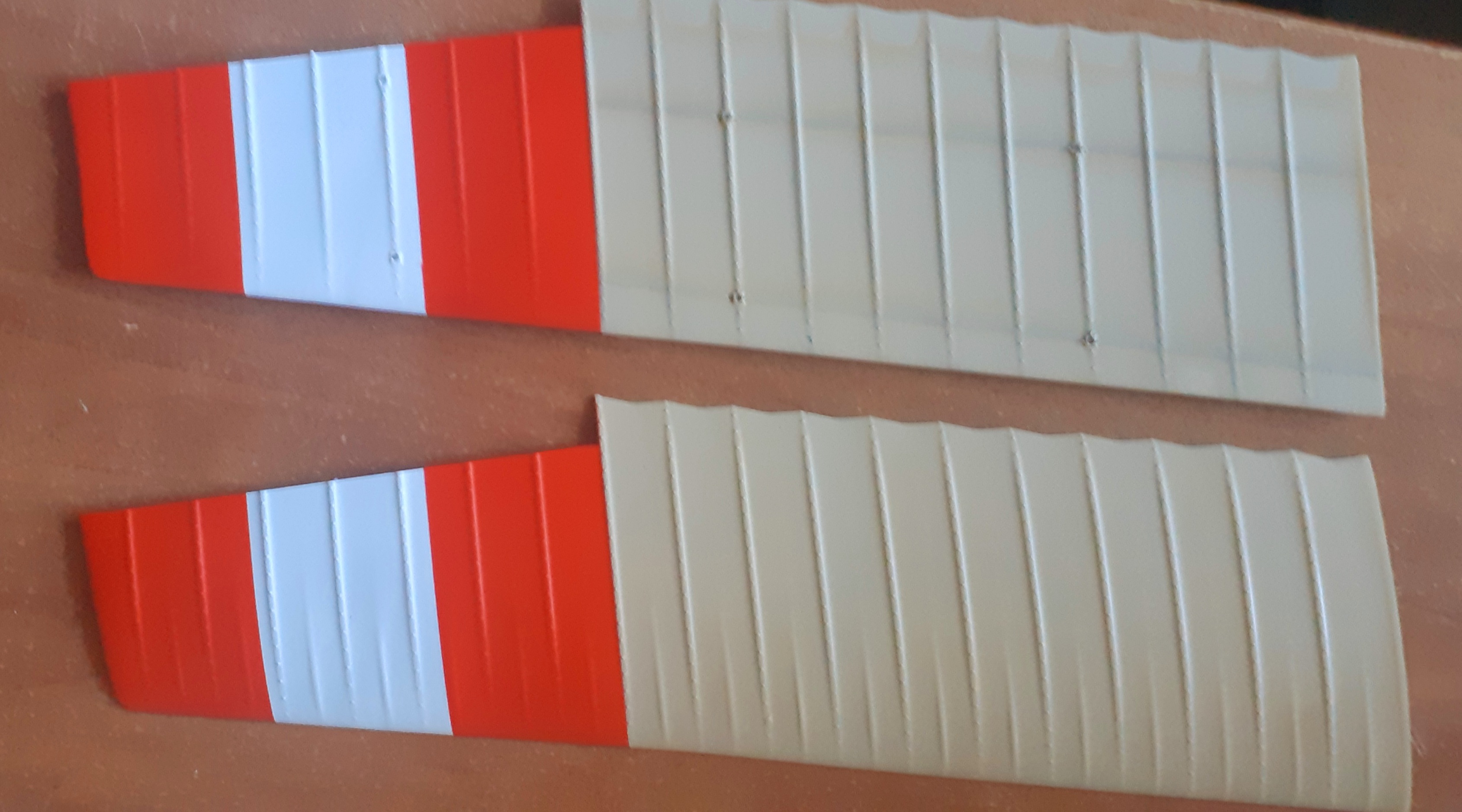

« Reply #52 on: April 03, 2023, 03:03:24 AM »
Colours, colours. Red-white surfaces and black struts

Wing tips and empennage postshaded. Wing crosses applied...
