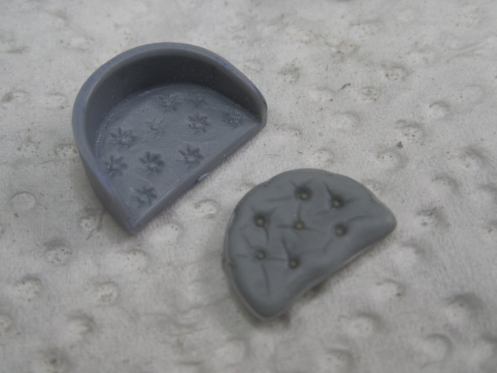

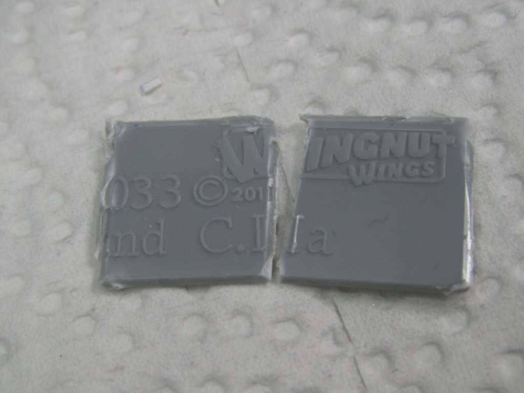

Today only a small thing - scratch built from the seat cushion for the pilot.
The following pictures are from February last year.
Some of you know I'm a big wingnut wings fan.
Also here on this model I used material from New Zealand - even if it was only waste plastic in this case.
I used the outline of the kit seat as a template for the cushion.
The buttons were marked with a thin pencil ...
and drilled with a thin CNC drill.
The imprints of the pilot's thighs were indicated with a small half-round file.
The cushion should look used and crumpled.
Servus

Now the two dents left by the pilot's butt.
I used a small ball sander and the Dremel to create the two dents.
In the next step, the surface of the cushion was "raked" a bit with a small sharp cutter so that the surface of the cushion looks even more used.
Now the holes, in which the buttons are inserted ,were slightly widened and deepened with a cutter on the top side.
Between the machining steps, the surface of the cushion was smoothed with fine steel wool.
Using a pointed scalpel blade, the typical small indentations and folds were now made, which run from the center of the buttons to the outside.
Servus
Bertl

Time for the thin circumferential leather bead with which sewed the top and bottom of the pillowcase.
Hot drawn casting bast is the right choice here.
Gluing is done with thin Tamiya plastic glue.
This glue has the advantage that the thin casting branch is slightly dissolved, making it softer and more pliable.
Nun die Knöpfe.
Zur Darstellung der Knöpfe benutzte ich Resin-Nieten von Masterclub.
Here in the picture the finished cushion in comparison to the kit part.
Servus
Bertl
