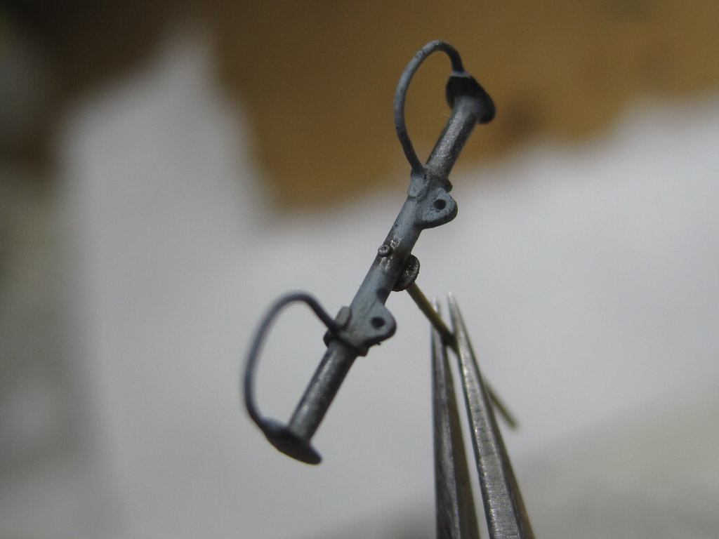

The next step, the creation of the Rudderbar
The thing was scratch built from plastic, brass tube and copper wire.
Also the bearing for the rudder bar was built from scrap plastic and resin screws.
Servus
Bertl

« Reply #54 on: May 05, 2022, 04:51:14 AM »
With paint, the rudder bar and plywood floor look much more realistic.
The steelwires for the rudder were created from 0.10mm fishing line.
