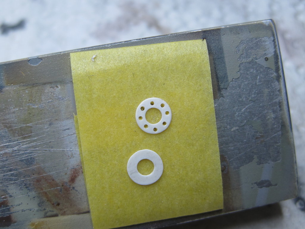

The rear cover for the spinner and the two hub plates for the propeller were punched out of a thin Evergreen plastic sheet.
Servus
Bertl
