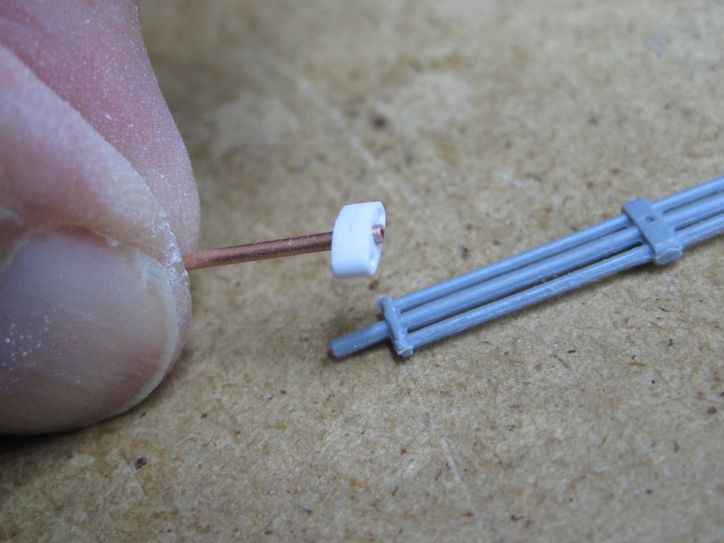

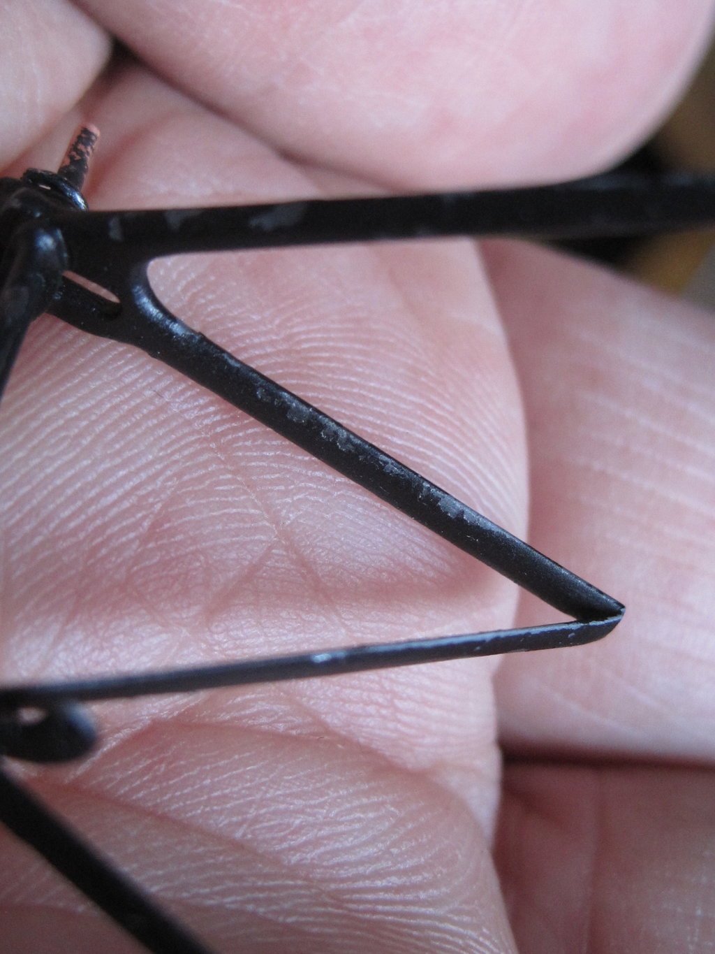

Now to the chassis and wheels.
The struts of the chassis were also ground much thinner.
In addition, the complete axle mount was built scratch.
I used 1mm thick copper tube as the axle.
The two axle stiffeners were represented by injection needles.
The connectors are made of Evergreen material and the suspension is simple wire.
The wire bracing under the axle beam was represented with fishing line.
The complete chassis was primed in light gray, then a layer of Mr. Metalcolor "Aluminum" and "Stainless" and on top of that several very thin layers of Tamiya "Semi-gloss-black" mixed with a drop of light gray.
Then chipped again.
Then aging and weathering with thin dark brown oil paint broth and Tamiya "Smoke" for the oil marks.
A big problem was gluing the metal parts to the Evergreen brackets.
I used super glue for this. But this of course does not penetrate metal but only glues on the surface.
As soon as the axle beam was twisted only minimally, the glued joints broke.
Servus
Bertl

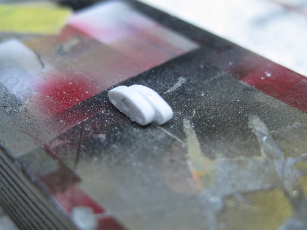

Four components for the wheels are in the box.
These components show a very strong structure of the spokes lying under the surface.
It looks like this rims are covered with fabric.
Interestingly, original pictures of the Morane used by the French show dented cladding on the rims.
It looks like aluminum to my eyes.
On the other hand, the original pictures of the Morane used by the English, show clearly spokes under the cover.
Anyway, I decided against the wheels from the kit.
I used wheels from a Copper-State-Nieuport kit.
These are exactly the same size as the wheels from the Morane kit.
Here is a picture of a French Morane - dented covers on the rims without being able to see the spokes behind them.
And here the Kit-parts.
Servus
Bertl
