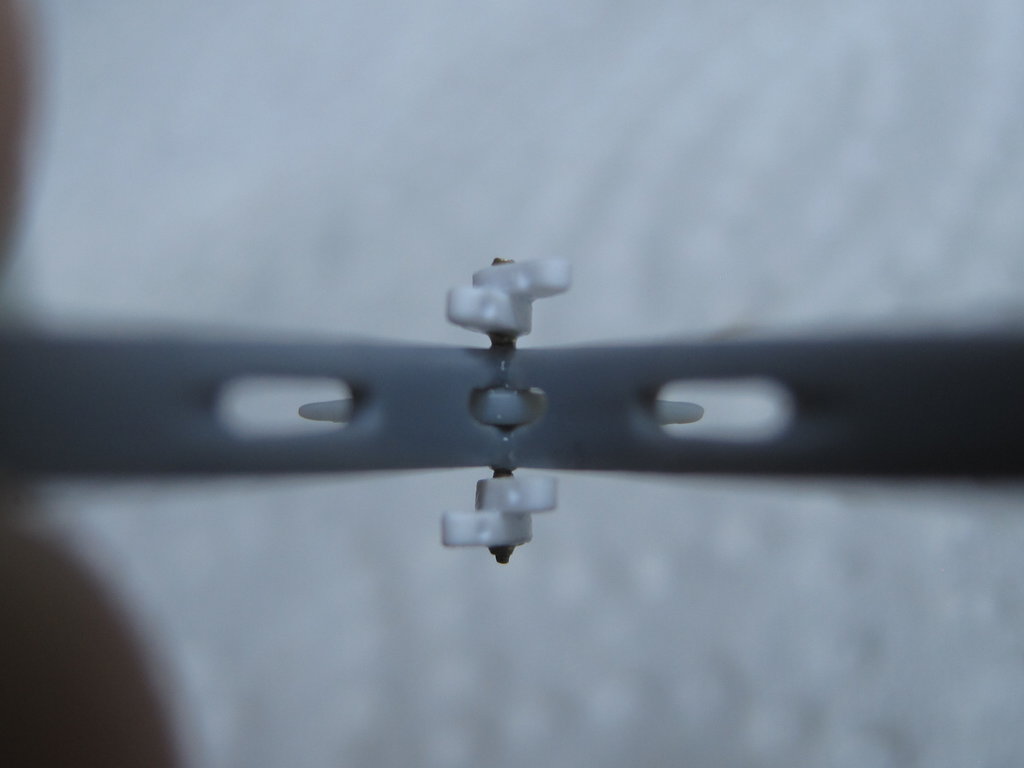

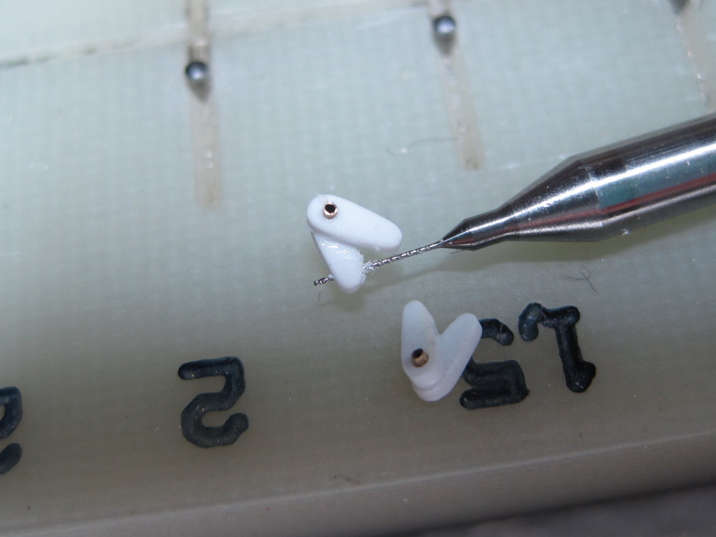

Offline Umlaufmotor
  • Posts: 1217
Re: Morane-Saulnier Type "N", Special Hobby 1/32
« Reply #276 on: June 07, 2022, 05:21:56 AM »
It took quite a bit of work to build a tension tower that is very close to the original.
The following pictures describe the way of work.
Servus

Scratch-built was the motto.
Waste plastic from Wingnut Wings, Evergreen Profile and brass tubes were my material suppliers.
Servus
Bertl

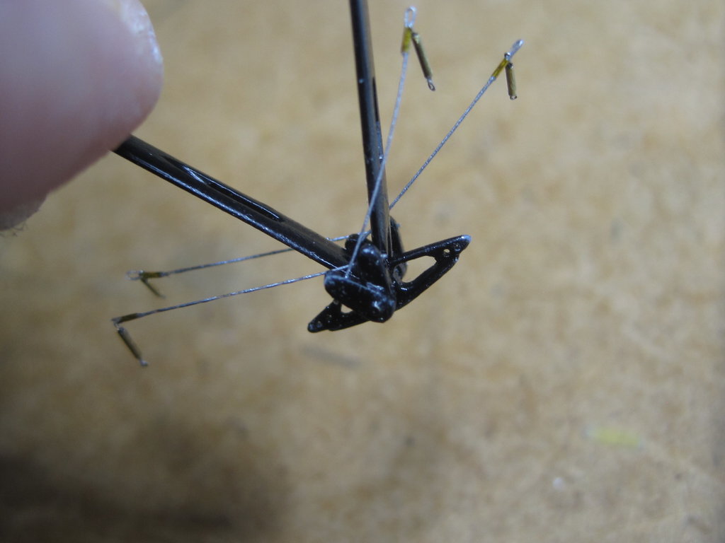

The turnbuckles were made from 0.4mm brass tubes and 0.10mm silver wire.
The tensioning ropes are 0.10mm fishing line.
Servus
Bertl

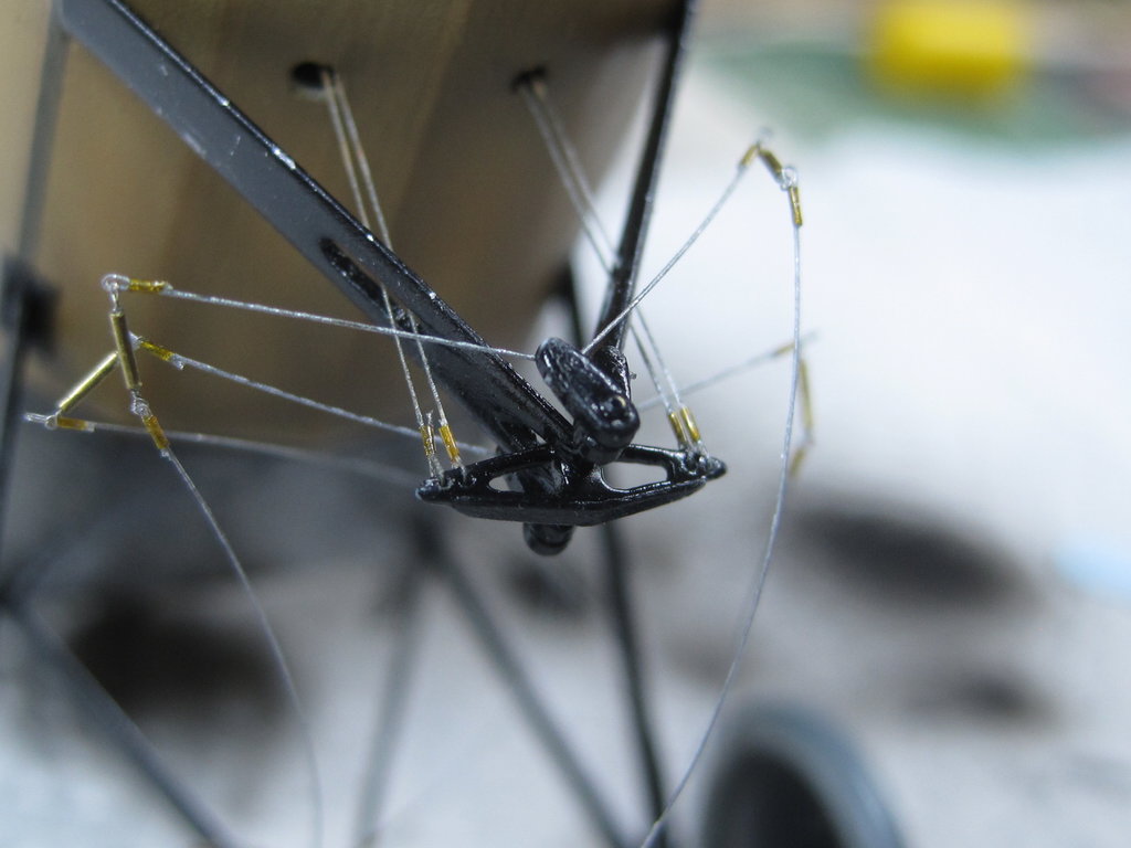

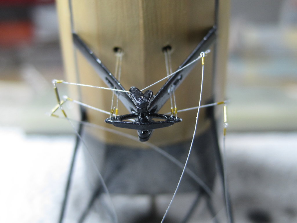

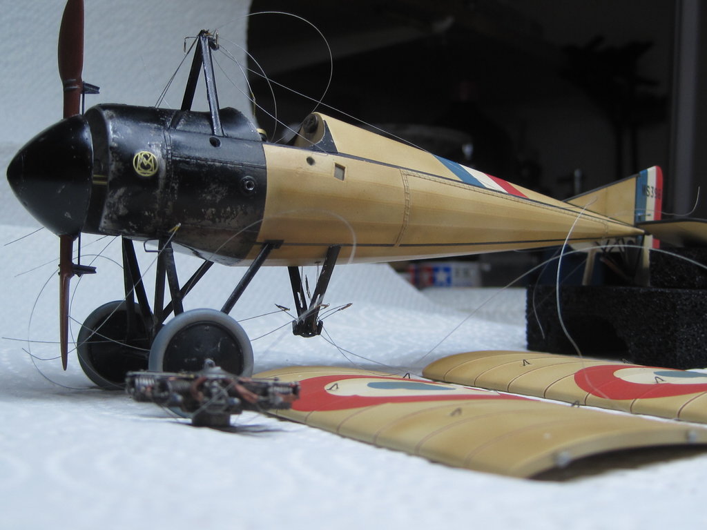

Offline Umlaufmotor
  • Posts: 1217
« Reply #283 on: June 07, 2022, 05:49:51 AM »
The following pictures show the course of the steering and tensioning ropes.
The landing gear can also be seen there - but more about that soon.
That's it for today - I thank you for "looking in" -  bye.
