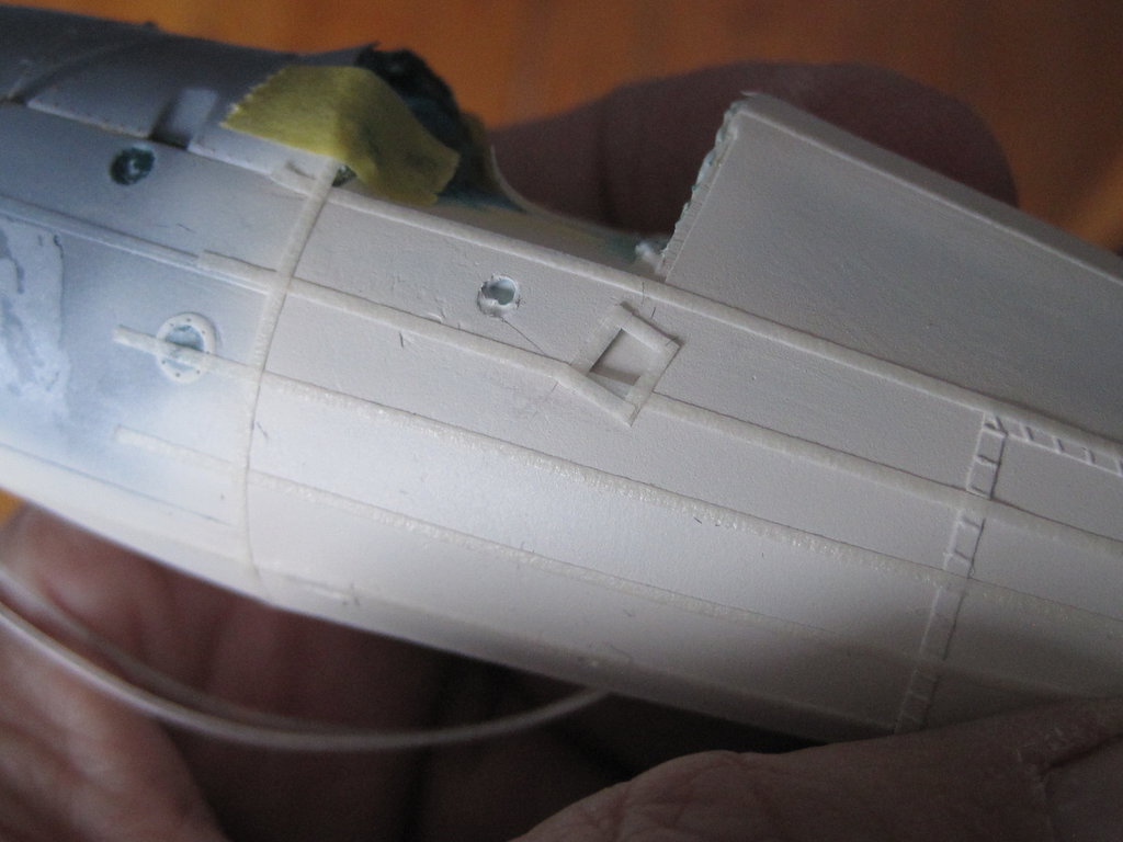

Now the fuselage is painted.
First, along the longerons - for this, "Radome" from Gunze, whitened with white, was used.
Then the longerons are masked with 0.5mm narrow tape.
After that, a mixture of matte black and dark gray is used to paint on the first traces of Castor oil.
Somewhat stronger on the underside, medium on the left and weaker on the right.
Due to its rotary motion, the engine spins and spreads a little more oil on the left side as seen in the direction of flight.
The canvas soaks up oil, but primarily the oil (and dirt) spreads along the longerons - where the canvas fabric also "stretches" directly over it.
Servus
Bertl

Now carefully peel off the thin masking strips along the longerons....
.... and the fuselage is then lightly airbrushed with "Radome" as a test.
Yep, it works ... the oil dirt and lighter longerons are clearly visible.
Now the complete fuselage is painted with thinned Radome.
This needs to be somewhat glazing though, don't paint an opaque coat of paint.
Servus
Bertl

Now the black fabric stripes are painted on
These black borders were also applied to the fin and elevator.
I used Tamiya tape for this - the white tape is also from Tamiya and is very easy to stick around tight corners.
The stripes were painted with Tamiya Semi-gloss-Black , mixed with a drop of Brown.
Servus
Bertl

« Reply #247 on: June 03, 2022, 02:51:53 AM »
I was not able to satisfactorily mask off the Tail-skid mounting linkage.
A little trick helps here so that the strips can still be attached.
An old unneeded decal is painted and the required strips are cut from it.
If it is done cleanly, then the difference is not noticeable.
Servus
Bertl
