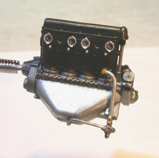

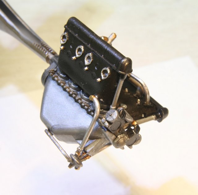

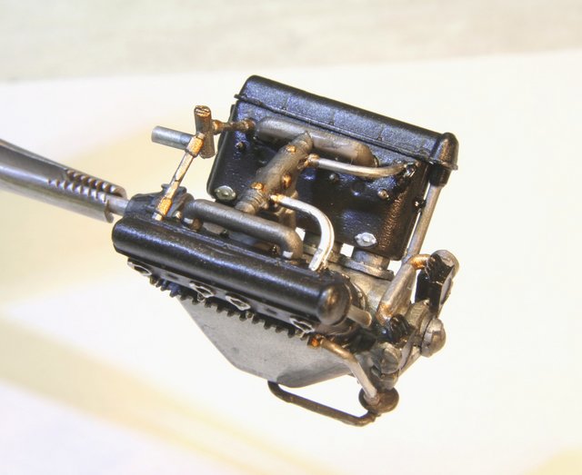

I started with the engine.  I will be closing up the engine so it won't be showing, but I built it without detailing just to see what it would look like.
I found that the base of the engine cylinders were too big to fit into the base at the engine block, so I remade the base of the cylinders.  Hopefully, this does not make the cylinders too tall to fit under the cowling.  If they are, some grinding will be happening.
The engine doesn't look too bad.  I also remade some of the water / oil lines as some did not fit exactly where they should have.

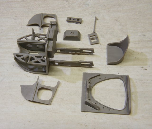

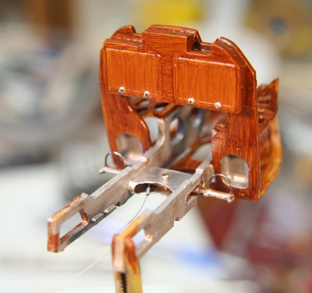

I then started on the cockpit area.

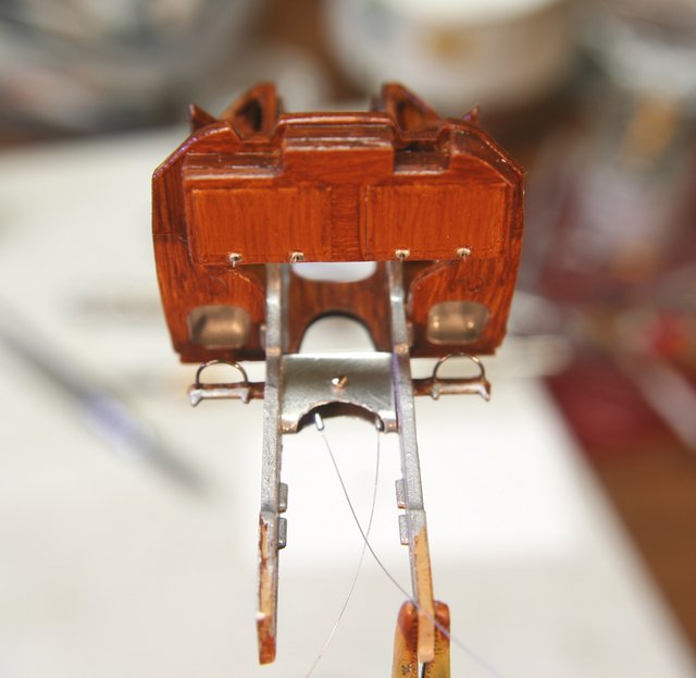

Wood grain was done with the usual oil paints.
I added latches on the ammunition boxes, scratched the rudder bar pivot and put wire loops on the rudder bar.  I didn't cut out the triangular openings above the rudder bar pivot.  Just getting this made seemed like a miracle so I didn't push it.
To get the engine to fit all the down against the mounts, I had to remove the bottom oil line.  This area will be covered by the bottom of the fuse.  I also notched the wing spar.

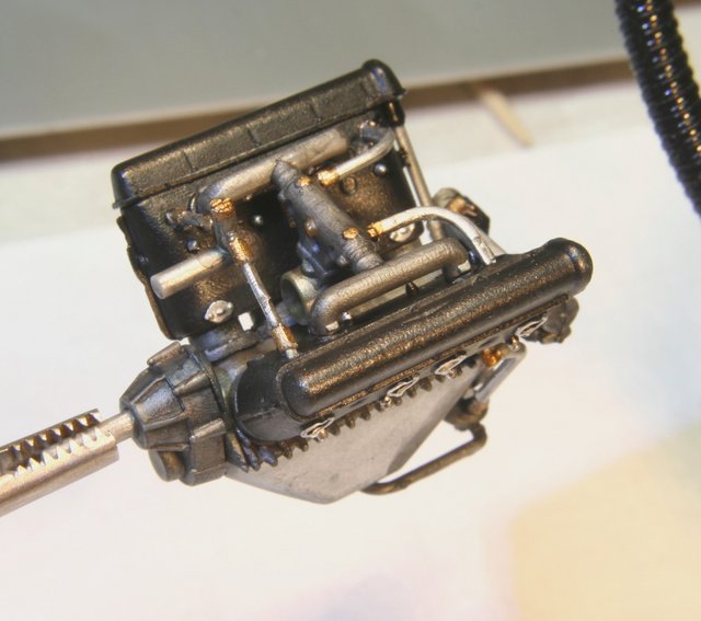

I have a few more pictures and another watchout.

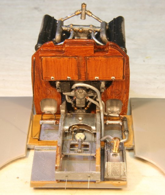

I have the engine mounted and the cockpit detailed with some oil lines and stuff.

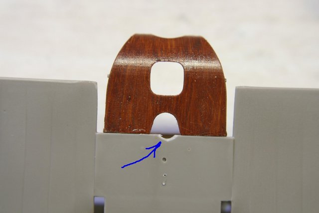

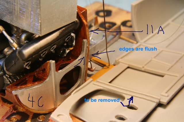

One watchout is around the aluminum side pieces, 4C and 7C and the bulk head 11A.  I don't know if I assembled the side pieces incorrectly, or if there is a design flaw, but the rear edge of the side piece should be inset from edge of the bulkhead.  I assembled them flush with the bulkhead edge.  I didn't realize this until I test fitted the fuse sides.  My fix was to grind off one of the ridges that form the slot for the bulkhead.  I think this will work fine.
Next I worked on the instrument shelf, shown here in progress.  I remade the instruments and control details.  I'm waiting for the PE set (for a SPAD VII) I ordered as it has a number of additional details that can be used.
This mostly catches up to where I am, but I have started working on the fuse sides.
