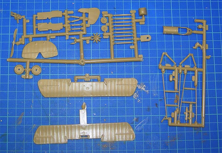

Now let’s open the box: the kit is really dreadful, many flashes and moulding signs coming out of the plastic…

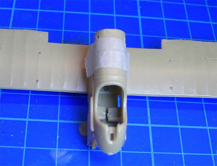

The cockpit is totally missing any detail… instead of the seat there is a sort of gangway seat divided in two parts…

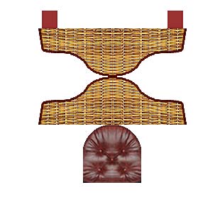

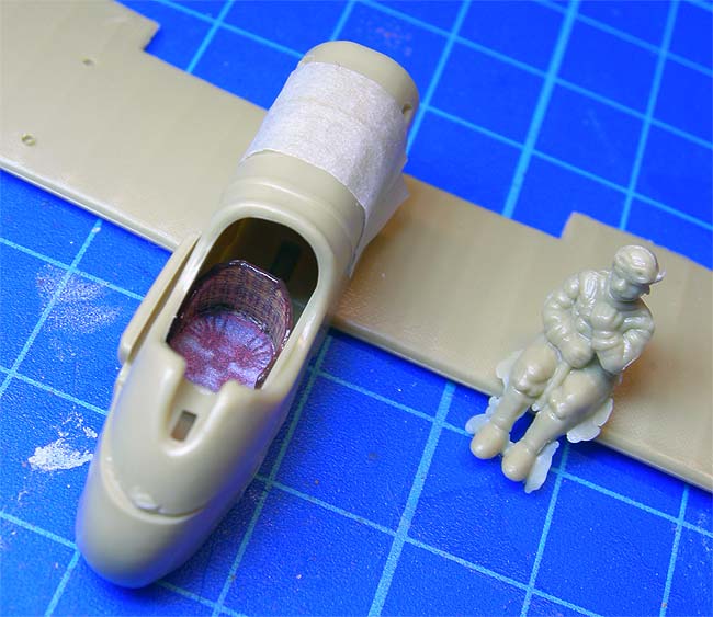

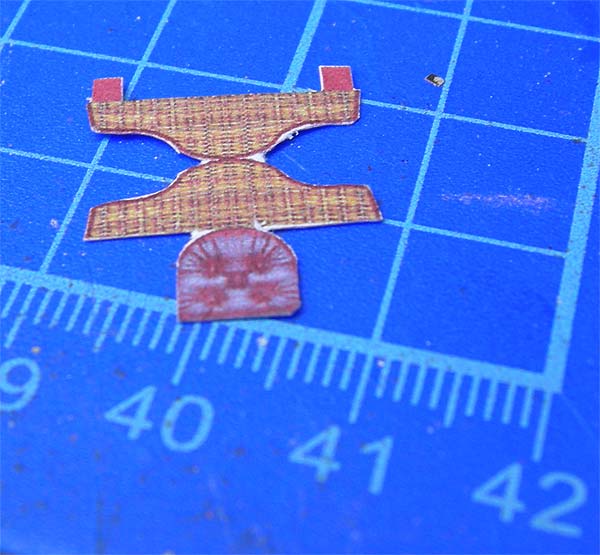

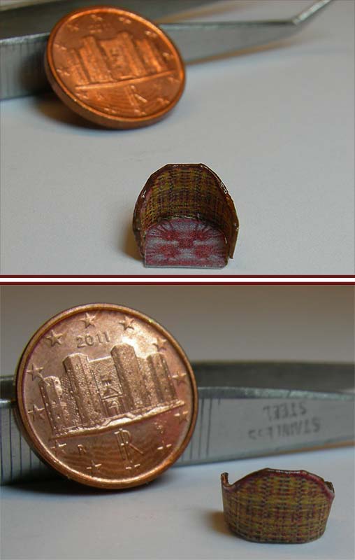

I measured the real seat dimensions from the Windsock and made it using my graphic editor
Printed on thick paper, cut off
And glued with Elmers glue...
Here it is dry fitted in the nacelle while the astonished pilot stares at it.
As you can see the poor guy is affected by liquid retention and I regret to say he’ll get assigned to a non operational job...

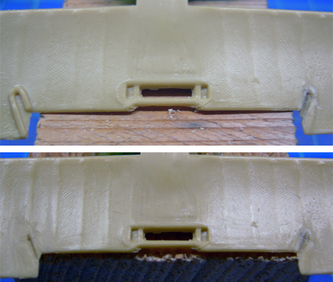

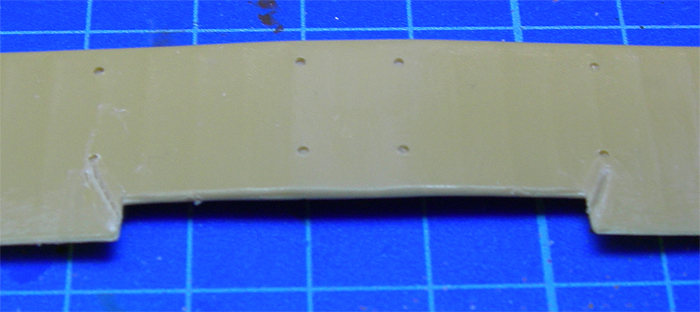

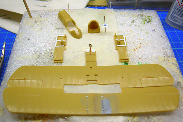

Underside of the upper wing: here are the notches where the tail booms will fit, too much similar to salami…
I took away the salami

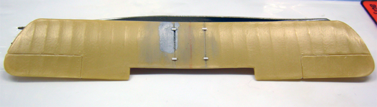

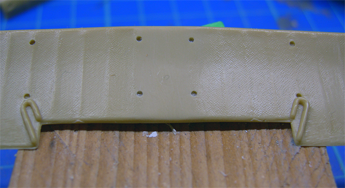

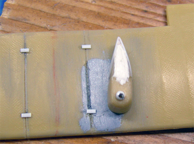

Upper surface: I scribed the ailerons and created the center section joint lines

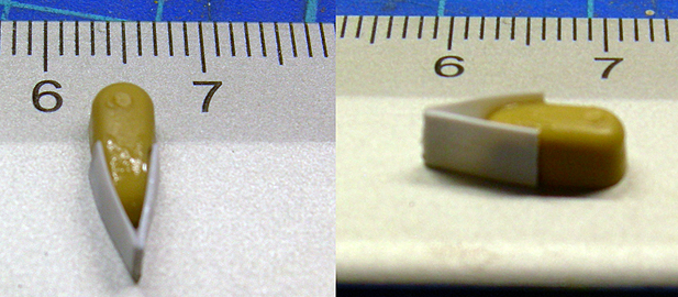

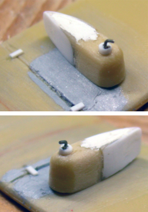

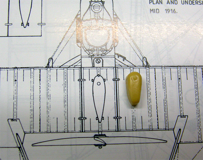

I filled the hole where the upper tank should have put, although the position is correct, the shape of the tank is totally wrong
Lower wing, same operation
Here is the tank, I imagine they have take nit from an old motorcycle, look at its real shape on the profile:

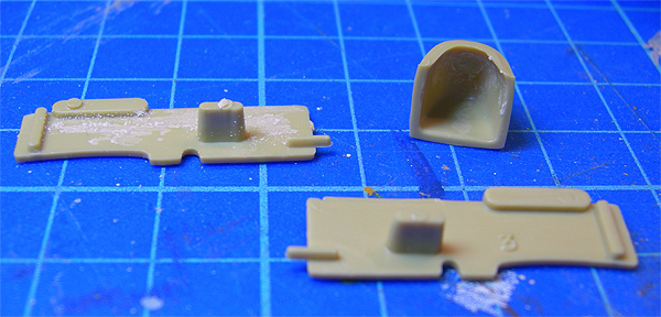

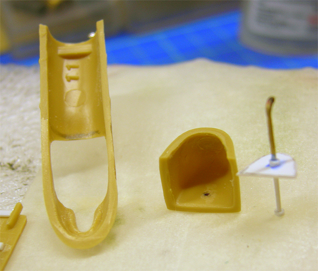

Then I turn my attention to the cockpit clearing the useless extruded numbers, writings and molding signs
Cleared the absurd apron put on the MG opening

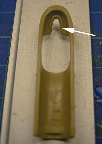

(I bought this Lewis on ebay to replace the shapeless worm provided by the kit)
I added some more details to the cockpit, the rudder bar handle is provisional

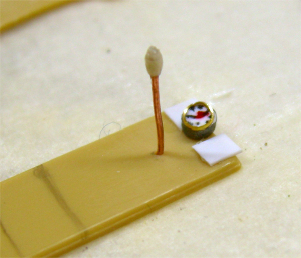

On the right the column where the MG will go, it is not finished yet. The black dot on the nose’s floor represents the position of the MG column behind which the rudder pedals will be placed
Here is a general view of the pieces done so far, on the cockpit side walls I glued some plasticard to simulate the wooden framework, I will glue the internal rigging after priming and painting them of course…
