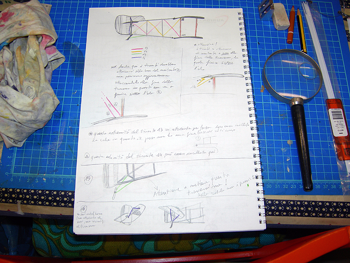

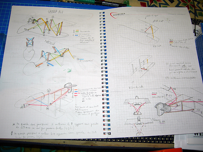

Here they are:
detailed study of the rigging schema, it's really a mess, I should study how to place the eyelets I normally use for fixing the wire, still thinking to how to manage the tail booms rigging, as I would try to use a single wire as far as possible, but there is not enough plastic to pierce without compromising the strength of the pieces...

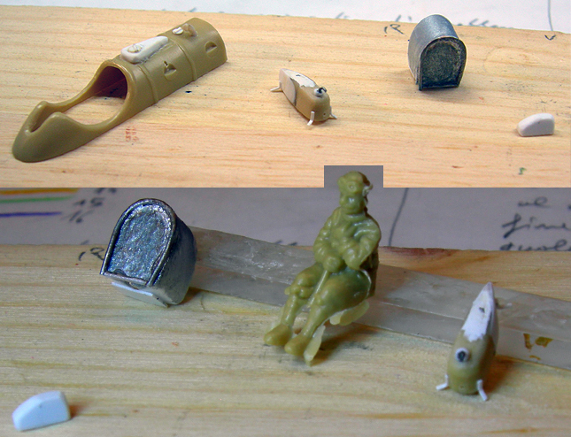

then here are some details I worked on
On the nacelle: oil and fuel caps, air intake (it is scarcely visible but it's hollow)
Fuel tank to be placed behind the seat
Compass fairing to go under the nacelle floor
Fixing slips for the gravity tank
Moreover I pierced the tail planes and rudder to insert self made control horns.
Tomorrow I'll pierce the two wings to insert self made control horns and prime everything.
Any suggestion for the seat belts? Which type was used and where to find inspiration to self build them?

love(!!!) seeing your sketchbook, i do similar things when I am trying to work something out, but my drawings aren't nearly as pretty!

Interesting work. Like your notes too!!

Here is a link to a complete rigging guide for the DH.2, just scroll through the file to get to each page, it is very easy to follow but is quite complex. This is the guide I followed when rigging my DH.2.
http://www.bobsbuckles.co.uk/files/dh2_rigging.pdf
