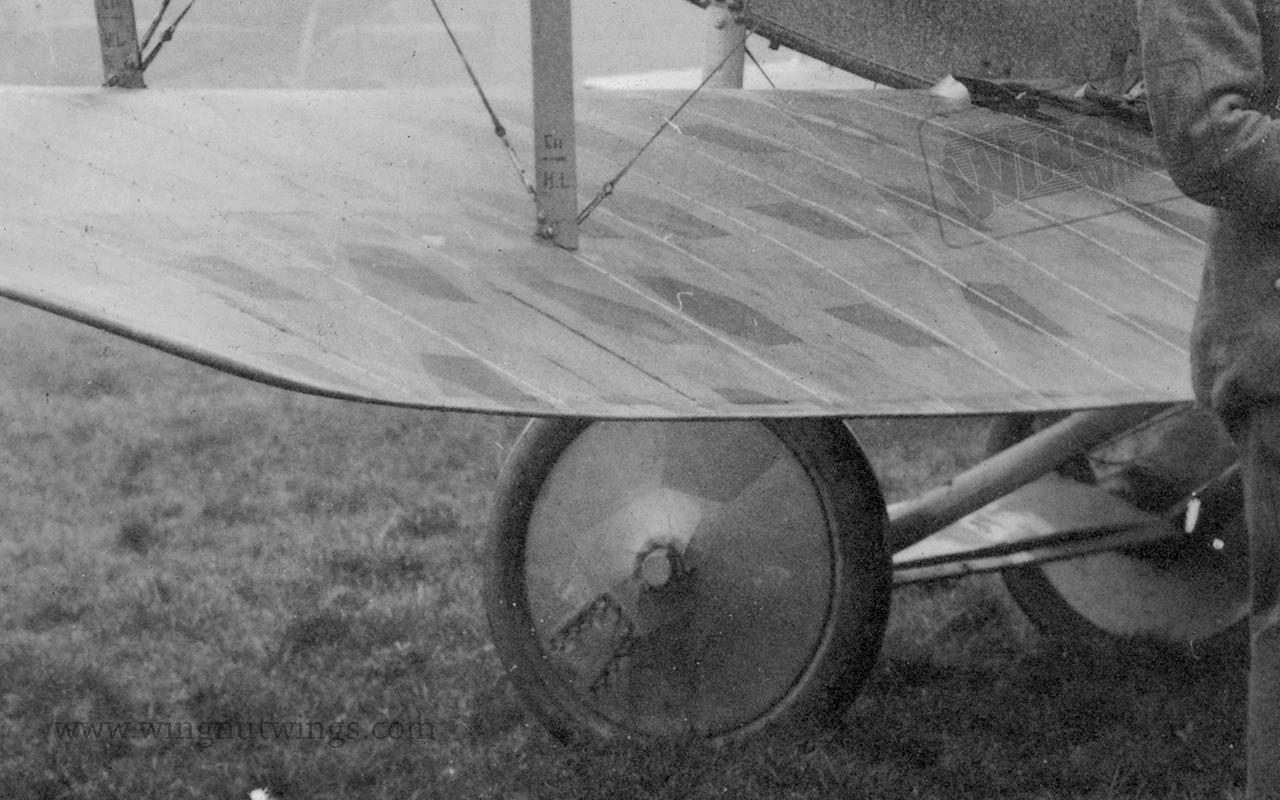

After painting I wanted to add decals, but ruined them. Used some from another kit now and protected them with a clear coat before applying them
The stencils are wrong now but at least the VL (Vorn Links), HL (Hinten Links), and VR and HR for Rechts (means front/back, left/right) are readable. The numbering of the kit in the manual is wrong! Here a WNW picture:
