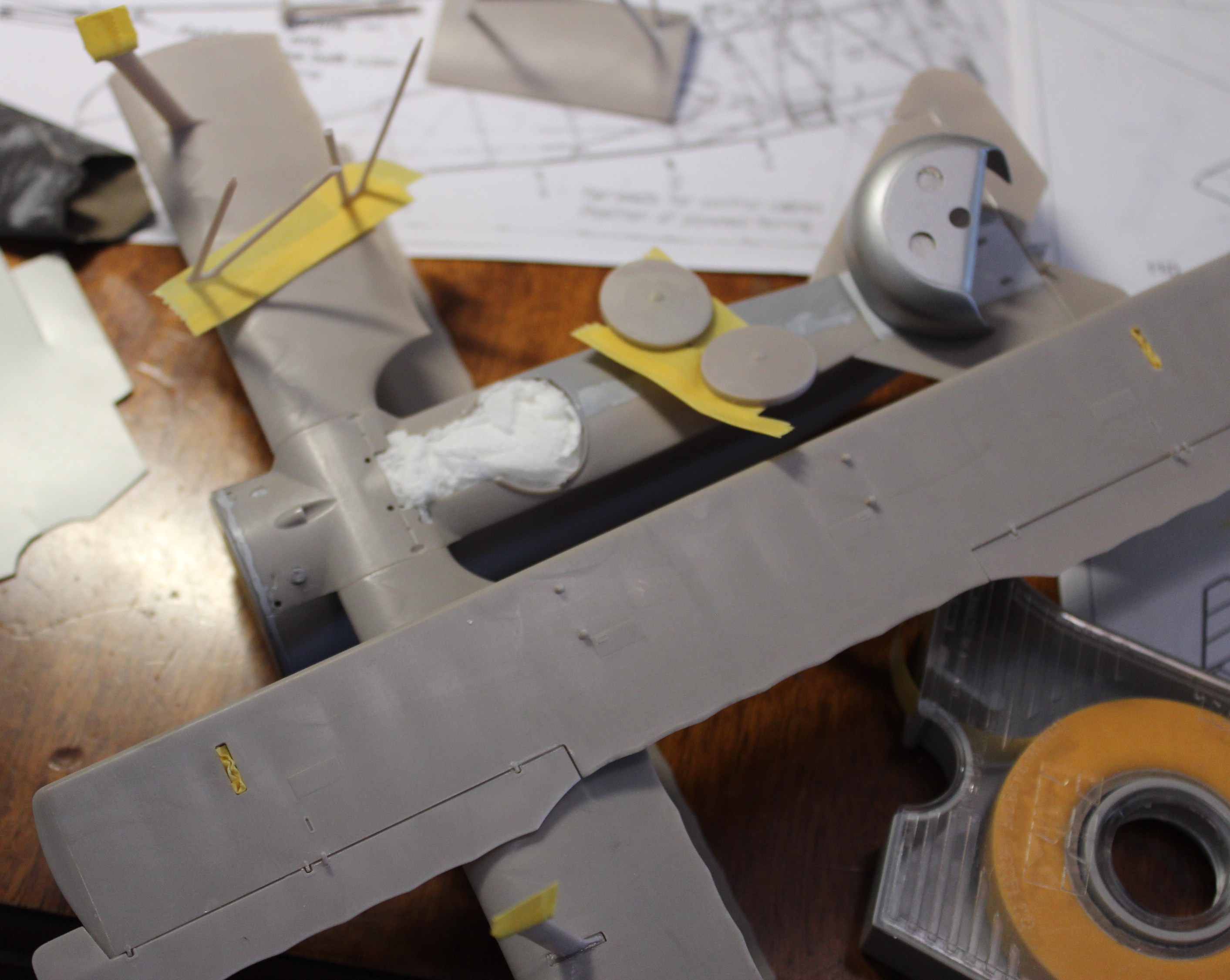

So, on with the build... did the masking now, tissue crammed in the cockpit, but careful marking of the upper strut attachment points... to prevent fitting problems later!
Then a very thin coat of a brew of flat black, medium grey and my last bit of Nato black, Tamiya acrylics, thinned with their thinner and a touch of gloss and a drop of acrylic retarder.... (Mix really well, dance around it three times making whooping noises and you're good to go...)
Wait a minute, I hear you say, this wasn't going to be Josef Jacob's Dr.1... Well, this is just the first undercoat. A dark  glossy colour kills the translucency of the plastic and shows up flaws much, much better than any other colour, have you ever owned a black car? The armour modellers are into "black-basing" these days, where they start with a black colour and go to successively lighter shades to get that 3D effect, I'm not really aiming for that but it may help... Need to let this all dry...

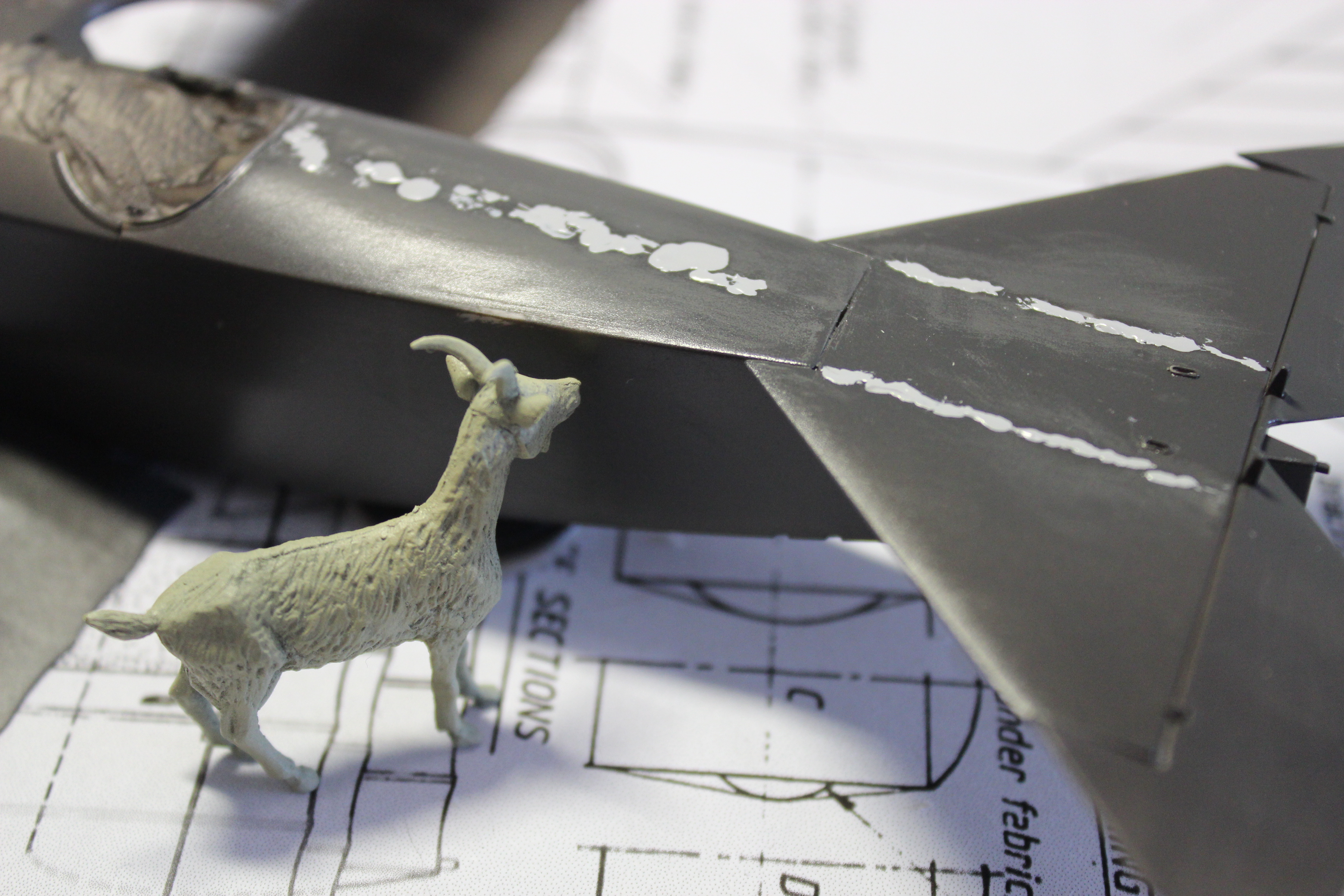

Heh, Heh, Pepperman! Yes, It's worth bleating about, and helps head-butt the build along... Rick, my joints just weren't up to scratch, and I had to revisit them...
And I forgot the struts under the tail-plane...
And then out with the sandpaper, not for the squeamish....
Even the goat is disgusted ... he's actually just there to help the colour contrast... Hopefully I'l get some time to proceed over this festive season, so best wishes to You and your Loved Ones!

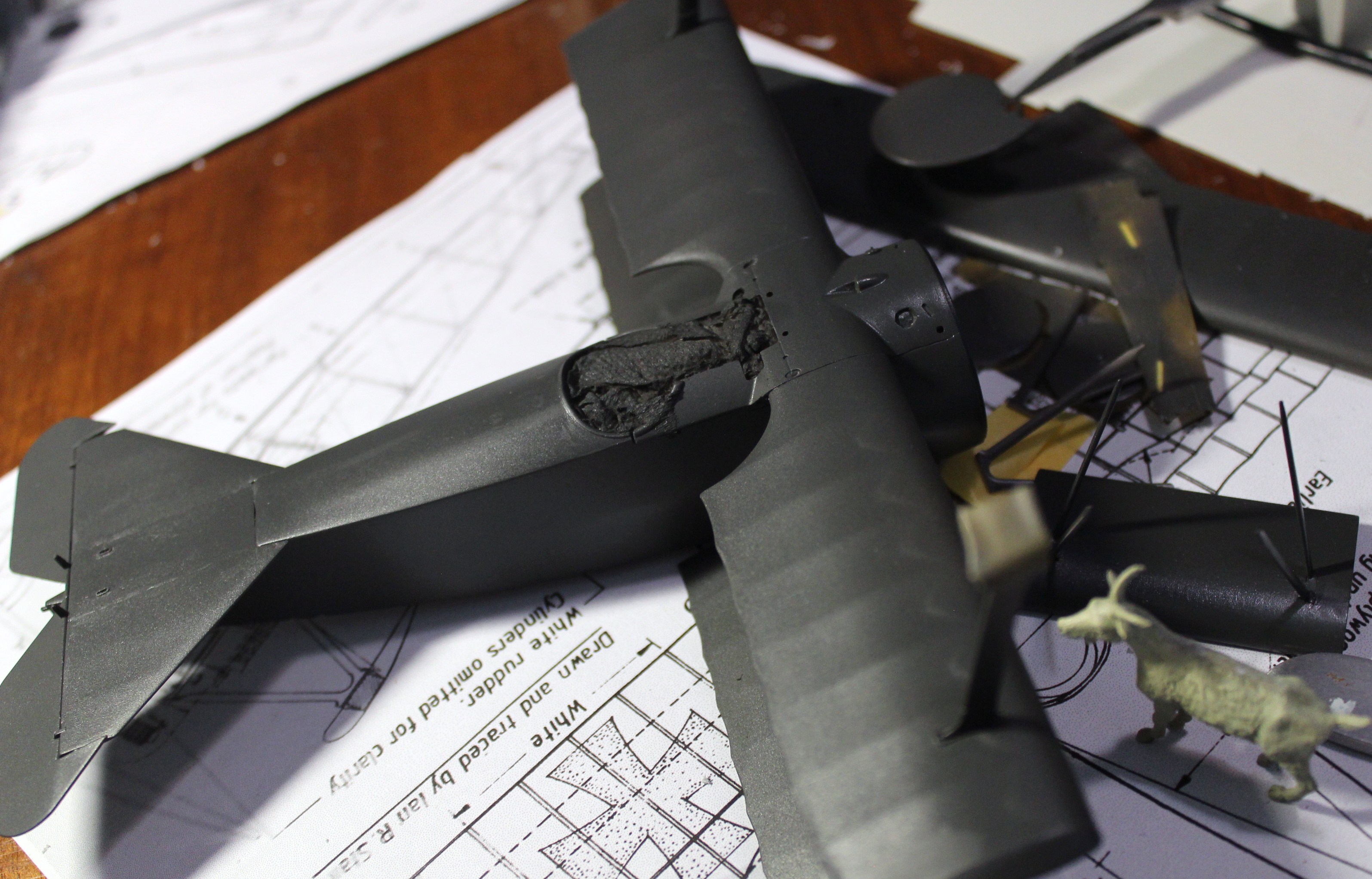

Rick, you are so right about that seam! Just like the WNW DVII in fact... and it needs multiple tries with filling, sanding and re-coating... and here is try number 2...
... and doesn't look so good... You can see the rough areas on the centre line join and my tailplane "fix"... so did some sanding...

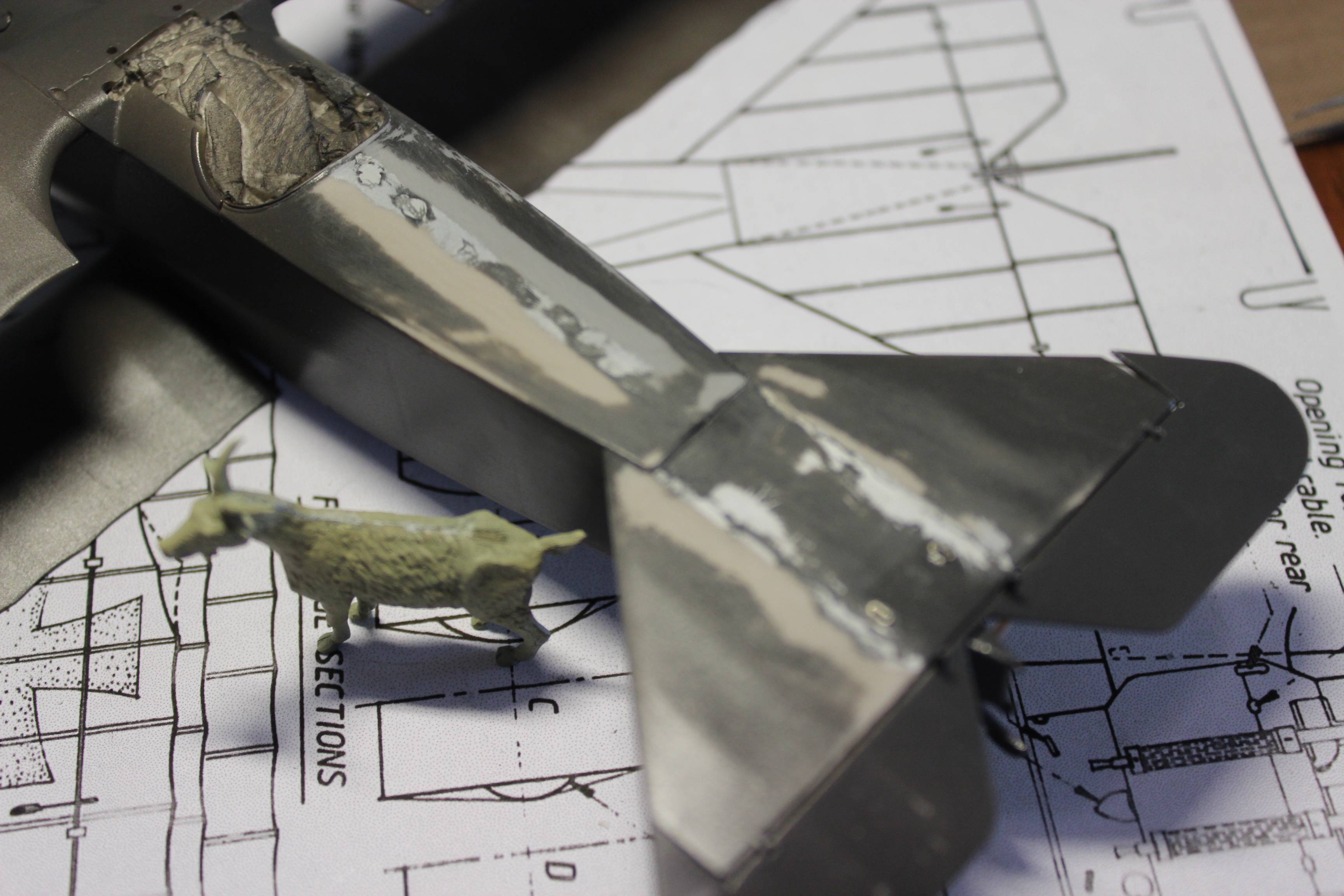

... and looks like a mess all over again... How could I miss that sink mark near the wing tip??
Will need to primer this again...
