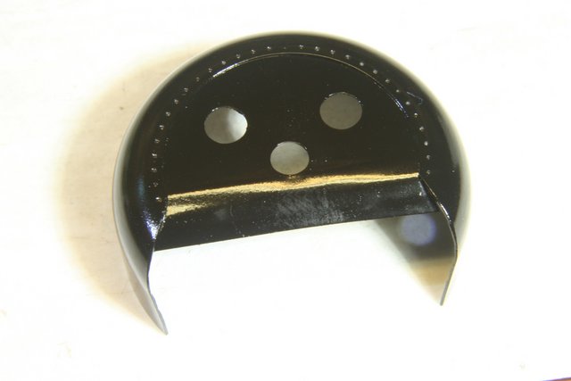

That cowling is drool worthy.  What tool do you use to cut the fragile part?
Re: Roden 1/32 Fokker Dr.I Josef Jacobs
« Reply #31 on: June 17, 2020, 09:19:03 AM »
Thanks for commenting, everyone.  I'm gaining more experience machining these thin pieces but every one has a high pucker factor.
GazzaS - don't know which part you are referring to.  Both parts are fragile.  I machined the main cowling on a lathe and drilled the rivet detail on a mill.  Then cut the cowling piece out using a jeweler's saw.  The faceplate was drilled, then cut out using scissors, followed by filing into a final shape.  I did some grinding on the cowling with a Dremel tool to thin it out more from the inside in a few spots.
I got the engine, cowling, and firewall fitted together, but had to cheat.  The engine is pushed up against the firewall and I had to remake the firewall from thinner material to get everything together.  Otherwise, the cowling would have had to be too thick, or wouldn't have fit over the engine.
This is what I wanted to know.
You see....  a while back....  I built the 1/48 Monogram B-29 and foiled it.  But I wasn't happy with the way the foil looked around the canopy glass.  So, I tried to make the whole canopy framing out of aluminum.  I used a hammer and dies to beat a flat piece into the shape desired by shrinking.  BUt one of the things that I never figured out was how I would cut out the holes for the clear parts without warping or mashing the framing.  It's a moot point anyway as the project languished and finally got round-filed.
Thank you for your answer.
Gaz

That is also a interesting question: how do you prime alu? I had big trouble and prefer only alu parts if I can leave them unpainted.
Even CA do not hold, my best experience was the clear Gunze "Mr. Metal Primer" and let it cure long enough before painting the final color.

Frank, for aluminum, I have been using Tamiya white primer, sprayed on very thin leaving some metal showing through.  Paint still scratches off easily though.  I read that paint won't stick to aluminum because of the smooth surface, but I'm not totally convinced that is always the case.  There are primers for aluminum available in stores here.  It has a acid that etches the surface so paint sticks to it.  I don't know what happens to the acid, though, whether it just stays on the part or get neutralized somehow.  I may try some of it someday.

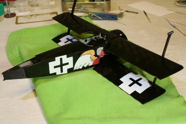

Anyway, time for an update.  I've been working on numerous things, all in progress at this time.
Cowling painted black with smudged fingerprints on it.
It has two out of three wings on it.

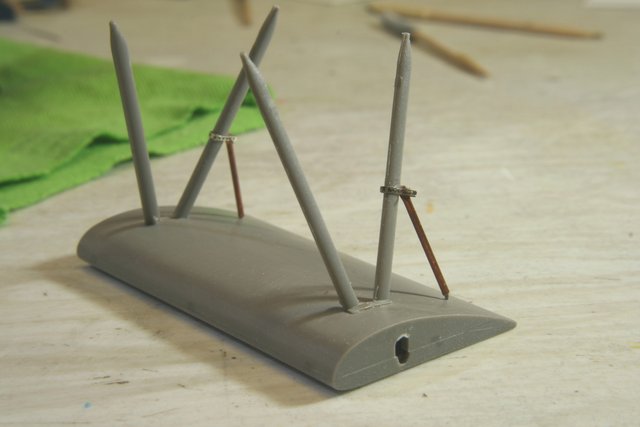

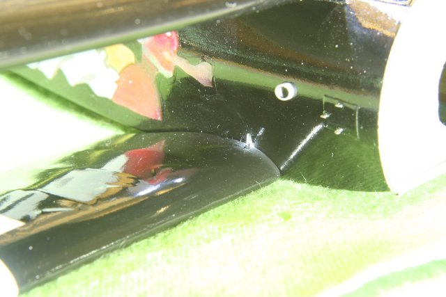

I can't believe how weak and spindly the landing gear legs are.  There are no attachment points either.  Hopefully, Meng/WNW has addressed this on their kit.  I was drilling some shallow holes for the legs to locate in, when the drill blew through the fuse just above the wing root below the engine intake.  Another repair job to do!  One can see how easily dirt and dust shows up on a gloss black surface.
Jacob's plane had these reinforcing struts on the landing gear.
