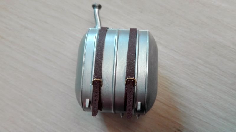

Today there are a few pictures of the cockpit.
After the rigging of the fuselage is done so far, I have dealt with the further installation of the cockpit. I fitted the petrol tank with two straps before installation.
Furthermore, the ejection for the cartridge cases, the dashboard and the fire protection wall for the engine was installed. The pilot's seat and the two machine guns are not yet glued. So far the current status.

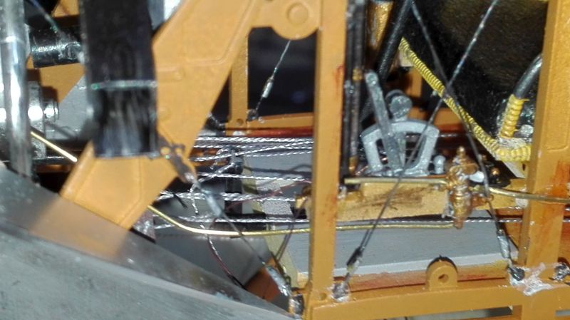

« Reply #36 on: February 22, 2020, 08:31:41 PM »
Hello everybody,
thanks for your comments.
The control cables are laid and aligned. Originally I just wanted to tie them to the eyelets, but would have given myself the opportunity to align the ropes properly. So I first pulled a piece of brass pipe over the rope, then passed it through the eyelet and finally pulled it back through the brass pipe. Now I could tension the rope the way I need it. Everything is secured with a drop of super glue. Unfortunately, this didn't work with the full flexibility of the rudders  :-[ . This is because the yarn yields too much under tension. I also couldn't tighten it too much during assembly, otherwise it would have broken out or deformed the plastic eyelets  >:( . I should have preferred to use my self-made metal ropes. Well, you can't have everything. But would have been a nice effect. So I'm going to continue with the cockpit.
