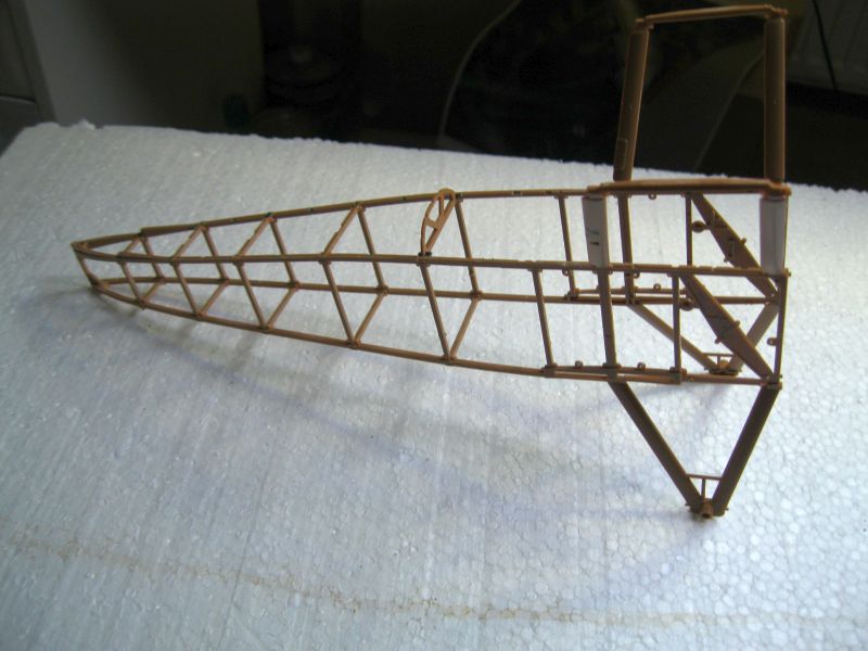

After the engine was ready so far, I pulled in the struts for the wings and fuselage. Each wing segment was fitted with nine spars, which fit very precisely. Due to the manufacturing process, there are of course a few ejector brands, but they are very flat and therefore easy to remove. The built-in spars were not filled, because in this case I see a slight gap at the glue points rather than natural. After all, it is a wooden structure. And since wood is known to work, gaps are quite legitimate. Hasegawa has included yarn for the tensioning ropes, which is only suitable for the control ropes. There are also only simple eyelets for the attachment points. I didn't like that at all. That's why I ordered Gaspatch Turnbuckles in 1/32. Although only 1/32 are exactly right for the tension wires inside the wings and fuselage struts. I'm still not sure about the tension ropes, whether they were rods or braided ropes. In the pictures of John S Shaw ( http://www.johnsshawaviation.co.uk/wordpress/sopwith-camel-f1-2/sopwith-camel-introduction ), which I took as a template, this is unfortunately not exactly clear. Sometimes it looks like ropes, sometimes like poles. What do you all mean? Depending on the version, I would then use brass wire or self-twisted ropes. Once all the turnbuckles are in place, I will apply the primer.
Fuselage

Just seen this - that will truly be a monster of a model when finished. Superb detailing there and I am very impressed indeed with the engine. This is truly going to be a super model when it is finished.
