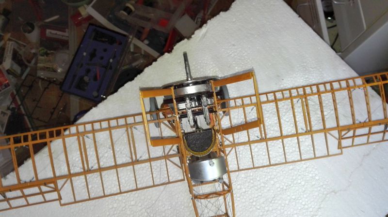

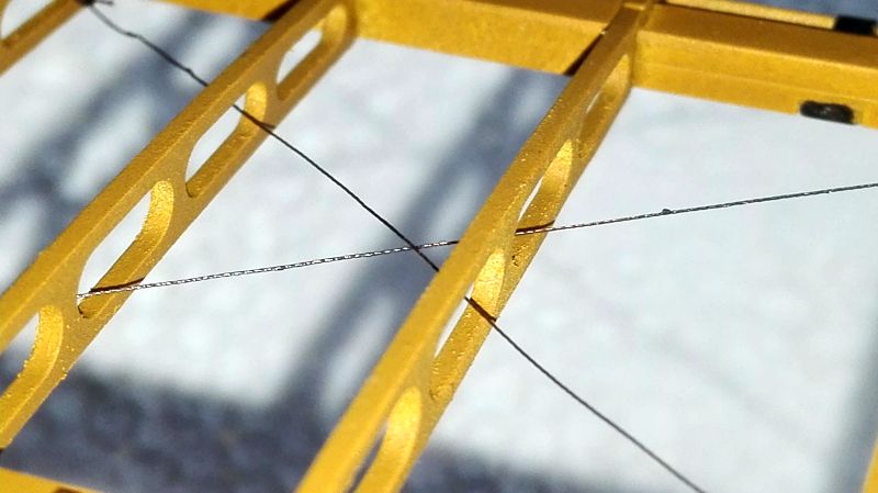

Hooray, the upper wing is also provided with tensioning wires.
The tension cables of the upper ailerons also work so far.
In the meantime, the fuselage has also been given new parts.
After gluing the three wing parts together, I figured there could be something more refined. Since the wing consists of a middle part and the two actual wings, I provided the transition with four hexagonal nuts (made from a hexagonal profile as a dummy), since the elements were probably screwed to the original (you can see on some photos from shot planes).
Juergen
Every artist was first an amateur.
Ralph Waldo Emerson (1803-1882)
