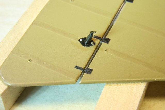

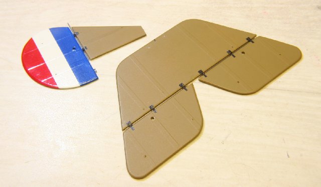

I have put the base color on the tail surfaces.  Will get to the control horns soon.  The black hinges are just tape stuck on the surfaces.

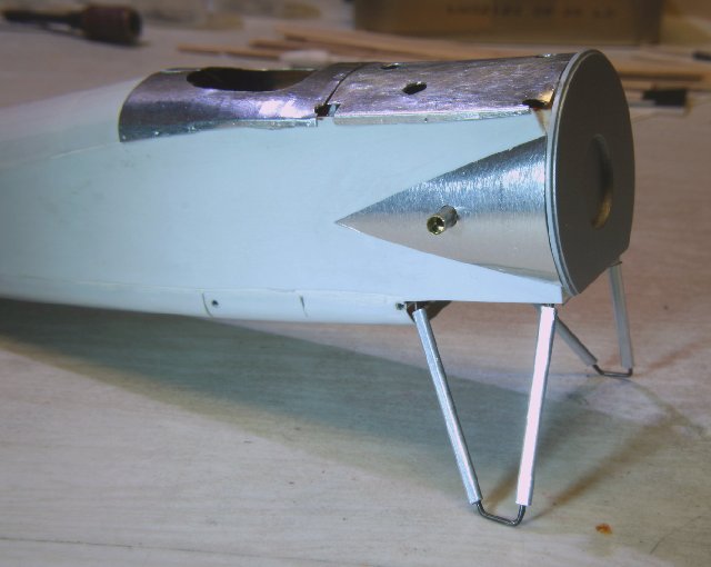

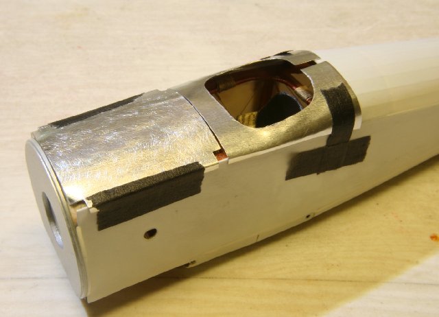

I have started on the front of the fuselage, with some metal panels.
somewhat slow going, but I like the results.

And nice work on the tape hinge fakery. A bit of painted tape can pretend to be a lot of things

Hello, Richard.  I'm glad the hinges ended up being so simple to depict.  I have added some detail to the metal panels and glued them to the fuse.  Turning to the landing gear now.  Pictures to follow.

Ken, I really like that idea to plate it with real metal sheet! Will try that too one day ;)

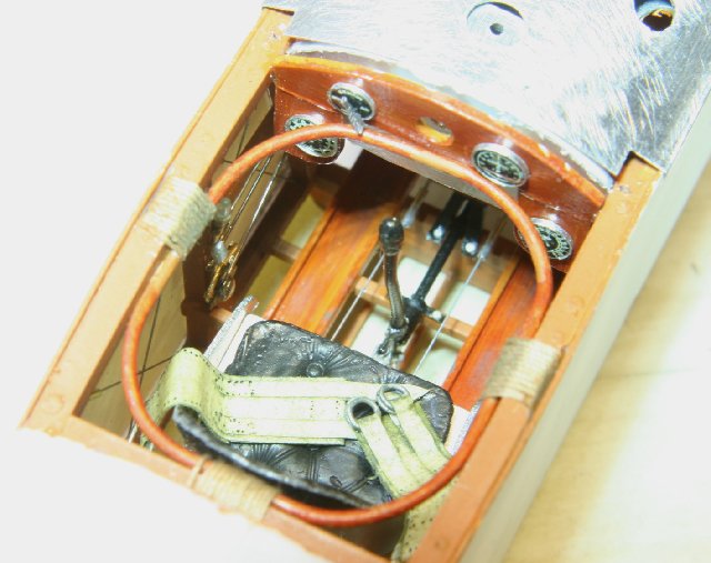

Latest pictures of the metalwork.

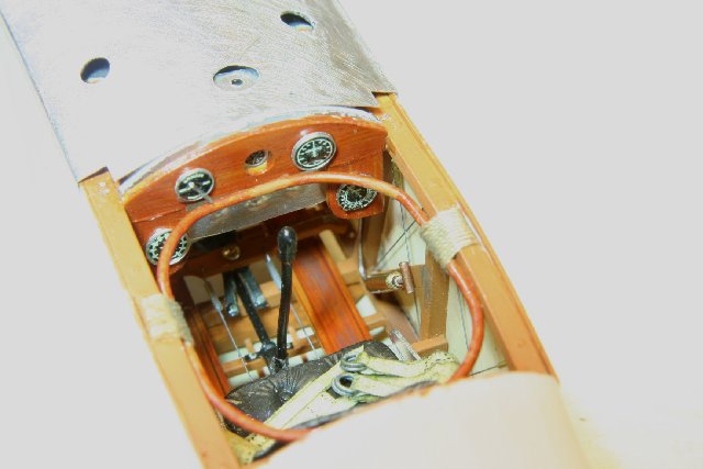

Last clear pictures of the cockpit before the panels went on.
Thanks for following along!

Brilliant Metal work and the interior looks awesome!

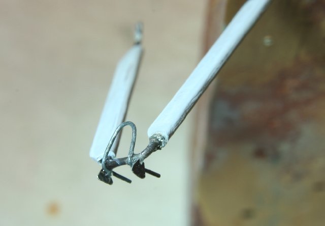

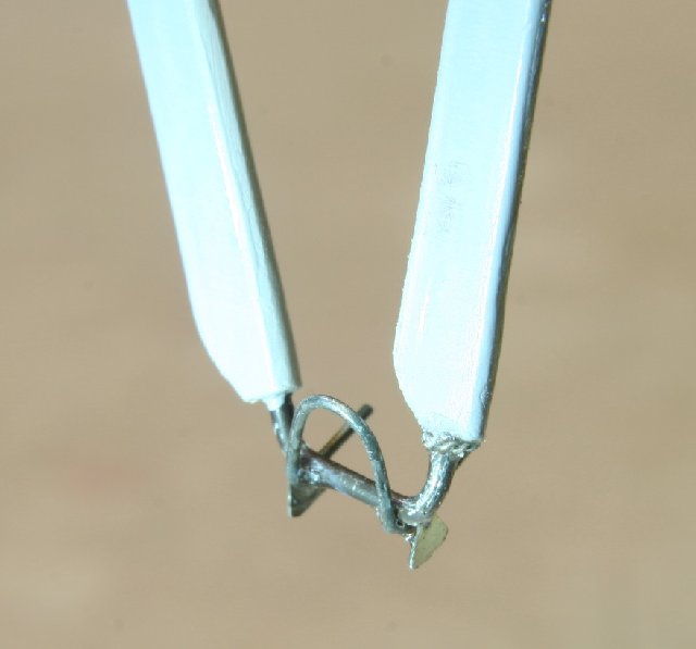

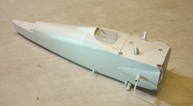

Some brutal closeups of the landing gear in primer.
Fuse in primer.
While waiting for primer to dry, I have installed some control horns.

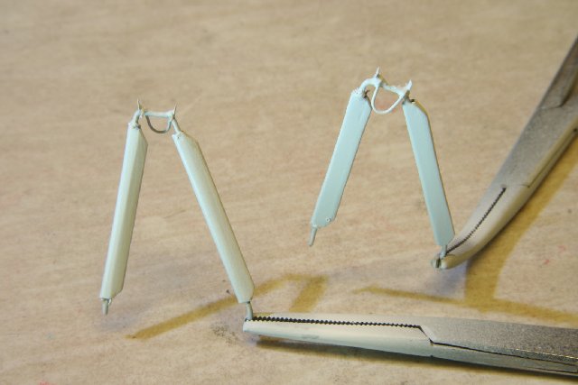

Starting on the lower wings now.  Layered up five 0.020" sheets of styrene with a slight bow in them for wing camber.
Thanks for following along.

How did you make the control horns?
Richard
Re: The Tommy
« Reply #88 on: March 02, 2020, 10:25:58 PM »
Hi Richard,
I thought long and hard about the control horns.  I ended up constructing them from a few different parts.
The base, though not completely accurate, are photoetched exhaust header flanges for an automobile exhaust system.  PE bolt heads, of course.  I believe they are from Model Car Garage.
The main part is a round toothpick, split part way down the middle, and the end of a PE control horn is CA glued into the split.  This part goes through the base into a hole in the tail surface and epoxied in for strength.
The PE control horn is from an Eduard PE sheet of control horns and flying wire tensioners.  I cut off the top of the PE control horn for use in this assembly.
I made six of these, so the process can be repeated somewhat consistently.

That's very clever, nice one Ken
