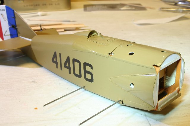

I've painted the fuse the base color and painted the number on one side of the fuse, waiting for it to dry. I used my Cameo cutter machine for those.  The small numbers for the rudder was another story.  I found some decals that would work perfectly, except that they were old and I had trouble getting them off the backing paper.  Slight damage to them, but they are so small its not too noticeable.

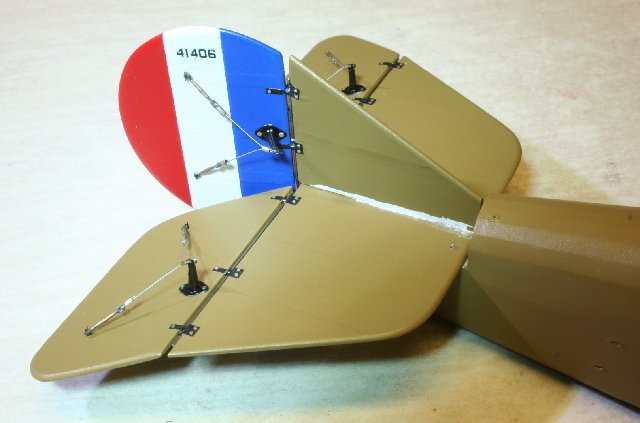

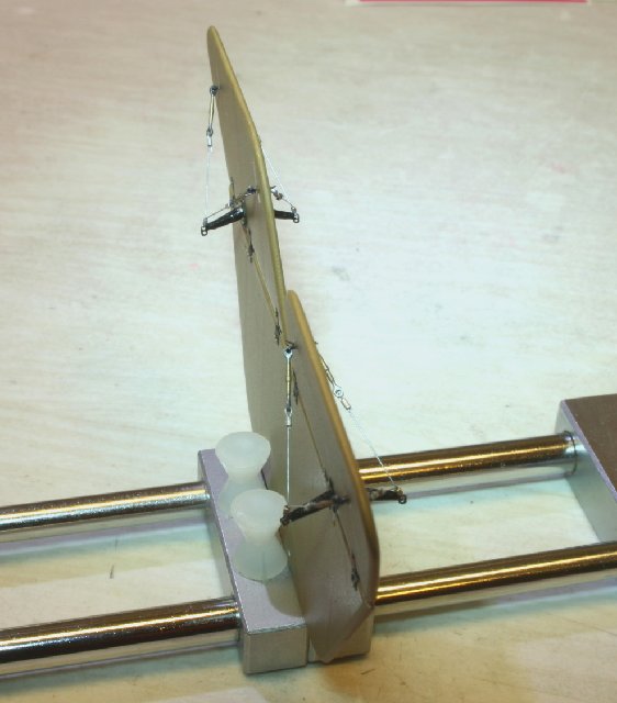

This gave me time to rig the elevators...

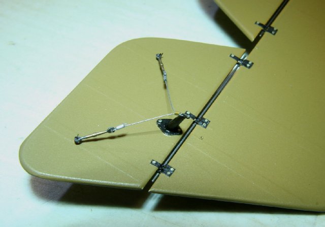

To get a turnbuckle on each side of the elevator, I ran some monofilament through the elevator three times, catching the turnbuckles in the loops and then securing with CA.
Finished rigging in the usual manner.

Nice work on the control horns and rigging Ken , those turnbuckles sure add to the effect .

Thanks, Terri.  I's no wonder why the real plane was tail heavy.

Did they actually have turnbuckles there though?

Excellent rigging on the Tail Ken. Really looks the part!
Yes, they went crazy with them.  They were small ones.
Realizing this was a trainer aircraft, I guess they wanted the ability to tweak things back into place after student pilots mangled them.
OK, you've checked. Most planes I have checked just used a simple wire with a twisted end to brace the trailing edges. There's no real need to adjust it, the adjustment is on the control cables

'Bout time for an update.  I'm working on the remaining details of the fuse, which seems to take forever, but it shaping up nicely.

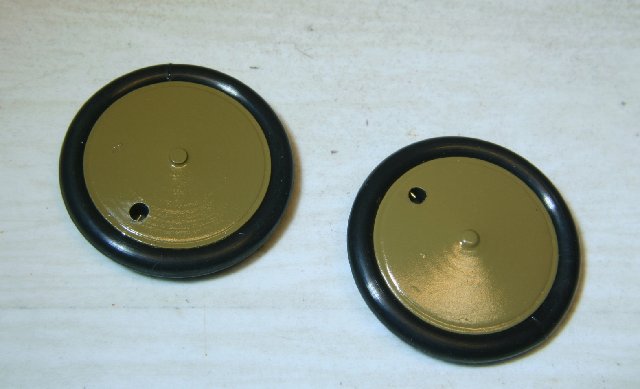

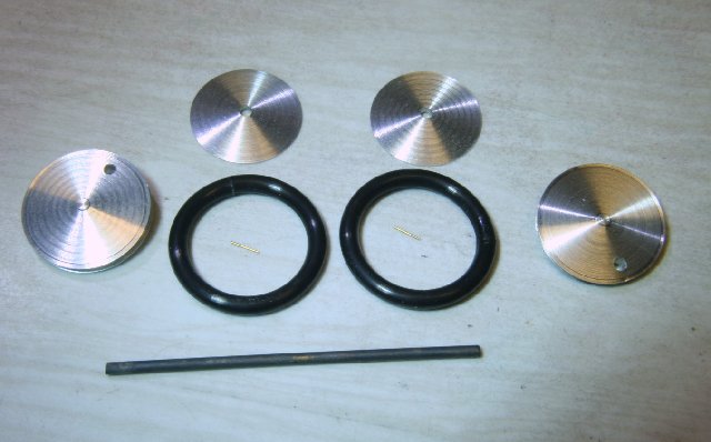

While waiting for paint to dry on the fuse, I knocked out the wheels.
Got the paint on and cut out some number masks on the Cameo cutter.
Now I'm waiting for oil paint to cure on the wooden fairings for the axle.  In the meantime, I've started on the wings.

Wheels, painting , and Markings look beautiful! Stunning work!
