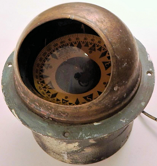

Hi Roberto,
The 'dome' on the decking just in front of the pilot's windscreen?
It's been suggested to me that this could be a binnacle mount for a compass.
Similar to those that are sometimes fitted to wooden boats.
Apparently a hole the diameter of the compass cylinder is cut and the assembly drops in and is secured to the deck with screws through a flange at the base of the dome.
In the rear of the dome is a window that allows you to view the compass floating inside.
The picture below is similar but this example has a flip-up half-shell cover rather than a full metal dome with a window.
What do you think - could the dome have been a compass binnacle?

« Reply #215 on: March 09, 2020, 08:46:06 PM »
Hi Mike!
I'm sorry but this time I have no idea about the "dome" in front of the cockpit. First it was not standard feature, as you sure note. I think you have the "more close to reality" answer to this. I was thinking about a counter for the Vickers bullets, but this was a feature that I never saw on our planes, so I think compass can be the right suggestion. I don't want to say stupid things without proofs.
About red/green striping on fuselage you are right. 7288 and 7292 are close in Macchi's line production, the M.5 left factory with serial number, fuselage roundels and red/green sections under the wings and on rudder too. Striping on fuselage was added in the hangars, as personal insignia (on floats too), number inside Squadriglia and (as 7292) roundels under the lower wings. The last was NOT a standard feature. Official bulletin from our Ministry of War ordered that roundels under lower wings on flying boats must be painted INSIDE color section on wingtips, with color reversed to see the roundels. So, green outer color of roundel in the red section and viceversa. You may noted this in photos of first L.1 delivered by Macchi, L.101, copy of the Lohner L40. But this rule was soon abandonated and some pilots asked for roundels outside of color sections.
I'm sure you not forgot, in next steps, to paint natural metal the sheet where Vickers fires out of the bow.
Hope useful again!
Roberto

« Reply #216 on: March 10, 2020, 02:02:58 AM »
Hi Roberto,
Once again thanks.
Unless anyone can throw light as to what the 'dome' actually is, then I think I'll go with a compass binnacle.
It makes sense as the pilot's would have been operating over the sea for most of the time and as such did not have land reference points for navigation.
A compass would have been a good instrument to have fitted, even if it was a option rather than a standard fit.
Interesting information about the reversed colours for roundels painted over the red and green colours on the wings - something I didn't know.
That said, as you pointed out, M. 7288 did not have under wing rounds so that's not a problem for this model.
Yes I still have the stripes to paint as well as the metal finish on the gun ports and rigging plates.

Hi Mike,
I want to add something to your/my suggestions: as a pilot, I think I would add a compass clearly visible (the dashboard of the M.5 was in a dark position, also with the "light holes" above). On the other side, again as a pilot, my range of war missions is clearly visible from the high, from Venice to Pola by air was only 136 km with many points used as references in the middle, as all the cities on italian/croatian coasts.
It was really difficult to lose your way home. Maybe night missions?
I know that mine are only speculations, the only thing I want to point out is that Adriatic see was a really out of "standards" as war frontline.
But, again, no things better than a compass came to my mind to help you.
My two cents, this time at 100%.
Roberto

« Reply #222 on: March 11, 2020, 06:50:32 AM »
Hi Mike,
Roberto
Hi Roberto,
Thanks - I've added this information into my build log.
I'm going with a binnacle housing and compass as being the most probable.
I'm going to try to represent a binnacle housing with glass window, rather than a 'solid' dome.
I've cut and shaped the housing and hopefully fix it over a compass decal then infill the 'glass'.
We'll see,

« Reply #223 on: March 11, 2020, 07:42:16 PM »
Oh yes!
Great idea to realize a binnacle housing with glass window. I agree 100%.
Maybe a complete glass covering, like a "snow ball"?
In the photo of left side the light reflection on the "dome" is the same as on the windscreen, this is the source of my doubt.
Now I shut up myself and continue to follow your fantastic work!
Roberto
