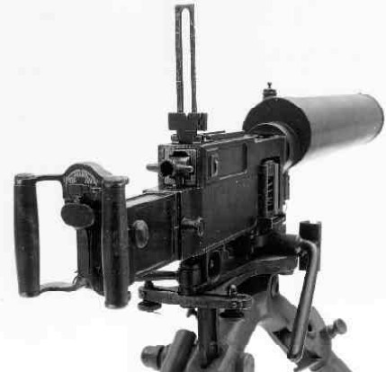

Seriously, I had doubts about the presence of the handling system on the back of your Vickers,
because I didn't found traces in original dwgs, after I found THE photo that I think you used as a clue.
Congrats again!
Roberto
Online Mike Norris (UK)
  • Posts: 2718
Re: Macchi M-5
« Reply #161 on: February 14, 2020, 11:25:13 PM »
Hi Roberto,
Now that's an idea  ;D
Yes the guns are mounted horizontal, not vertical, which was usual.
I believe the Macchi M.5 was fitted with twin 'FIAT Revelli' machine guns, adapted from the land version.
