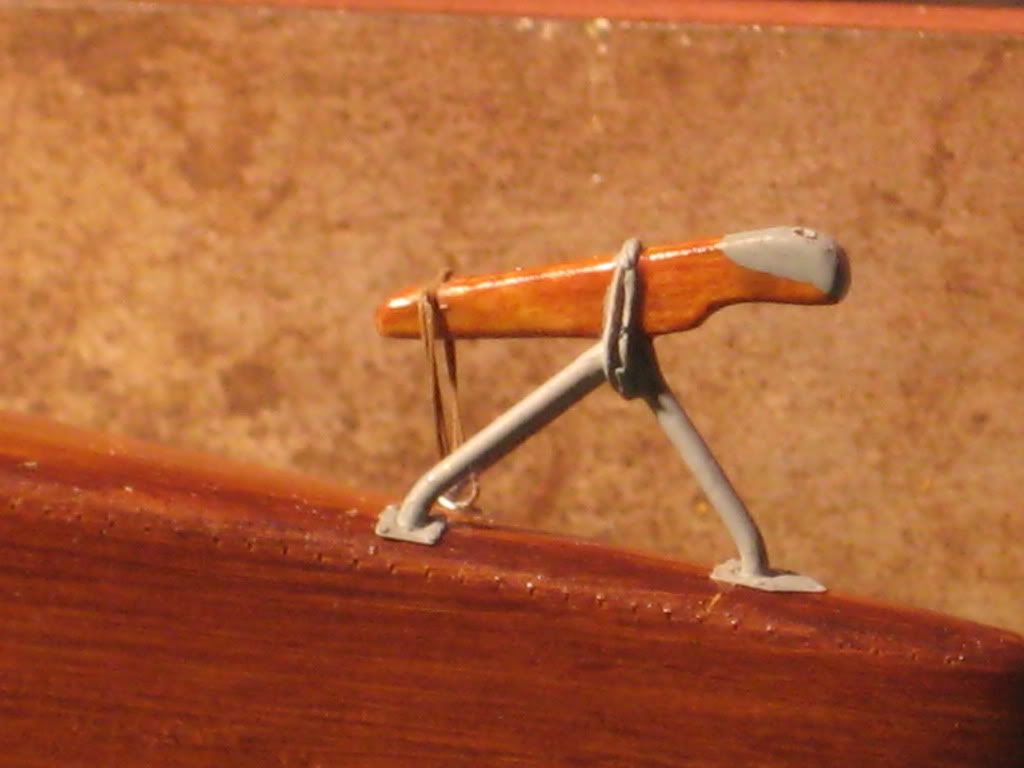

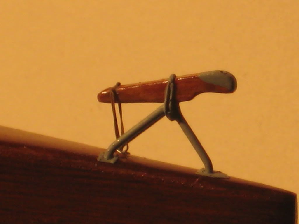

Still moving ahead, but the M-i-L takes over my modeling room on Sunday, so progress will definately slow.  Nonetheless, I am very excited about my work over the last couple of days, since I managed to complete and install the tailskid, an effort I approached with great trepidation, as it is quite fiddly and delcate in design.  Here it is:
I am very pleased with this outcome.  The metal tripod armature is two pieces of brass rod bent to shape and the soldered on another simple wooden jig to form the tripod.  The skid itself was cut and sanded/filed from strip styrene and then painted in wood with metal fittings.  It was CA'ed to the pivot point of the tripod, then the joint was wrapped with 32 guage beading wire CA'ed in place then painted.  To secure the bungee shock absorber to the fuselage, I made a small eyelet from 34 guage beading wire and drilled a hole for it between the tripod attachment points on the fuselage.  The bungee is rigging monofilament wrapped, CA'ed in place and painted.  The brackets at the tripod attachment points on the fuselage are from the PART Albatros PE set.

Outstanding tailskid, it would almost make a display model by itself!
« Reply #201 on: April 20, 2013, 02:01:45 PM »
Nice work. Looks sturdy too!

Outstanding work on the tail skid Bob, very intricate but you have pulled it off beautifully, well done.

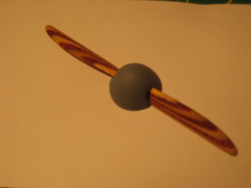

Here's the latest: I vacuformed the spinner from a plaster master made from a rubber mold formed around the WNW Junkers J.1 spinner.  Here it is with the Doug Craner Knoller-Jaray prop:
The wing strut blanks are shaped from bamboo skewers and the JH biplane jig is assembled and ready.  Aircraft major component assembly is just ahead!  Getting there! :D

Bob, this could pass for a WNW kit.  Only better.
