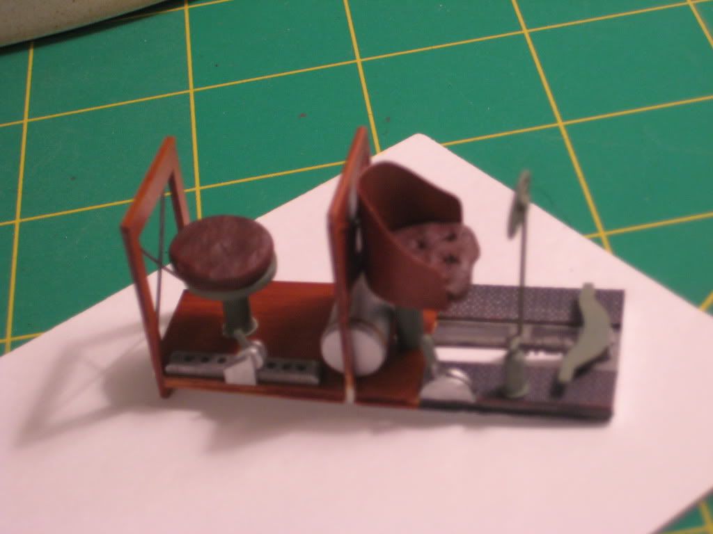

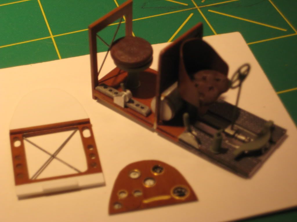

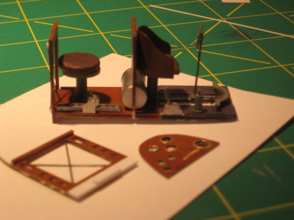

Here's the weekly update.  The cockpit is nearly finished.  I built it from Evergreen sheet, strip and tube stock.  The steering wheel was a leftover part from the Pup kit.  It's not prototype for the Lloyd, but I'm decreeing that the OEM wheel was shot up on a mission and had to be replaced quickly with whatever was on hand. ;)  The seat cushions were made from dark brown Sculpy modeling clay baked per the instructions then weathered lightly.
The wood parts were simulated by painting with Tamiya Desert Yellow covered with a mix of brushed out Burnt Sienna and Burnt Umber oils, sealed after dry with Tamiya Clear Yellow/Orange mix.  The wood grain can't be seen in the photos, but looks pretty good to the eyeball.  Metal shades are brushed on Mr. Hobby metal colors in appropriate shades.  The IP was made with Airscale instrument decals and Aeroclub bezels.  The observer's shelf/table is ready, but attaches to the fuselage side so must await placement until the cockpit assembly is in place in the fuselage.
Albatros 1234, thank you for your kind offer of the austro daimler engine.  I may take you up on it in the future for an OEFFAG Albatros conversion myself, but for the Lloyd I decided to model a WKF built Series 82 aircraft with Benz bz.IV engine, which I obtained from WNW.  That will be next, followed by locating and drilling the appropriate openings in the fuselage for the lower wing attachments, landing gear struts and tail.

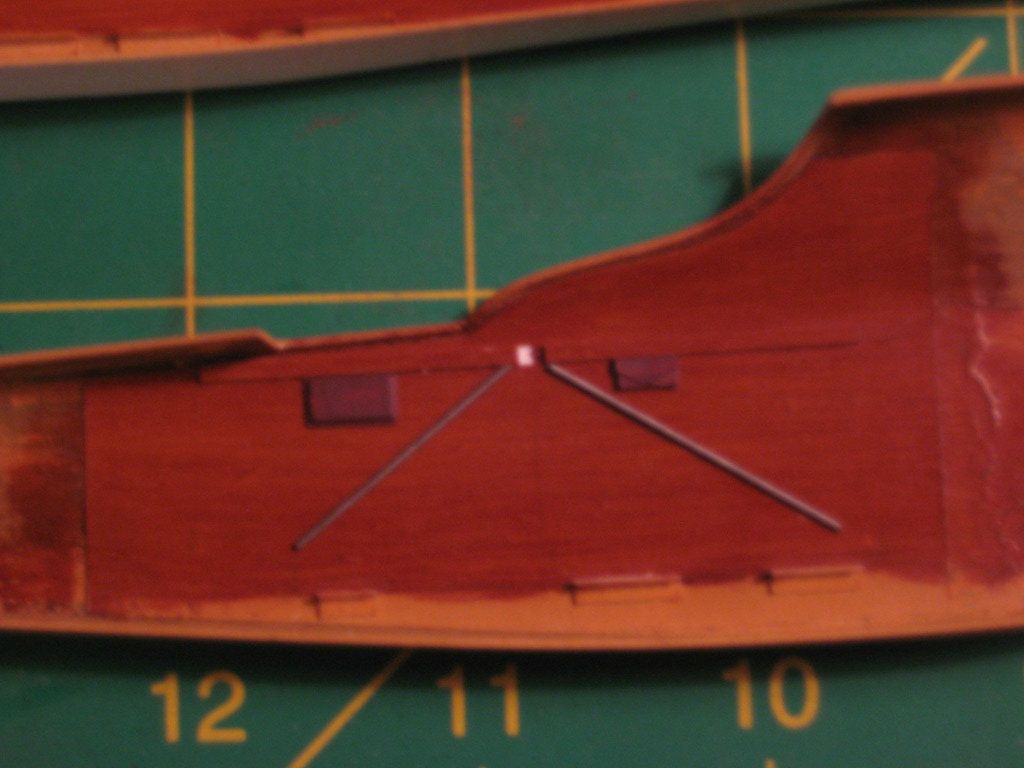

Here is another mini-update as I feel my way forward with this project.  The first photo is the fuselage sidewall interior, which still has some details to be added:

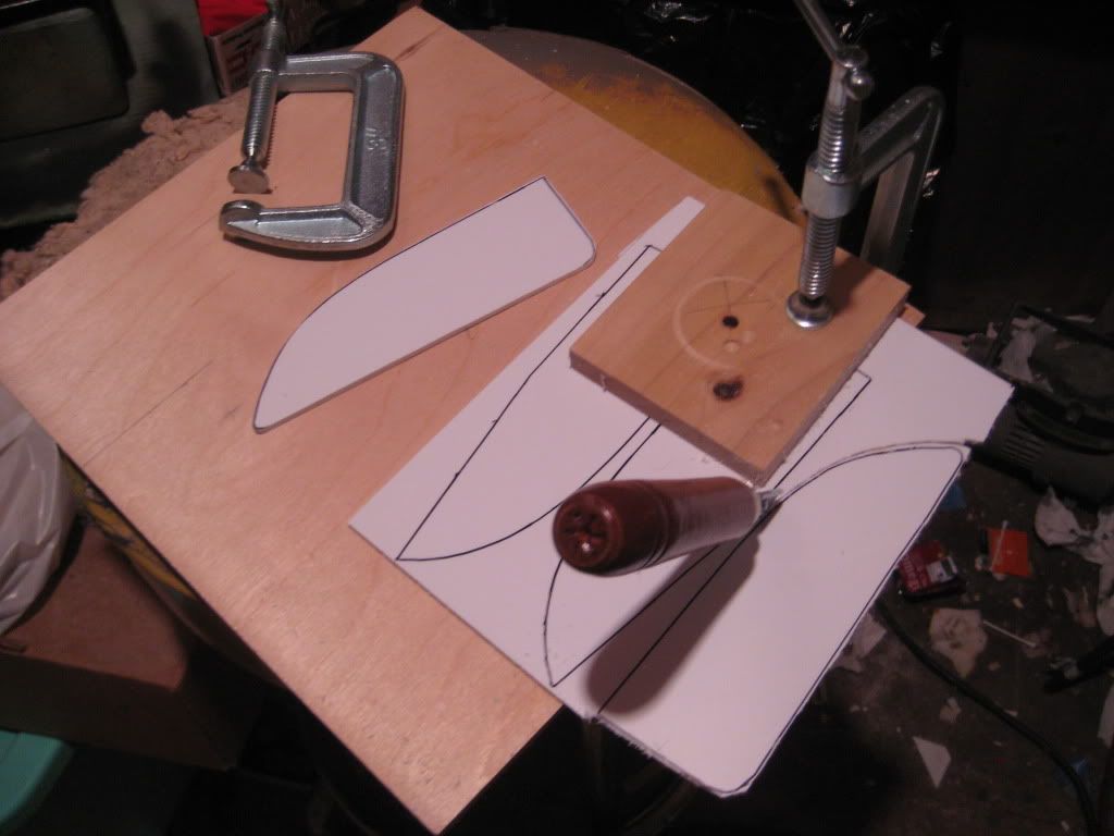

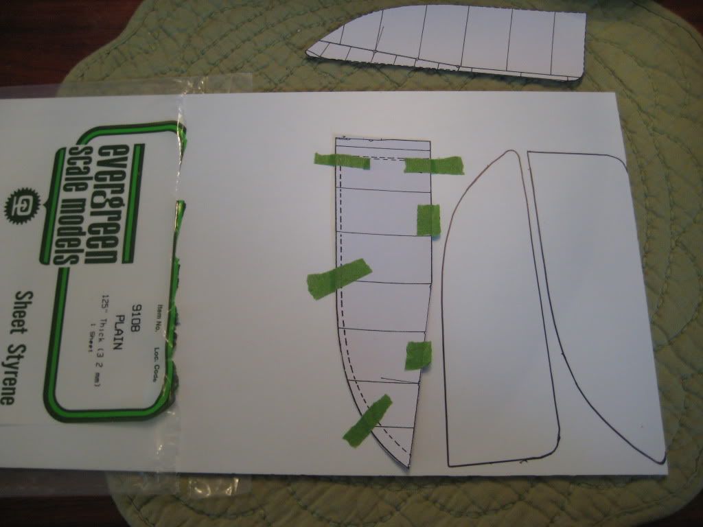

It occurred to me that I first need to do the wings, so I know how much space I have to work with in the wing cross-section, so I have laid out the wings on 3mm sheet styrene, as shown:

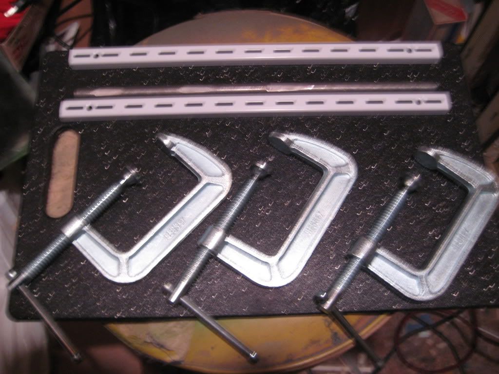

I will use the method Des followed on his Voisin to provide an airfoil shape to the wings.  The parts for th jig with clamps are shown in the photo.  I am using a plastic cutting board as the base and metal shelf brackets for the fixed guides.
I'll let you know how all of this works. :)

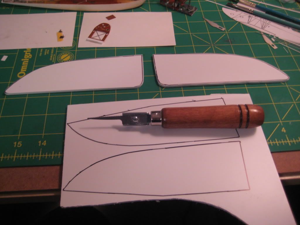

Before completing the cockpit and addng HGW seatbelts, I am proceeding with the wings.  Since I do not have a Microlux band saw, I am cutting out the 3mm thick styrene wings the old fashioned way--with a small razor saw blade:
The bottom wings are now cut out and require sanding to outline.  This takes a bit of time, so the top wings will follow tomorrow.
I am following the construction method outlined by Des in his Voisin build log.  The next step will be to sand the leading and trailing edges a bit thinner (but not all the way).  Then I will have to assemble the jig and proceed with clampng the airfoil curve into the wings and fixing with boiling water as per Des's build log.  Thereafter, I can sand the leading and trailng edges to proper shape and thickness.

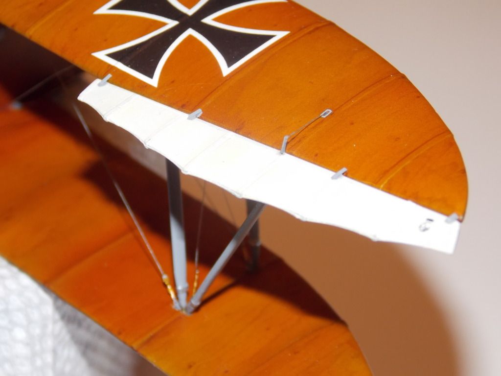

The Lloyd had unusual wings in that they were covered with mahogany veneer over spanwise stringers attached to relatively few ribs.  This makes the modeling much easier, as there are no ribs and stretched fabric depressions to worry about, just a few thin wood battans over the veneer seams running chordwise.  Here is an example on the 1/48 Special Hobby model, built by Peter Plattner:
Something to whet my appetite. :)  I hope my 1/32 version turns out this well! ;)  Beautiful work Peter! ;D
I had to include another example borrowed from miamiangler's build log, since Will's log has been so helpful to my project.  Thanks Willi!  Great job! ;D

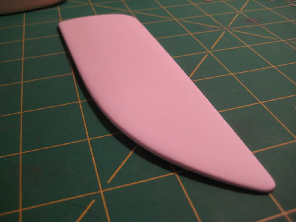

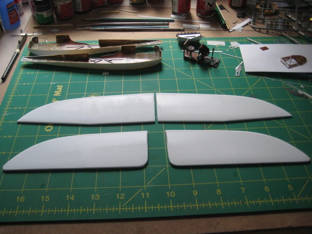

A little more still this evening.  Here are the rough-sanded wings before adding the airfoil camber:

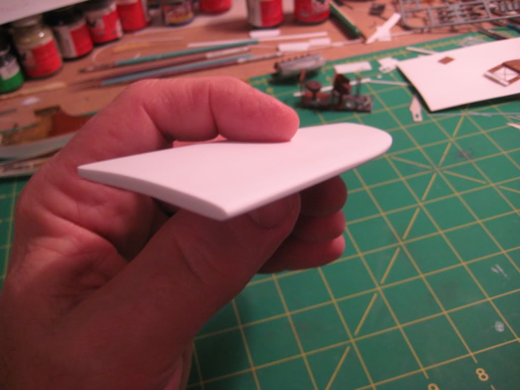

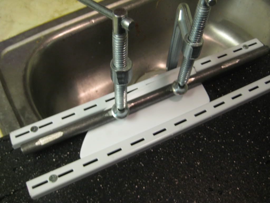

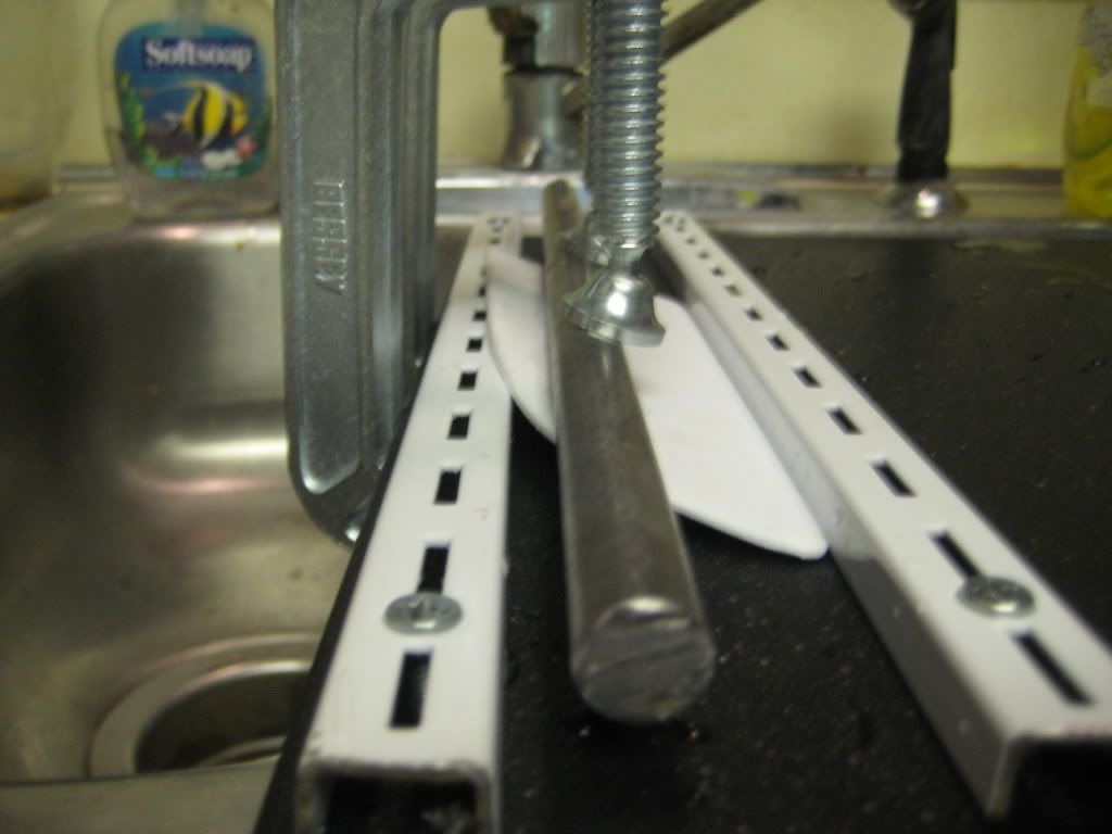

Next, the first one gets clamped into the Des wing jig to the appropriate camber:
Put the kettle on to a boil, douse the contents over the cambered wing, then rinse under cold water, and you get this result (after two attempts):
There is still a good deal of sanding to do to get the correct shape and taper of the wing, but it's well on its way.  Three more to do still (the other side of the bottom wing and both sides of the split top wing.
