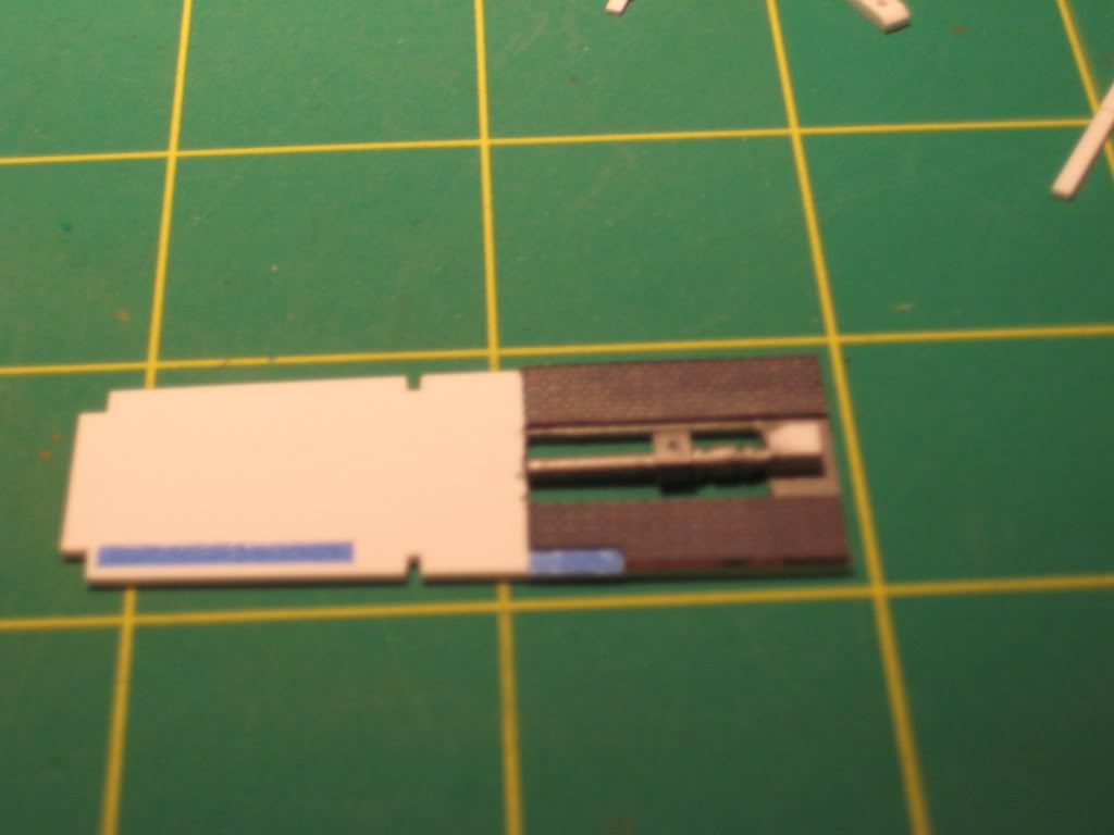

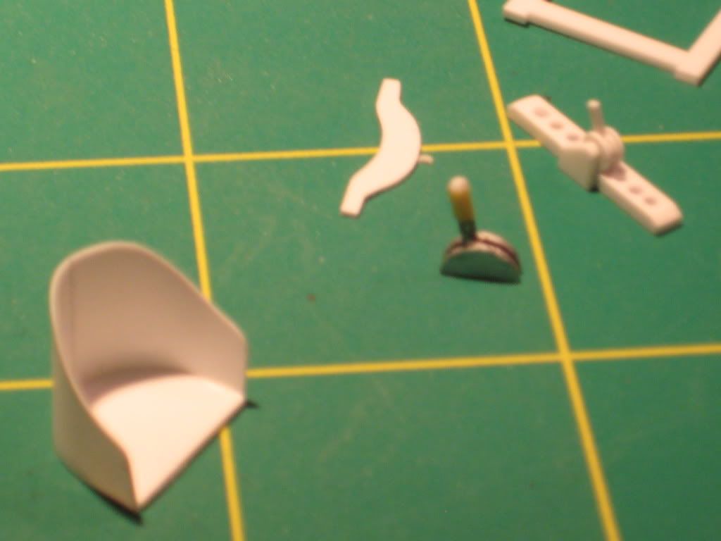

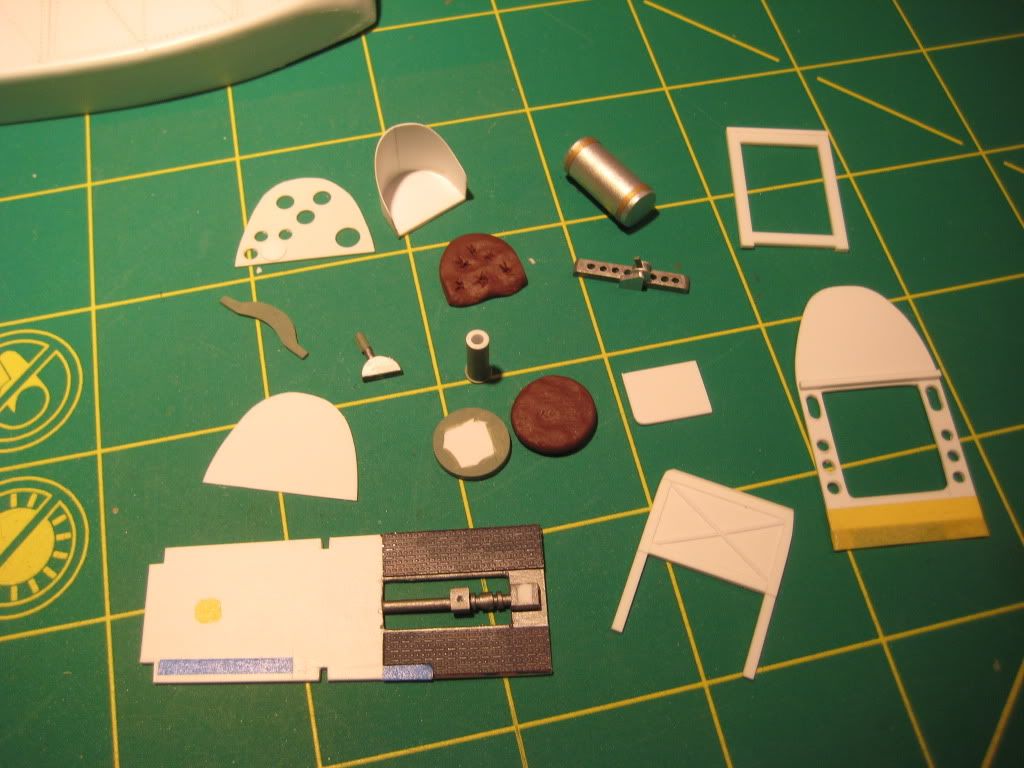

Here's a quick update, just to show I'm still at it.  Work and other things have slowed progress a bit.  Here are some pictures of the cockpit parts, which are being fabricated from Evergreen sheet and strip styrene:
Floor.  I still need to paint the base coat for the wood portions:
Seat and other bits:

Awesome work on all the interior bits, Bob.  Looking forward to seeing them all together.

Nice work on some of the fiddly bits. Looking forward to each post.
