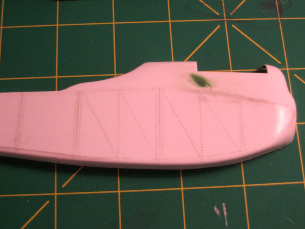

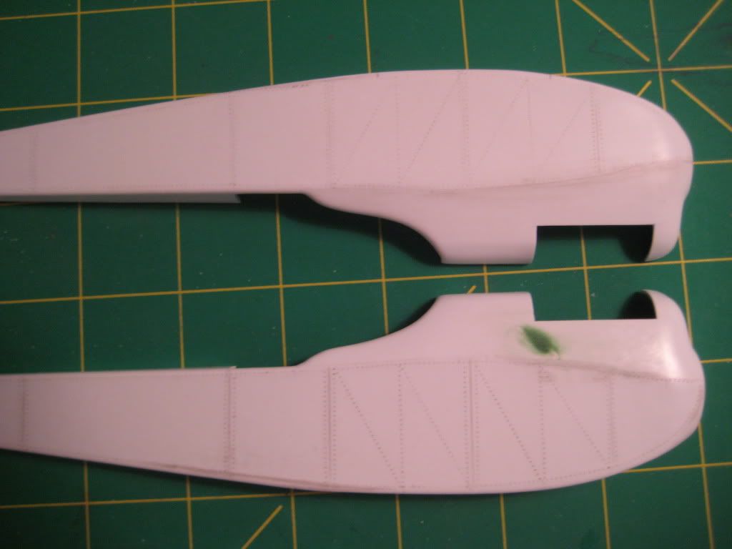

« Reply #59 on: January 02, 2013, 03:03:18 PM »
I'm baaaaaack (from completing the WNW Pup).  I've done the panel scribing and nailheads on the fuselage exterior, and pre-shaded them with a dark grey oil wash.  I also cut out the engine opening.
To make the interior fuselage sides easier to work with in light of the black paint residue from the vacuforming process (which would not sand away!), I made .10 skins for the cockpit sides, which I will affix with contact cement.
Next, I will tackle the cockpit interior, followed by the Benz B.IV engine from WNW.
