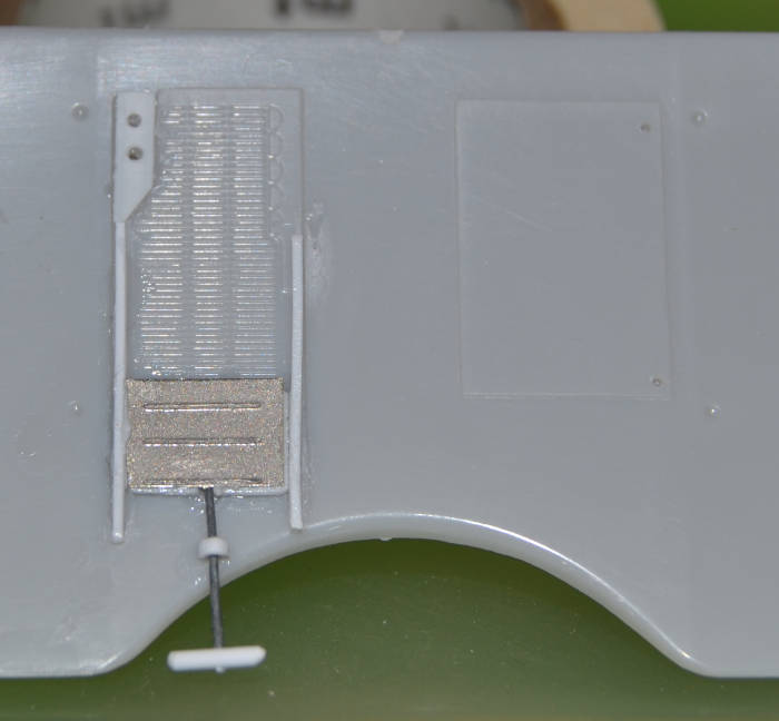

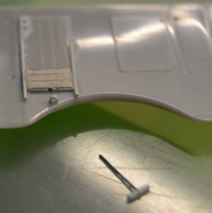

Then I worked on the radiator shutter on both the models:
BLUE MAX
EDUARD
Here I used just the PE rectangle because the handle was horribly flat, to give it some thickness and insert a 3Dish handle, I inserted a flat piece of plasticard and made a hole.
I also had to raise the two side rails to "let the slider slide".
In both cases I made a ring where the handles slide as seen in many photos on my references.
Thanks again for your attention!

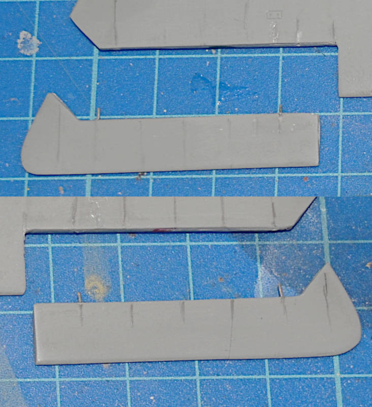

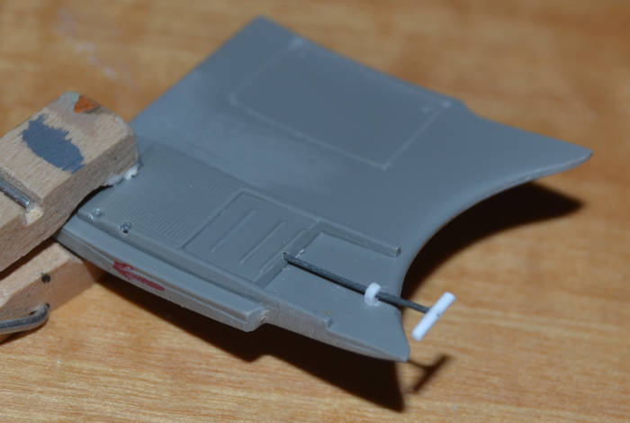

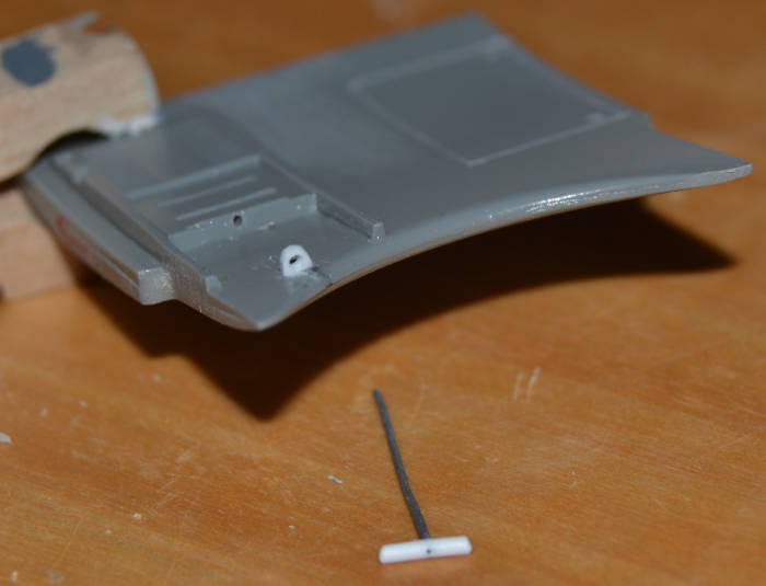

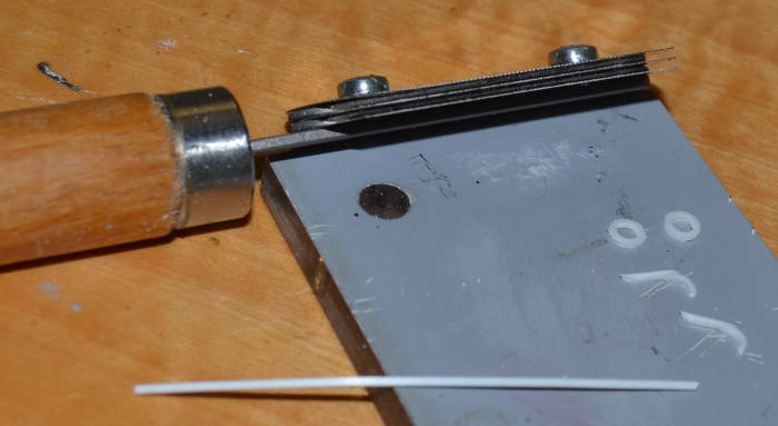

I went a little forward on this build thread:
I scratched  the mechanisms that control ailerons on top of the upper wing. I used a plasticard rod (side = 0,75 mm) and cut 2 circles from a plasticard tube using the razorblade saw with 3 blades and 2 x 0,75 mm spacers.
Oops, I don't see the picture and I can't see all the other pictures of my thread...
Any idea?

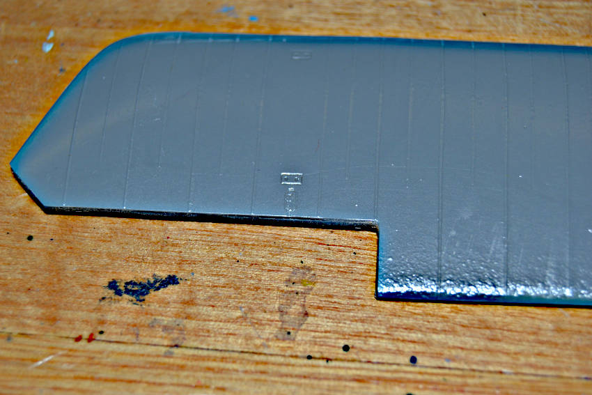

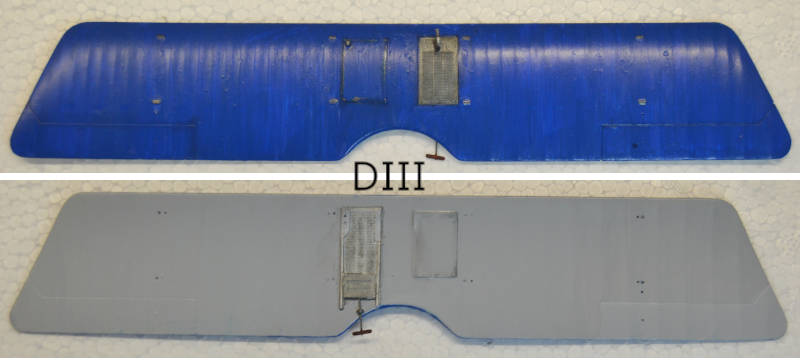

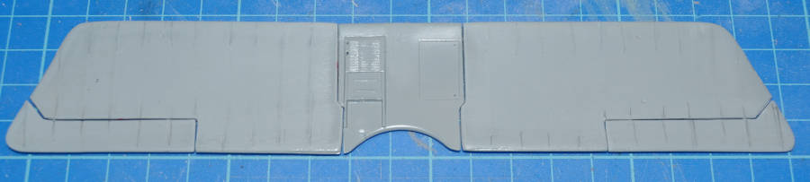

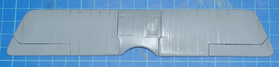

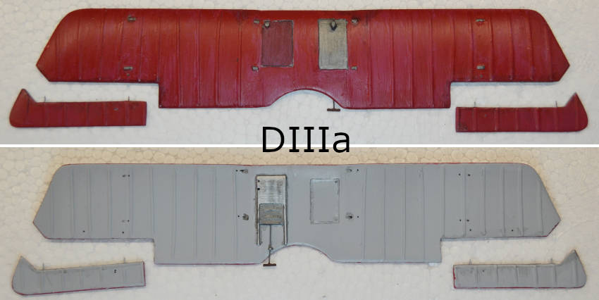

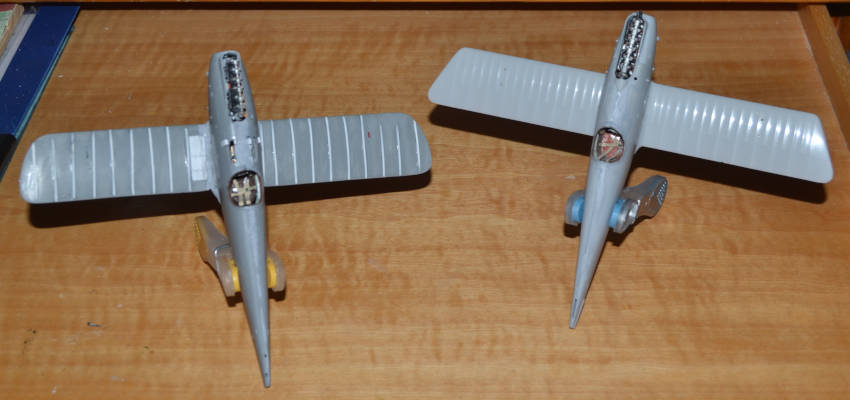

I also worked on the Blue Max DIIIa top wing:
I filed out the horrible "rib tapes" (here is how they were, I forced the contrast to let them show):

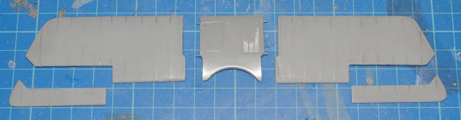

made pin holes and put metal pins in the 5 pieces making up the wing
Here are the pieces joined, just without glue, they will need some putty and probably some thin plasticard piece where the half round opening of the cabane joins the trailing edge
Thanks for looking!
Antonio

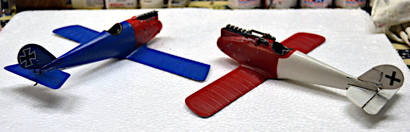

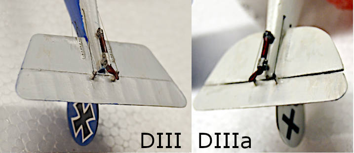

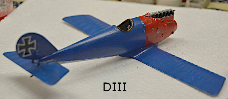

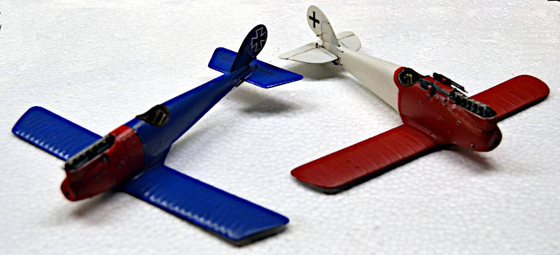

« Reply #114 on: March 23, 2021, 01:05:20 AM »
Hi!
The most elderly among you may remember this thread starded when pandemic was not even a known term for most of us...
It was February 2019!
Last post was in the fall of 2020, since then, as I wrote preiously, a lot of bad things happened to me and my wife and we are still in troubled waters although a light shines at the horizon!

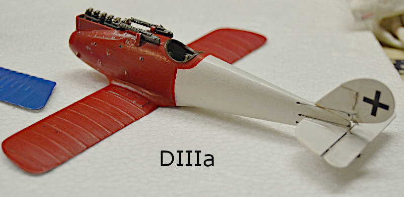

By the way I find some time to go on with the works every now and then and here is the result achieved so far which is meaningful enough to be documented:
The two friends are finally looking as planes now.
...top wings
...a few more details
Looking forward to posting something more soon I thank you for your patience and attention!
Antonio
« Last Edit: April 13, 2021, 11:57:56 PM by andonio64 »

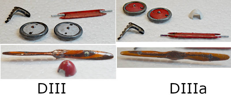

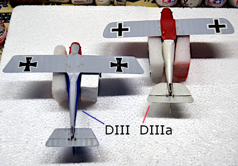

I like the propellers, although I would have preferred to coat them with clear yellow but it was totally dry and I had no chance to get another fresh jar in short times so  coated them in orange.
I also applied some decals of the brands.
The DIII is a plastic prop, the DIIIa is a white metal, both from the box.
I made an error: I primed the DIII with white primer and the DIIIa with gray primer, I had to do the other way round, but in the end the gray primer made off white look a bit more "off" and red a bit darker and the white coat made blue and red look a bit brighter on the DIII and in th end I like the final tones I achieved.
Antonio
