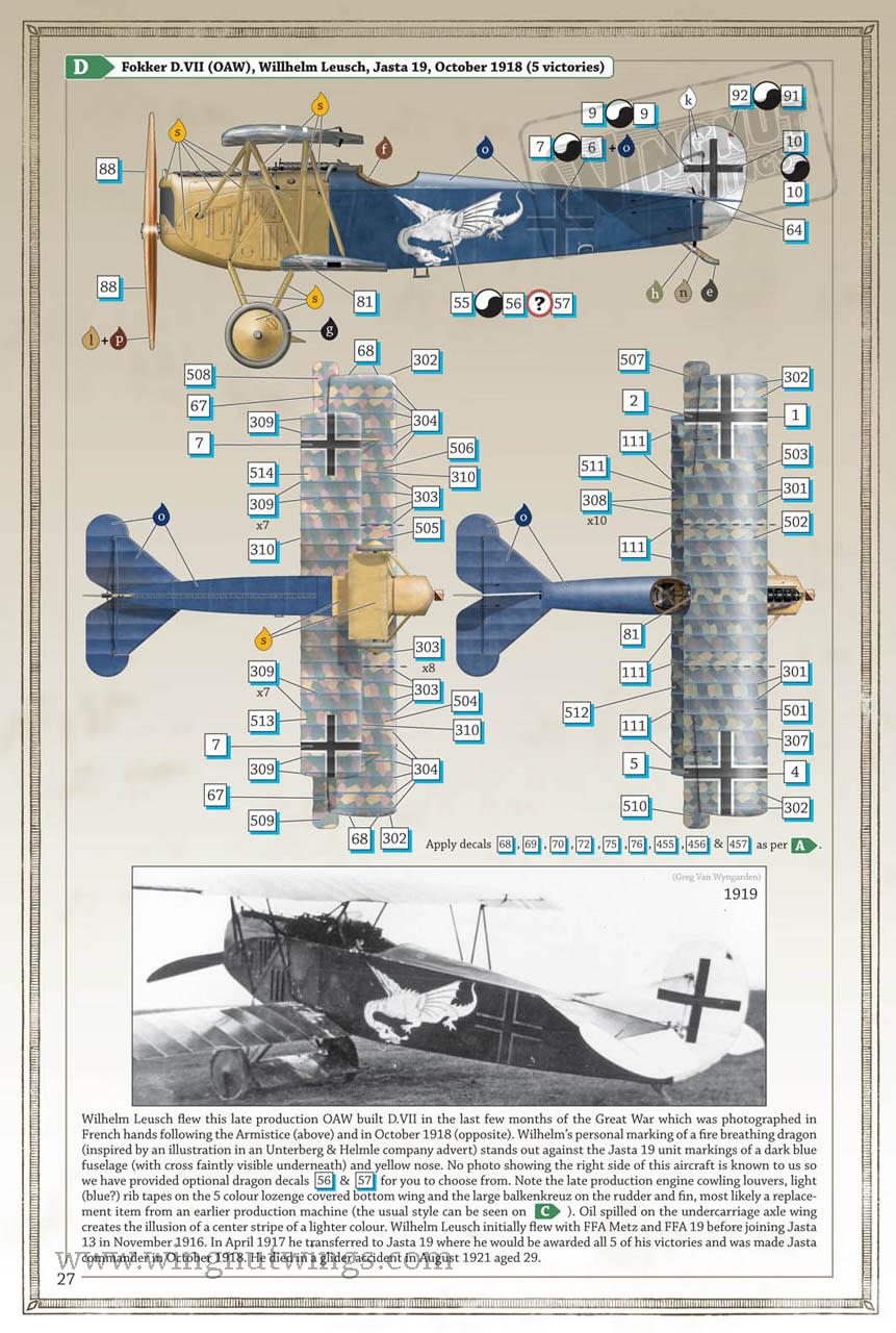

The logo on the rudder in the following picture (decals 91/92) seems to be the Albatros logo?
According to the anthology some OAW built Fokker had it on the rudder.
Hm, I don't have such logos in the kit :(
Found some in a Albatros weekend kit, but I hope they are not to big.
https://www.eduard.com/out/media/gallery/4270/zoom/8438_03.jpg
Re: Fokker D.VII OAW Leusch, Eduard 1/48, Update 23.6.2019 Airscrew
« Reply #66 on: June 24, 2019, 03:47:49 PM »
Outstanding work, Andreas!
Yes, the decals 91,92 are Albatros logos.
