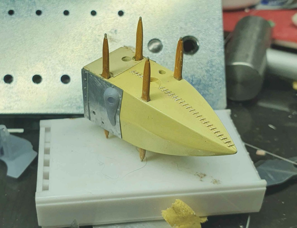

Well... I started my painting before realizing that it would undoubtedly have been necessary to glue the rev counters on the nacelles before painting.
[ /url]

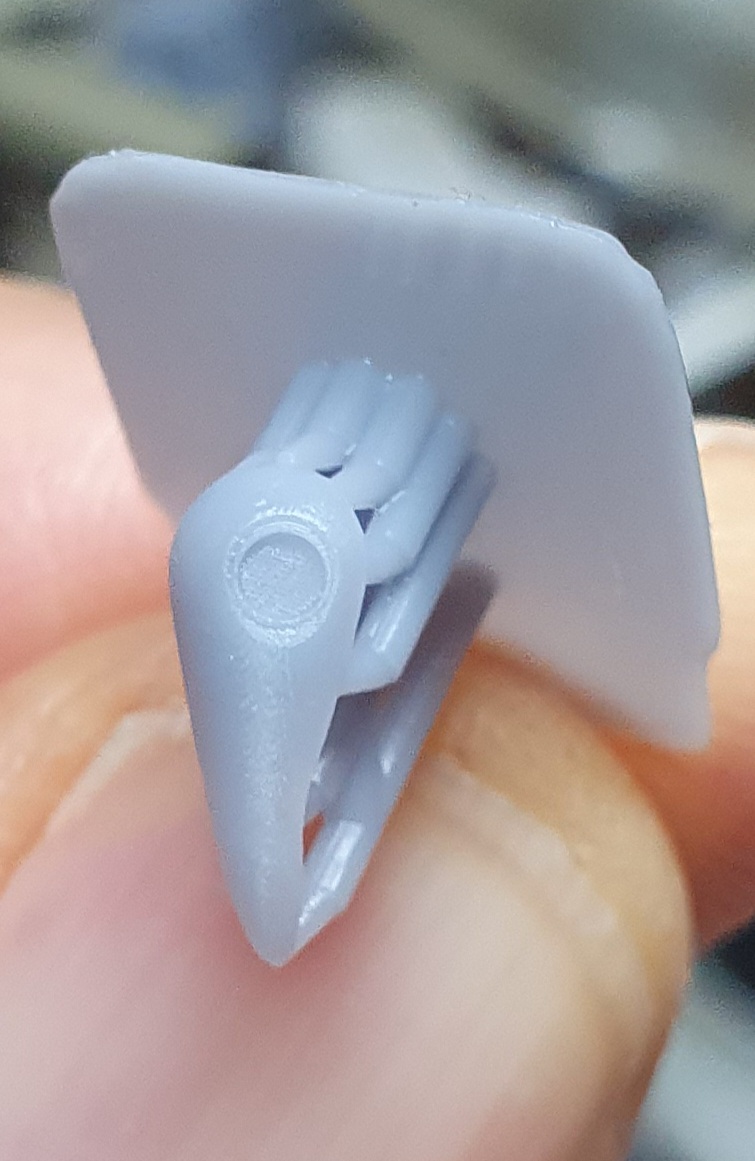

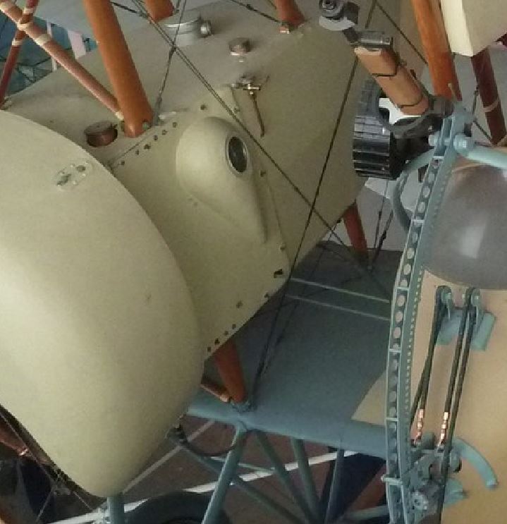

And that's when I realized that the profiling of the Kit's rev counters are not those used on the Poulet G4...
[ /url]

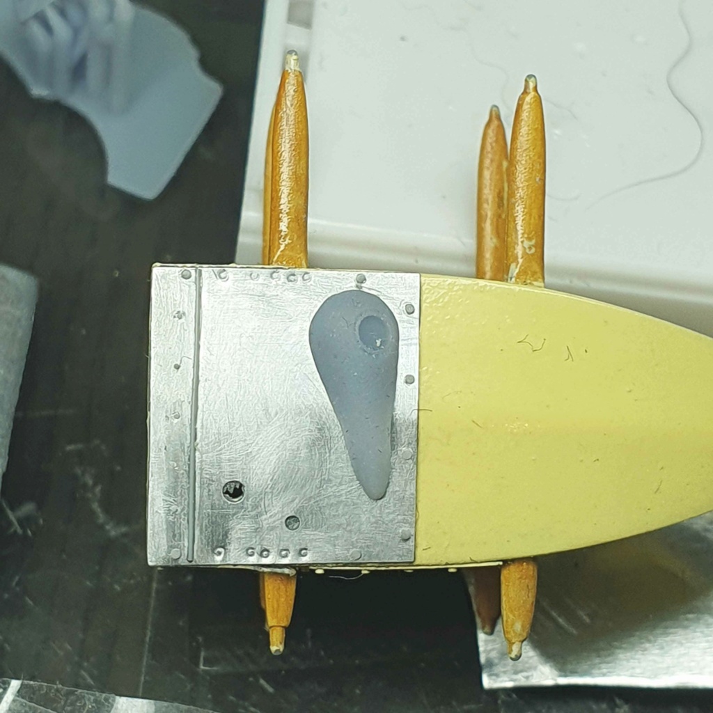

So I turned the laser printer back on... but there is a problem with the nacelle protection plates.
Either they are too short by a good 3 mm, or there are several versions and it is not the right one for my plane.
The rev counter fairing does not reach the mast whereas on the kit it exceeds it.
[ /url]
[ /url]
How do I do it now???
Should I redo the plates? and all the paintings?

I redid the fairings. Difficult to adapt given the shape of the nacelles.

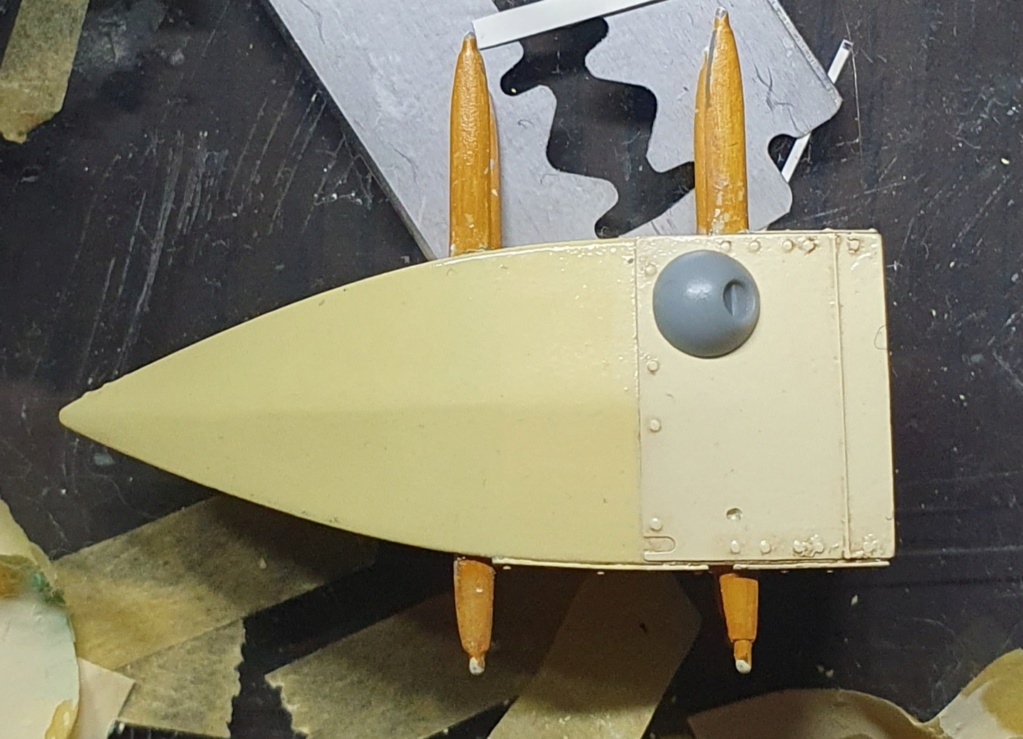

Obviously I glued it the first time on the wrong side.
But it's fixed!
[ /url]
[ /url]
We see the print traces too much despite the surface. To the naked eye it could almost be okay.
So you have to master it again. With water putty (AK) to spread it with a brush and have as little sanding as possible.
