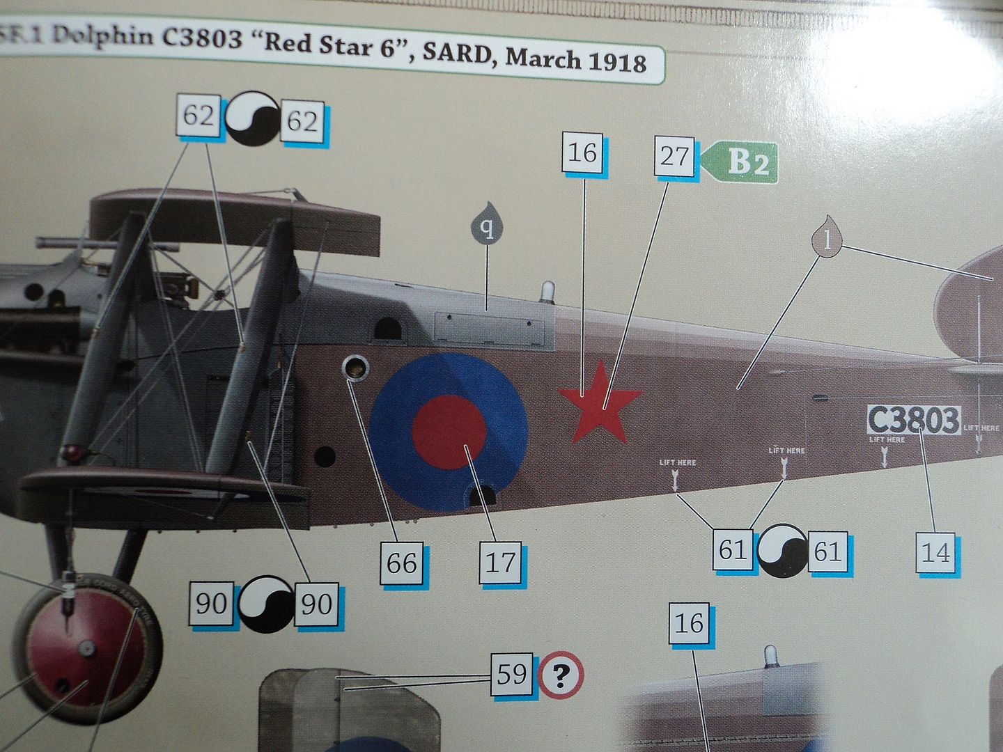

Another area that I couldn't quite figure out was on page 14, the drawing for the SARD "Red Star 6", the "6" was readily apparent.  The drawing doesn't show the "6" on the star, however, in the inset, you can barely make out a "6" in the star in the photo, so I put it in as I had these "6's" but couldn't seem to figure out where they went.
The model with the "6" in the star.
